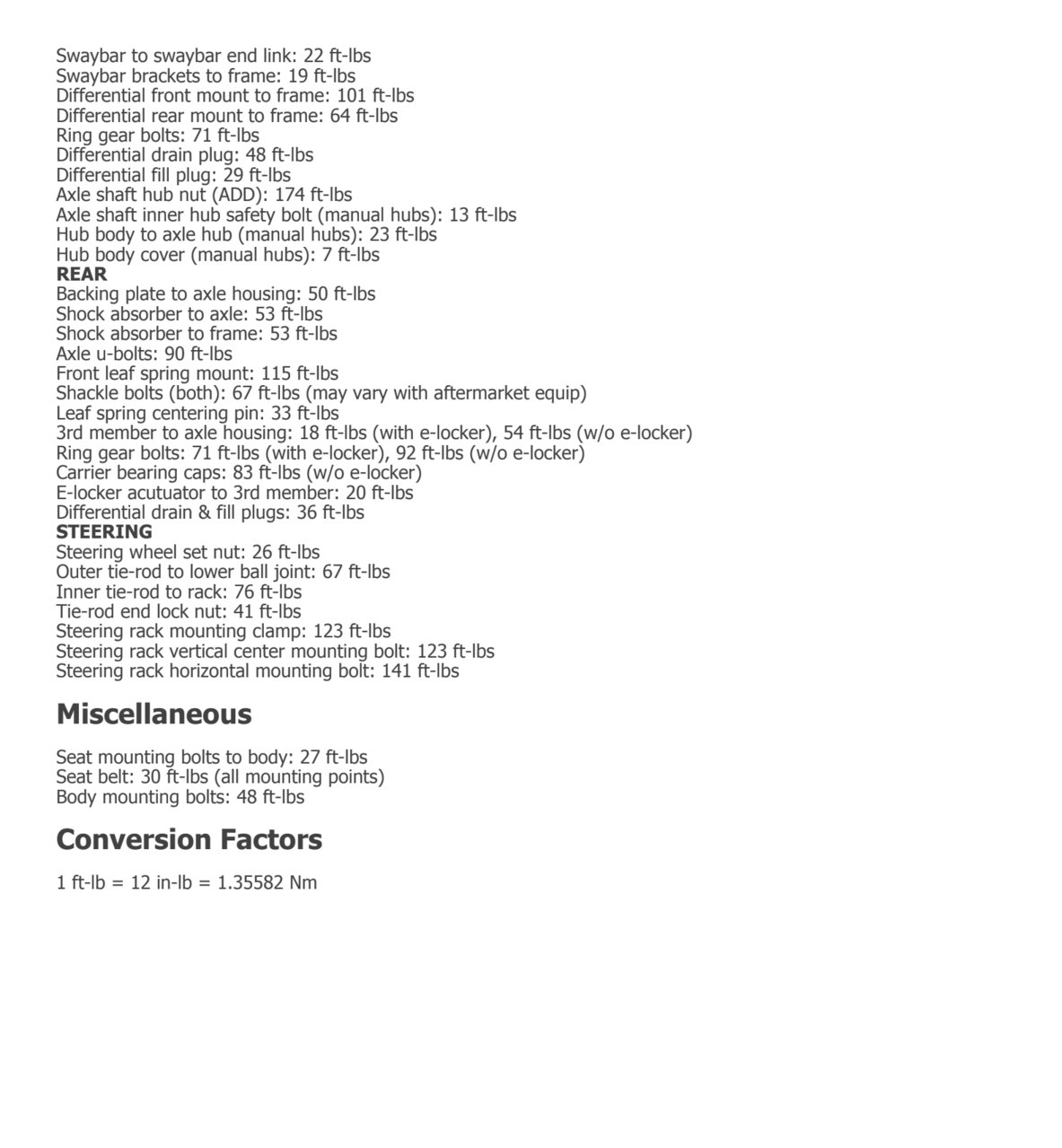

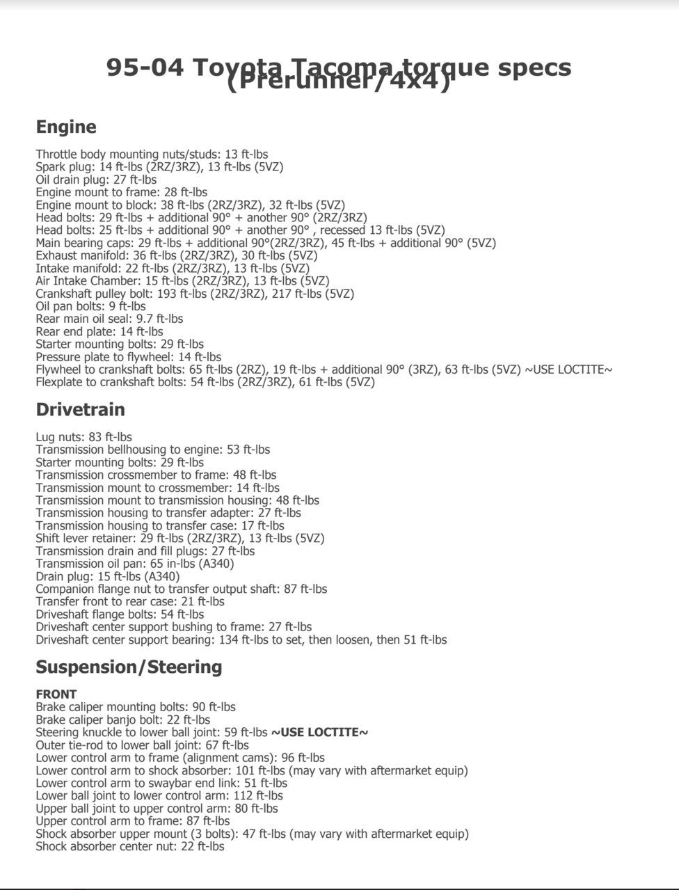

  2. Jun 6, 2019 at 2:15 PM
    eon_blue
    Mar 4, 2016
    #180213
    69,798
    Azusa, CA
    and yes I'd replace the crush washers while you're at it, a lot of people don't and I'd be lying if I said I always do it, but it's good practice and they're cheap.
