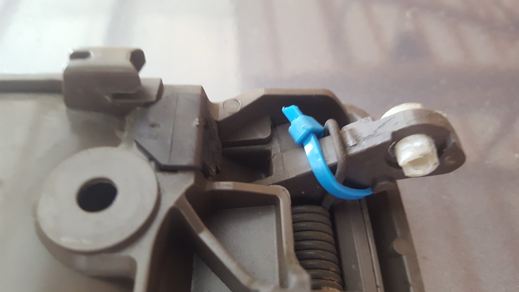

    My D-side inside door handle stopped returning to home position today. Like the spring had come off. Door would still open, just lazy handle
    Took it apart and just wanted to pass along what happened. Return spring is supposed to have a small ramp/retainer feature to keep the spring in place under stress. As you can see, mine has broken off.
    Temp fix until I can get a new handle. I might try heating the spring and melting it into the area of the missing retainer feature, just to see if I can fix it. TBD...
    Between the small part of my ramp feature still there, and the zip tie, seems to be holding for now. Cycled it 15-20 times before re-assembling the door. Should last until I get a replacement or make a better repair.
    Lubed my window regulator arms and the door lock, as well as taped my plastic service hole cover (water barrier) while I was in there. The mastic had gotten pretty dry and weak the plastic was coming loose in several places.

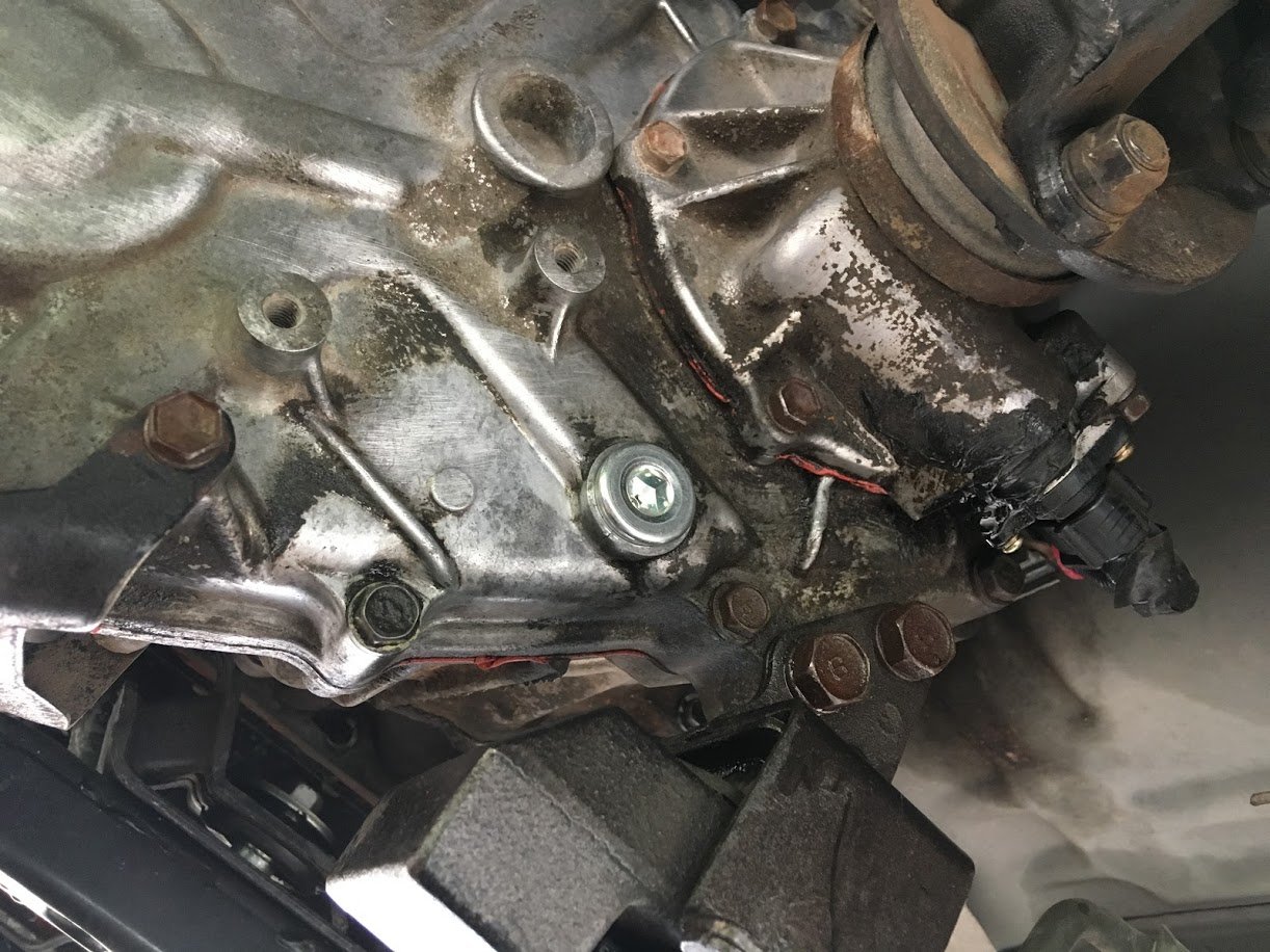

    So I guess you win some and lose some.

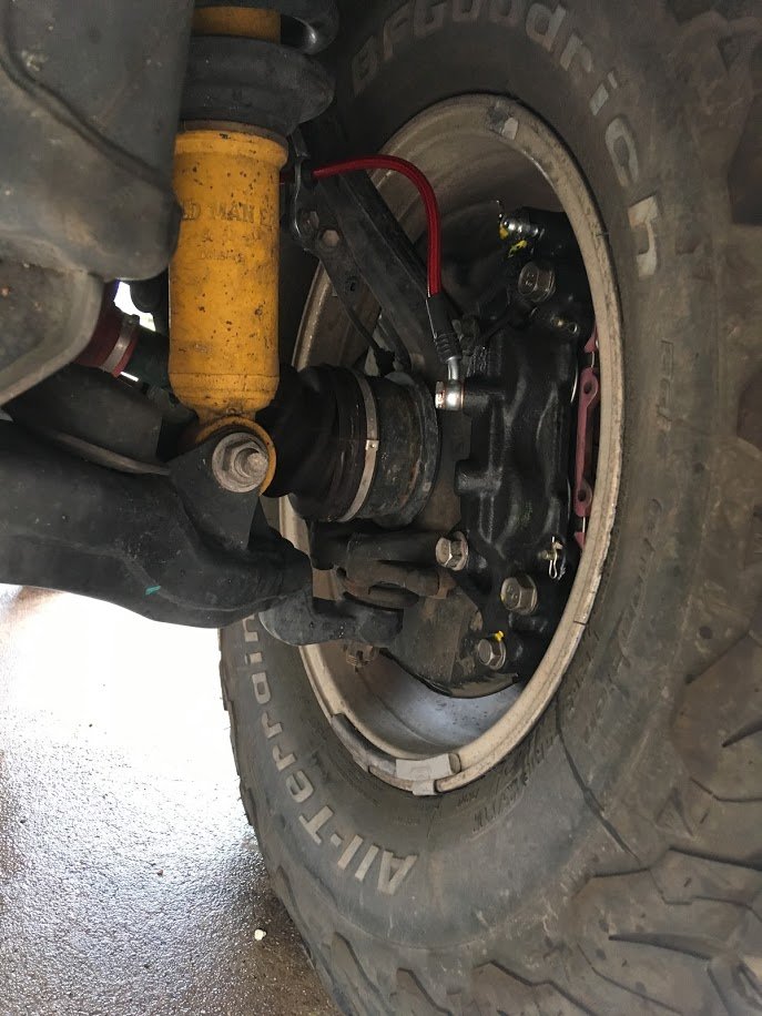

    The good. Did the Tundra brake upgrade, painted my Budbuilt skid plate, and replaced the drain and fill plugs on my transfer case with Marlin Crawler plugs. The fill plug had been torqued down by the Hulk and had become one with it's crush washer no longer forming a seal (unfortunately my aftermarket speed sensor still leaks). I guess I'll look for a VSS or full Tcase at a Yota yard in Denver later this summer.

    Damn Jersey tourists.
    You getting those stainless lines?... so let me know all them parts would ya?

    I’m seriously thinking about it, for sure. Those tabs that Greg pointed me to make it super tempting to route them where they should be instead of right in the way.
