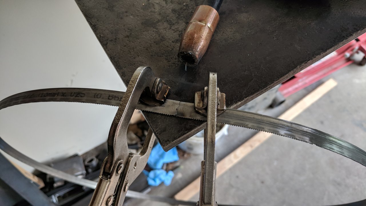

    Nah, I mean, this is how the blade is made in the first place.
    Couple new ones getting delivered today, but I'm impatient. This will hold me over. Cutting away nicely now.
    Reminder to always buy two when you're down to one spare.
