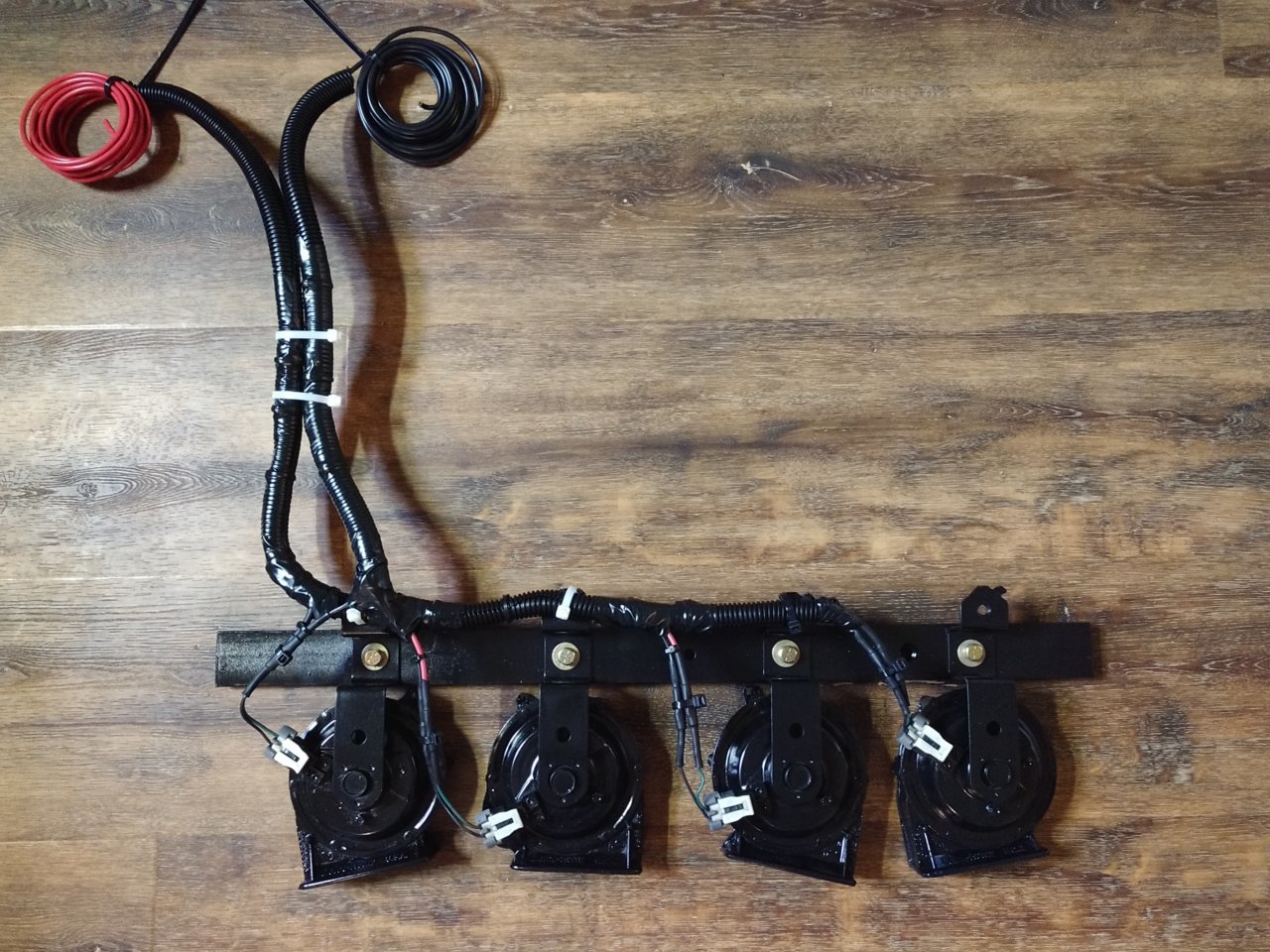

    Hopefully tomorrow I can get these guys installed. IMG_20190612_190652099.jpg
    Im pretty sure I have more time in making and tidying up the wire harness than I do making the bracket and painting the horns. And the fact that I ran out of black zip ties is driving me crazy. Oh well, wont really be seen.

    These are badass! I have a set

    Those aren't the Tyler special though. Mine are AFFD notes, since I couldn't get my C note to work even after attempting to rebuild it, and the local yards had none, since I pulled both sets I could find earlier that week lol.
    Also, if youre contemplating doing this and dont mind a wait, just buy from @BartMaster1234 as this was a bit more time consuming than I thought it would be.

    How loud are yours? Are they directional? Just mounted mine yesterday and I'm not impressed. Maybe it's because I'm in the truck. Maybe I have to be in front of it.

    They aren't supposed to be much louder than a stock horn setup. Its the tone thats different. Gotta remember these were made to be street legal in 50 states.

    I assume you want me to remove your name from the GB since you got a set? Lol
    I don’t know how you wired yours, but if you didn’t run your own relay with direct power from the battery the horns will sound like shit on the stock wiring.
    My harnesses use 14GA wiring, the stock wiring is maybe 22GA. Can’t handle the amperage four of those horns demand.

    Id say their louder than stock, but not by much. They did vibrate my entire workbench when I tested them though lol.

    I forget what the decibel level on four are, but with eight it pushes 120dB. Between shotgun blast and turbine engine.
