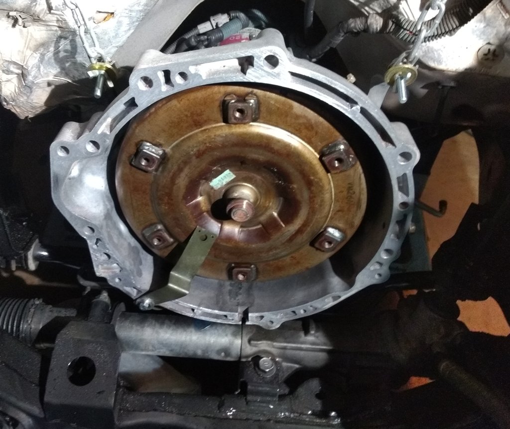

    Tonight I got the torque converter to take roughly 1/2 quart of fluid. It lost about that much when I removed it. I had to carefully feed that torque converter like a baby to get it to take fluid. Once I got it filled with fluid, I was able to mount it and clock it. CLICK CLICK. I did it.
    I'm using a metal bracket to hold the clock position until I get a guide pin installed and have the engine ready to drop. Hopefully, Toyota will get the flywheel bolts that I need to go forward with the engine installation.

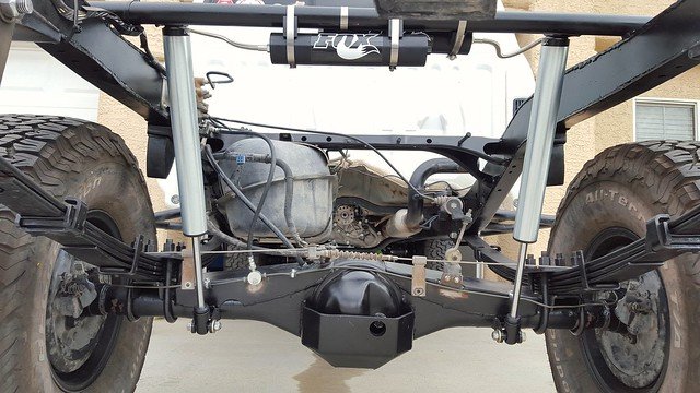

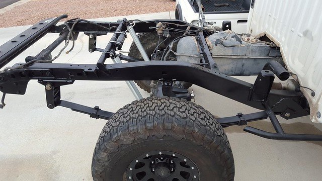

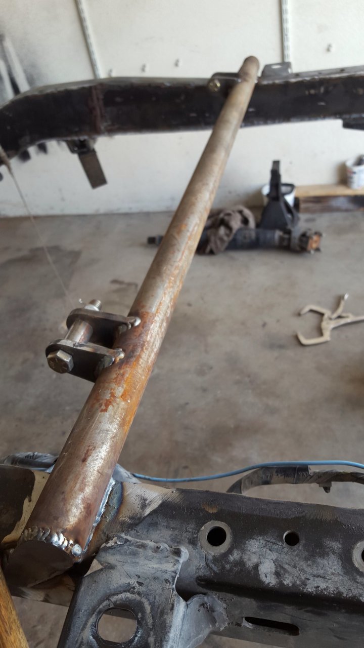

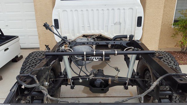

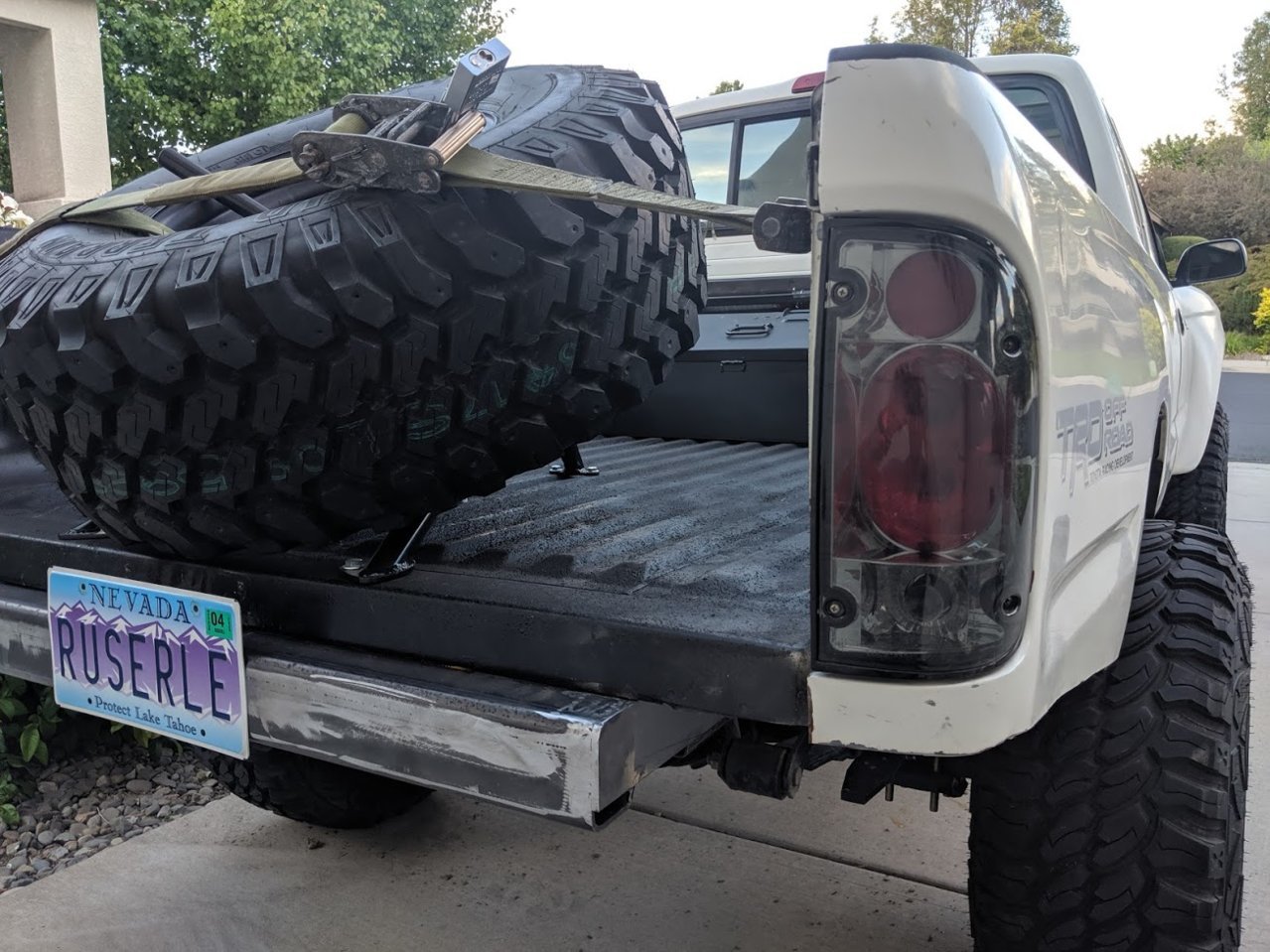

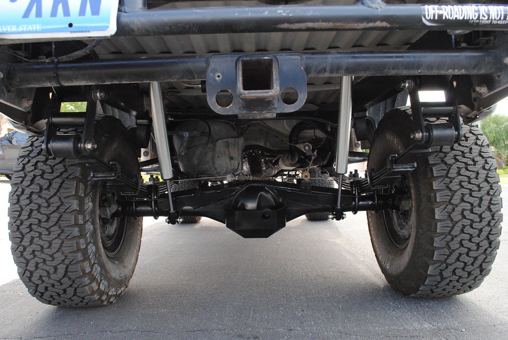

    Pictures from my build. Let me know if you need anymore or have any other questions. My upper mount sat in one of the ridges in the bed. Best way to figure out what shock fits is to set your upper mount and put the axle at full bump and measure for collapsed shock length then put the axle at full drop and measure for extended length then order shocks. That’s the proper way to do it but most wont.
    These are from when I first finished it years ago. Changing it up now to outboard everything

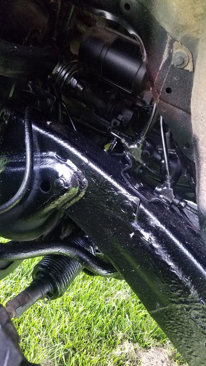

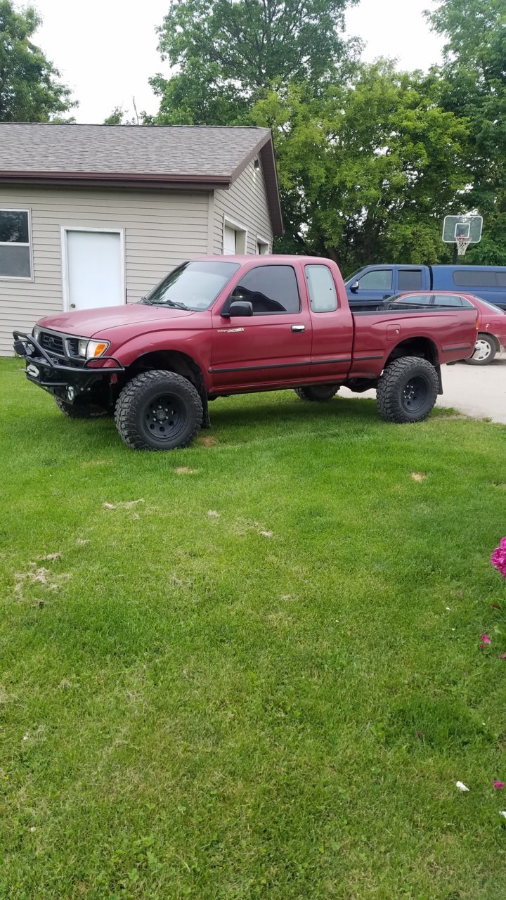

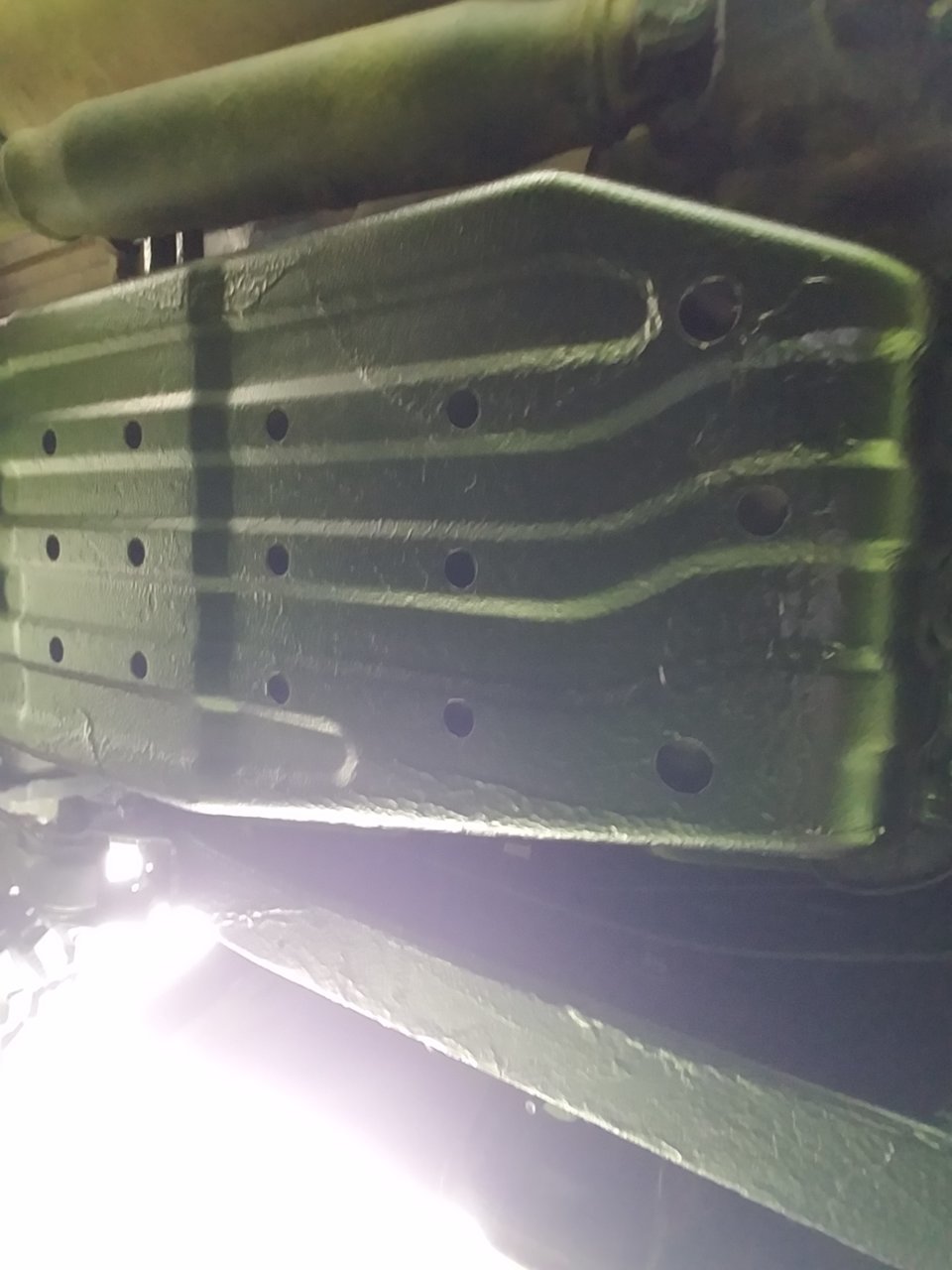

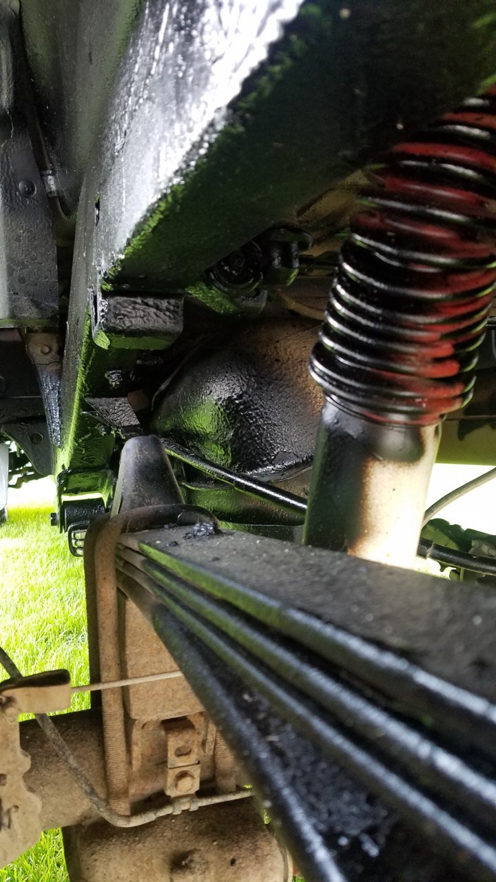

    For her 350k birthday I took her to ziebart and got her rustproofed again. I didnt realize thats supposed to be a yearly thing, but she definitely earned it. 20190612_195830.jpg 20190612_195853.jpg 20190612_195908.jpg
    I dont know if it was done well, don't really know what it should look like.
    I also noticed how much my front end is sagging from all the newly placed weight

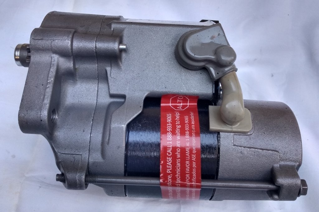

    Fun stuff, I replaced my whole starter a couple of days ago with the duralast factory refurb a couple of days ago for about 90 bucks, greatly recommend it, I've had no issues yet and comes with a lifetime warranty from autozone
