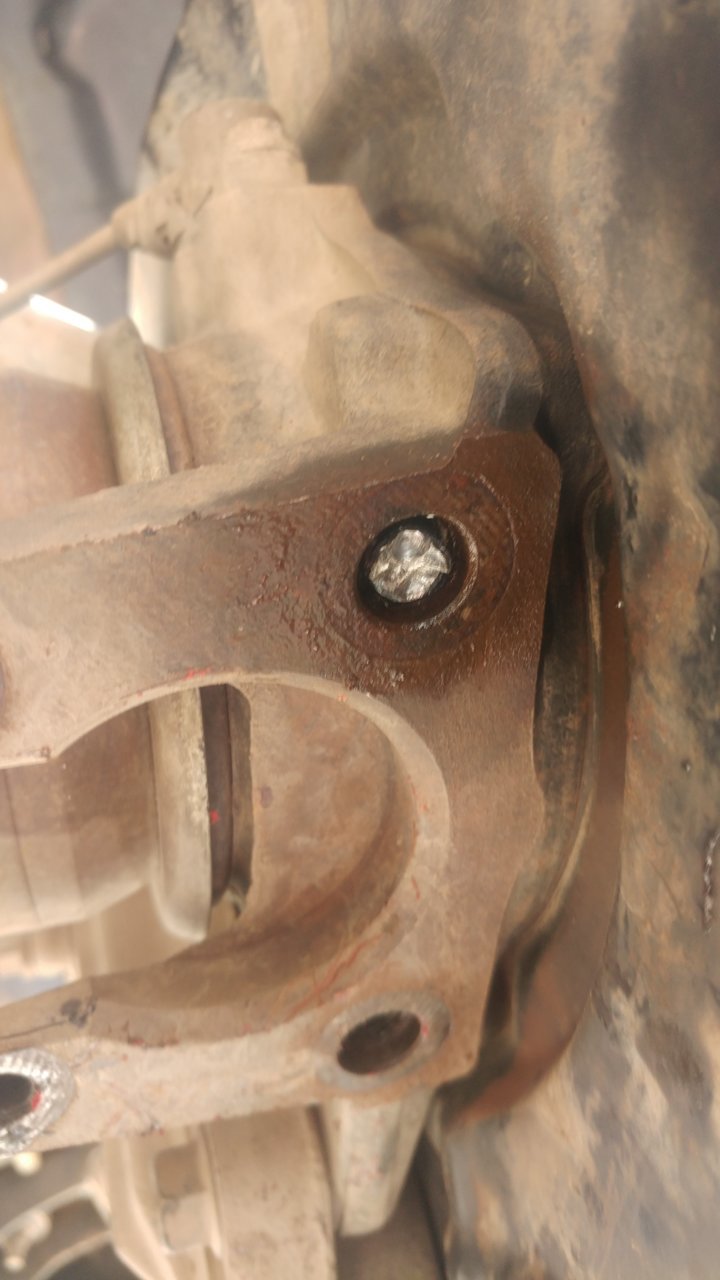

    I'm going to have to remove the new ball joint...the half the bolt is stuck inside the spindle portion, can't get the extractor bit that far up especially in such a tight space. Fuck this lol. Here we go...
  12. Jun 15, 2019 at 3:09 PM
    eon_blue
    Mar 4, 2016
    #180213
    69,533
    Azusa, CA
    There's the fucker...gonna try @Reh5108 method of notching the end of it with my dremel and trying to back it out with a screwdriver

    If you have some high quality metal drill bits you can also start real small and keep stepping up diameter until you can pry that bastard out

    would I need a left handed drill bit? then put a right handed one in and back it out?
    And as luck would have it, I fucked up the boot on the new ball joint getting it off. So now I need another one of those lol. Figures.

    To drill it out, yeah. You'd make a real small diameter hole going into the bolt and increase the diameter until an Ez out or left hand bit can get close to going in and then go for it. With Ez out get your hole drilled into that bolt then take Ez out and hammer it good into the hole and then use a ratchet or T handle thing to turn Ez out into the broken bolt and as you're driving it into bolt by going lefty loosy the bolt eventually gives and backs off... As long as it's not seized too bad, not cross threaded right?

    Should come out by hand if you take the balljoint off. Or drill and easy out.

    Was your old boot bad?
    Reverse drill bit would be best. Often times the bit will catch and back it out. Not necessary though.

    Oh. It broke like that. Should still
    Come out kinda easy with a drill and easy out

    A tap to clean out the threads before reinstalling might be a good idea. Looks like some corrosion in there.
