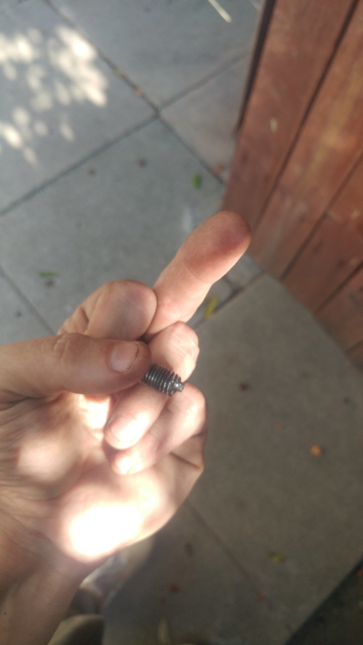

    Yeah the old boot was torn too. I don't trust that I didn't shove some dirt into the new one as well with the pickle fork, just gonna bite the bullet and get another for peace of mind. Chalk it up to a lesson learned...don't implicitly trust new OEM bolts I guess lol.
    Main concern is getting this broken bolt out now. Can't install a new lbj until i do

    Got you, you fuckin stupid bolt

    What method worked?

    Needle nose pliers lol. Just enough room around the bolt to grab it with them and turn

    How'd it break?

    No idea. It was a brand new oem LBJ bolt I was torqueing to 59 ftlbs and it snapped

    Now that I think about it...that same bolt that was in there before had a double washer on it. The 2 LBJ bolts closest to the wheel both had double washers, and the new bolts only came with one. So I think what happened was, without that second washer on there it was slightly too long and when I torqued it in all the way in snapped because it was too far into the spindle.
    When I put the new LBJ in I put that 2nd washer on those two bolts like they were before, and it went smoothly.

    good reminder to KISS....keep it simple stupid haha
    I did try doing that at first but it wouldn't budge, I think after I fucked around with it some with the drill it broke it loose a little and then I was able to use the pliers.

    If I remember correctly the bolt holes on the lbj are all the way thru, if so you probably have corrosion in there. Chase those threads with a tap.

    That and hand thread until snug... Then torque
    Weird.. I don't remember two washers... I wonder if it was a 'PO' thing.
