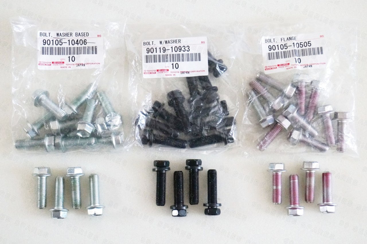

    Your bolts came with double washers on them? Stacking washers of the same type is not normal and in some industries prohibited. There's no reason for it other than for taking up slack as a work around. Stacked washers can act as a spring & be unreliable. Washers aren't normally hardened, not sure if the captive ones on Toyota bolts are, I never checked. But ok, I still don't believe that stacked washers is stock.
    These are the different LBJ bolts. No double washers.

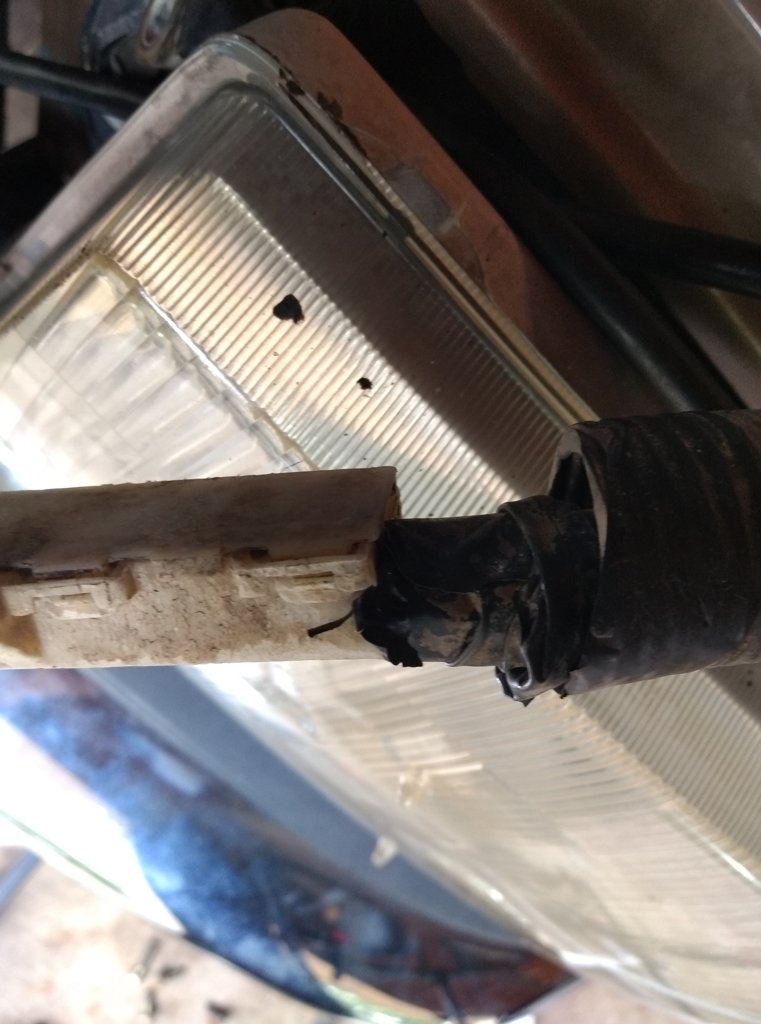

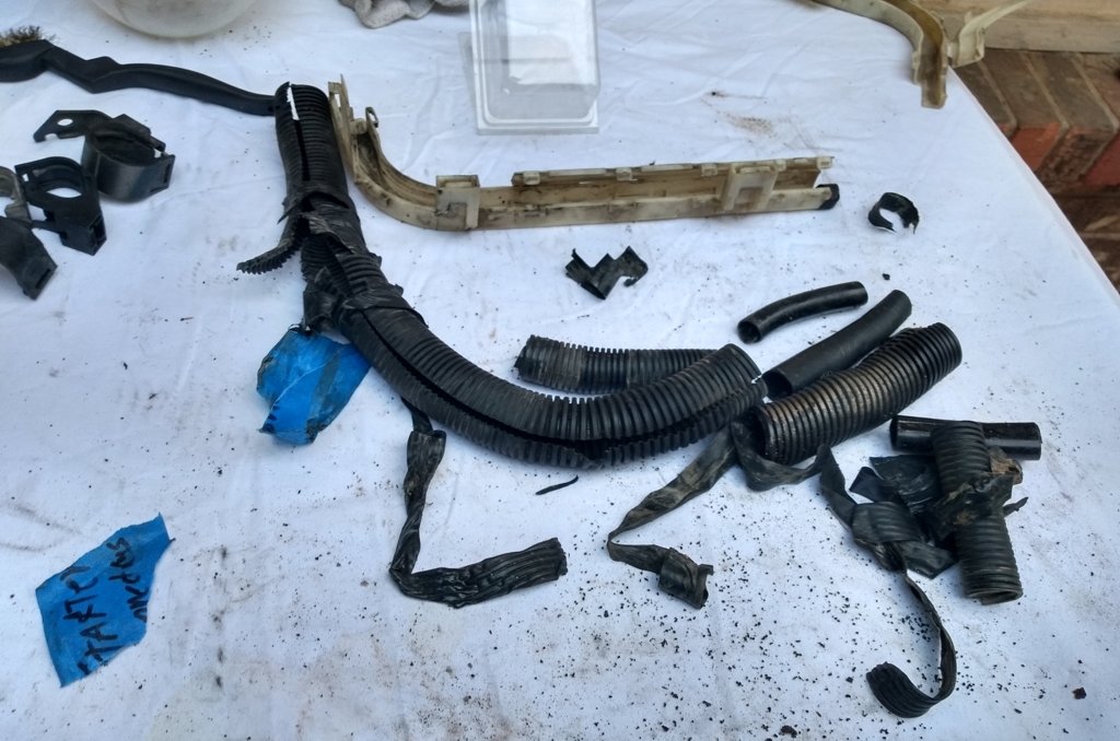

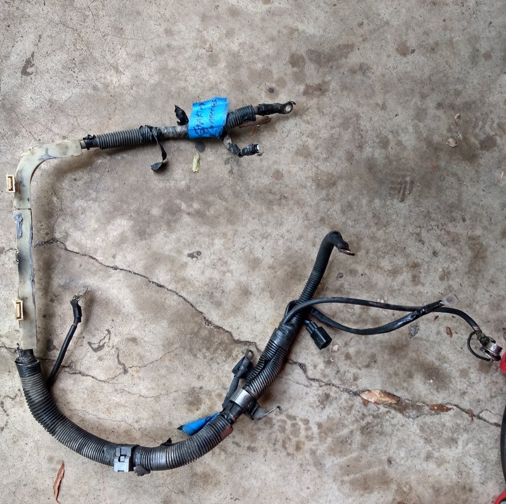

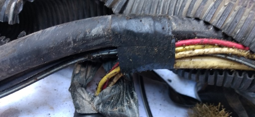

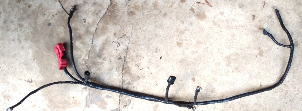

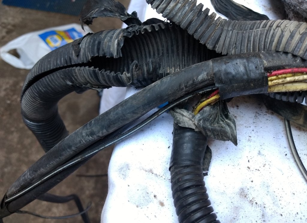

    Pulled the power wiring harness off the truck to get a better look and to clean and repair any issues before hooking it up to the starter and alternator. I'm glad I did. I had a few problems would have come back to bite if left unaddressed.
    The old plastic cable tray that runs below the crankshaft pulley had become brittle. Also, it was full of dirt and engine grime. I suspected it would bite into one of the wires and cause problems.
    Picture of the old harness before I took it apart for inspection, cleaning, and to be wrapped in F4 Silicone Tape.
    The old protective conduit has open gaps that let in oil and road grit.
    Electrical system gremlins waiting to happen.
    Took a while to get the old harness apart and cleaned up. I used Isopropyl alcohol at 90% for the cleanup.
    Remnants from the harness cleanup.
    Once the harness was cleaned up, I wrapped it with one layer of F4 Silicone tape. This first wrap forms an airtight, watertight, and grit proof layer over the old cables. It's like being inside a giant heat shrink.
    Then I put on a new layer of flameproof automotive electrical conduit and wrapped that with F4 silicone tape.
    I will use new insulated wire loom mounting brackets to mount this. Some of the old mounts will still work.
    Tomorrow I will clean up and rewrap the injector and upper-level wiring harness.

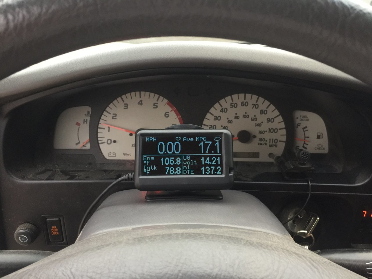

    I’m pretty happy with mine on the column.
  14. Jun 15, 2019 at 11:02 PM
    BartMaster1234
    Aug 21, 2016
    #195197
    45,868
    Tyler
    Pittsburgh, Pennsylvania
    Flux Capacitor
    Do you ever feel like it gets in the way? I have my boost and AFR Gauges on port and starboard of the column cover respectively.
