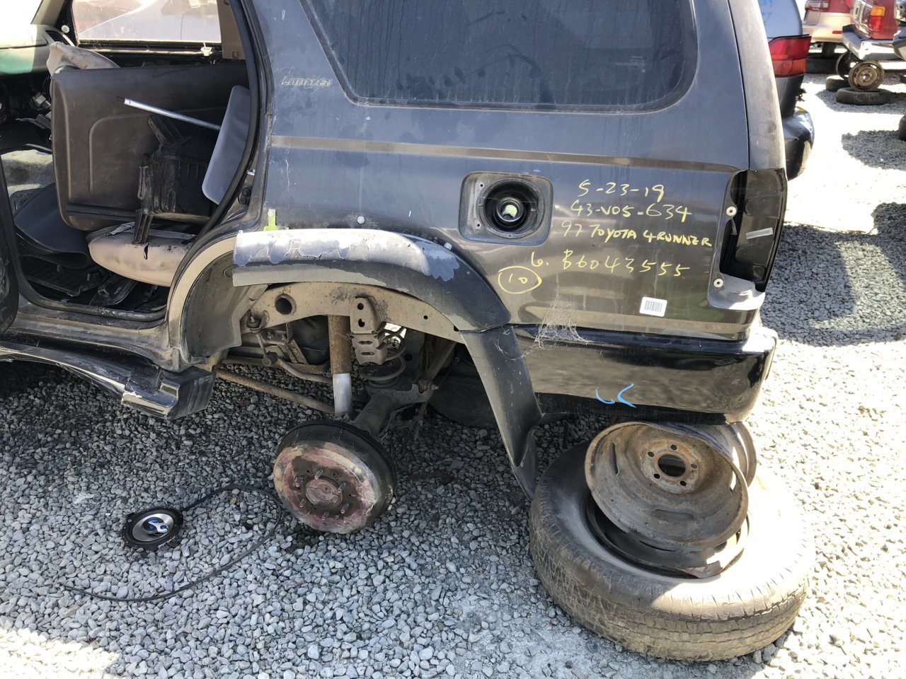

    Yes, I will be swapping in an e-locker housing. So any ABS axle shaft will work regardless if it had an e-locker or not?
    I’m looking at these axles shafts from a 1997 4Runner. NON E-Locked axle, however it is ABS equipped.

    That’s exactly what I wanted to know, thanks. I’ll go and buy those 4Runner axle shafts then.
