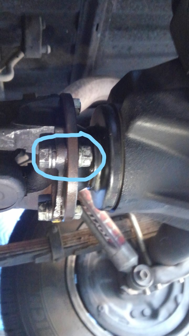

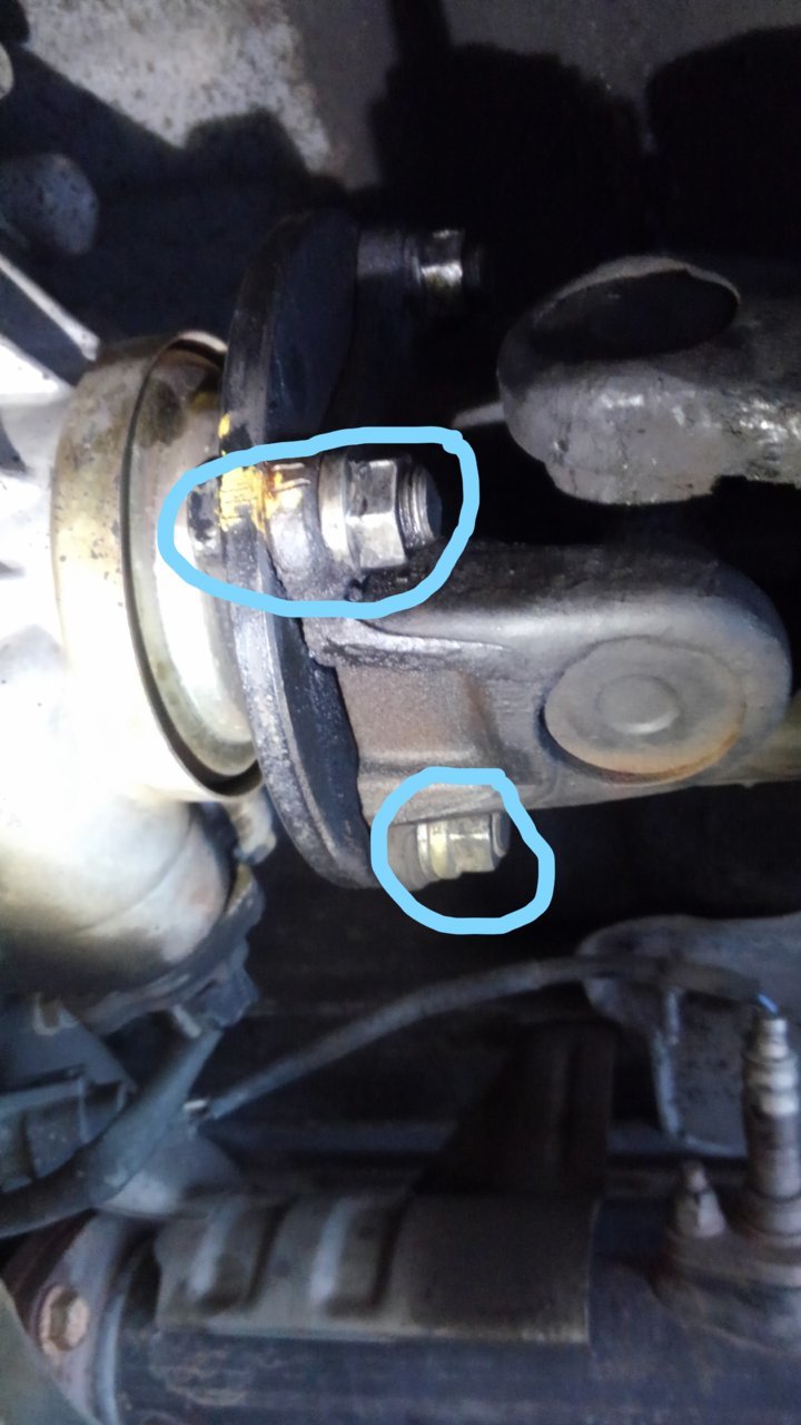

    I think I will go buy a quality impact wrench then. The clearance is so tight on the driveline I doubt a beefy impact socket would fit in this situation. I could barely fit a standard socket in there.

    I don't recall if Ive ever used it on a driveshaft, but you could try using a universal as well

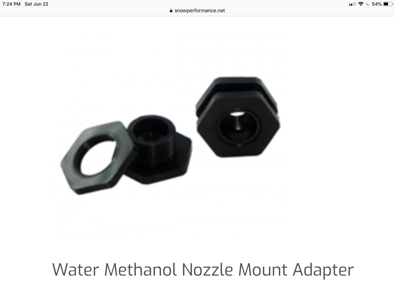

    I have the plastic KN tube.
    Snow makes an adapter that just threads on after you cut the correct size hole and used the new low profile right angle adapter.
    Then the spray nozzle fits down inside it

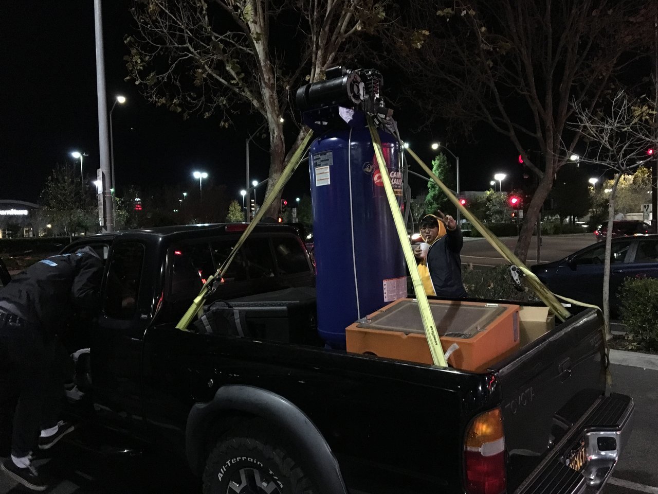

    My first compressor was an 8 Gallon one from Harbor Freight. Any decent 5 gallon air compressor can run an impact, just for not very long. I don't think an air compressor made for inflating tires can run an impact, does it have the pneumatic connector on it for hoses and such?
    I picked up this big chonking 60 gallon compressor because sandblasters are thirsty sonfabitches.

    That's airtight? I pressure tested my tube after I welded the bung in.

    Yes, I used a sealer when I tightened it down.

    Use a 6 point socket if you're not already. Harbor freight sells a telescoping ratchet that is great for the extra leverage. Don't worry about turning the gearbox. The motor does that when you drive.
