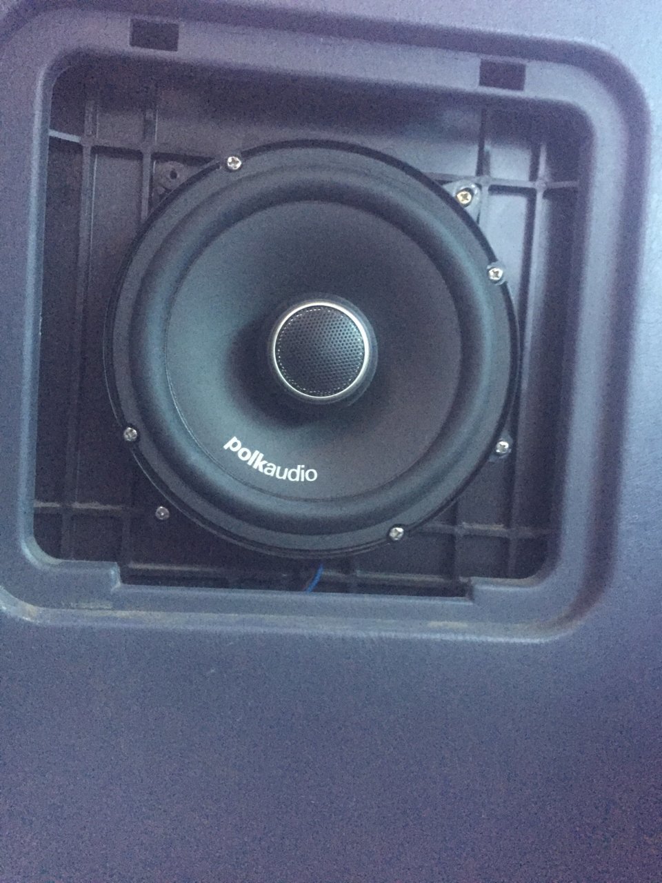

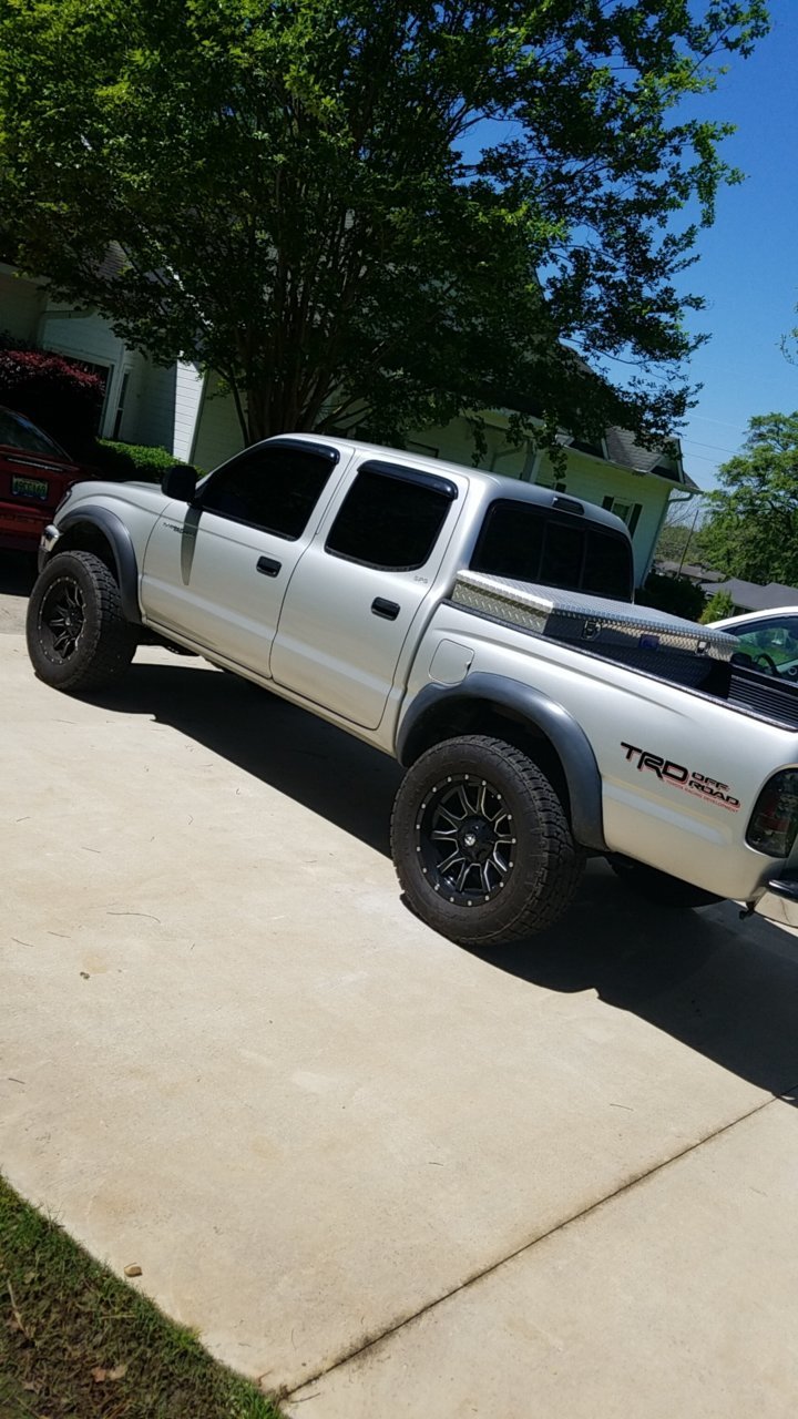

    Some and some more

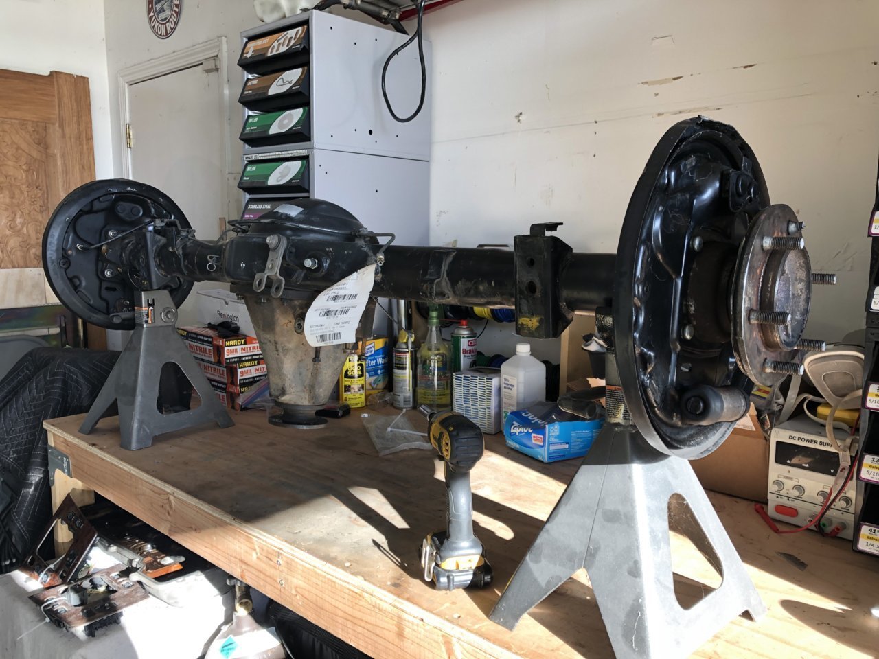

    For those wondering, you can use 8.4" ABS axles from a non e-locker axle housing on a 8.0" e-locked axle housing. I got these axle shafts from a 1999 4Runner Limited, and I am running them on a 2000 Tacoma axle housing.
    Whether the non e-locked axle shafts are shorter than the e-locked axle shafts we will find out later. I am waiting on measurements from an e-locked axle shaft. I was told the 8.4" shafts are a tad shorter than the 8.0" axle shafts.
    However everything spins just fine. Just need to press in some new wheel studs, two of them were broke off clean and one of them was bent.

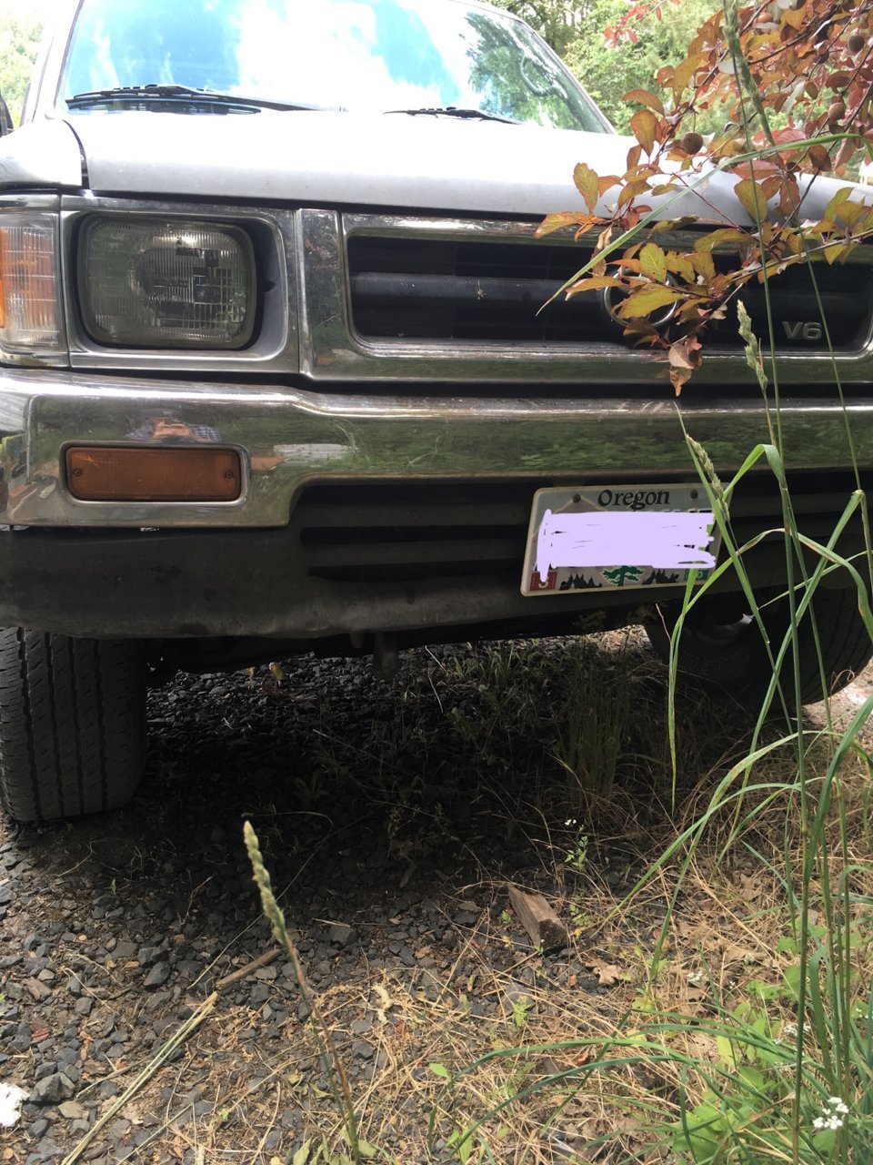

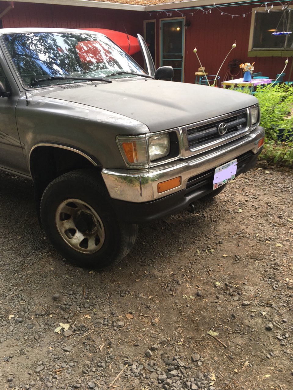

    Replaced my front bumper and tried to figure out why the front wheels "clunk" when I turn.
    I know my truck's not a 1st gen. If there's a thread for older trucks I haven't found it yet.IMG_6017.jpgIMG_6040.jpg

    The steering stops on those IFS setups had little plastic caps on them, eventually they break down and fall off and the steering stop binds at full lock turns. If that's what is causing your clunk (it's pretty common on that era of trucks) put a little dab of grease on the steering stop and it should stop it. Just have to regrease it when you change the oil or about that often.

    wait a sec.. i can measure the elocker shafts... i have mine out right now.

    Oh I love you, that would be great.

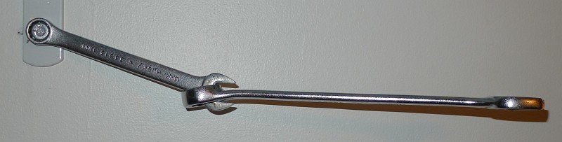

    I keep about a 2 1/2 foot piece of 1 1/2 PVC pipe to slip over wrenches and ratchets. "cheater bar"!

    Pvc? I'd break that shit in a second haha but yes, another cool option is to us the handle from the jack, I do that sometimes.

    LOL, I have had the same old piece of plastic pipe for probably 20 years.
