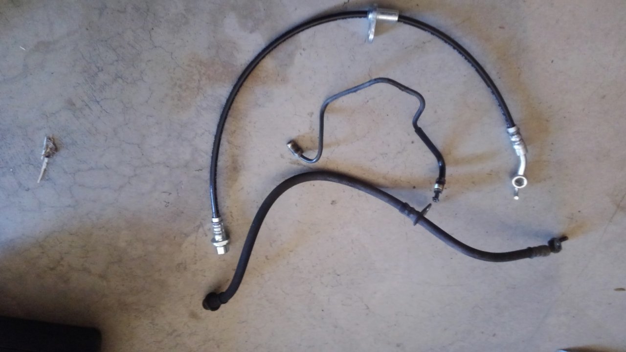

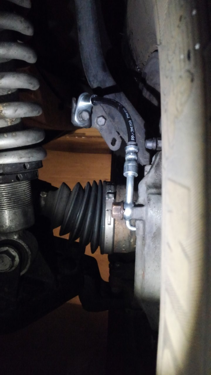

  4. Jun 26, 2019 at 2:04 PM
    Kiloyard
    Kiloyard Road Warrior
    Oct 28, 2017
    #234330
    1,052
    John
    Phoenix, AZ
    1999 3.4L SR5 4X4 410K miles
    Toytec Boss/Eibach Coils & Deaver J59's
    Flexible Brake Line Swap - Preventative Maintenance
    I finally got around to swapping the three flexible brake lines on my truck with longer steel braided lines more than a year after buying the parts from LC Engineering. Thanks to @1997tacomav6 for the recommendation on the lines. Thanks to @Speedytech7 for showing me how it's done (last year, when I watched him do this to his truck). Took me twice as long as expected, about 4.5 hours. I also replaced the short hardline next to the wheel well because the compression fitting on the old one was a bit rounded.
    A big chunk of the project time was spent trying to bleed the brake lines by myself with a MityVac. Eventually got it done, but it takes a lot of hand pumping! I decided to empty the reservoir before starting and let the system get air in it instead of trying to keep it full, so that might be why it took so long to bleed. I saved $3 in brake fluid though! If I did this again, I'd go with the conventional wisdom and keep the reservoir full during the swap. Another item crossed off my long list - I'm on a roll!
    ireymon, jammer, SwampYota and 3 others like this.
