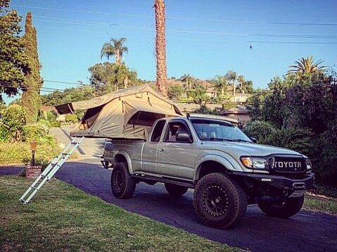

    F06F6685-7D1B-4F03-9DD6-131277607FAF.jpg Installed my RTT today :)
