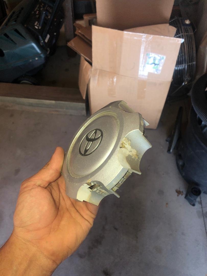

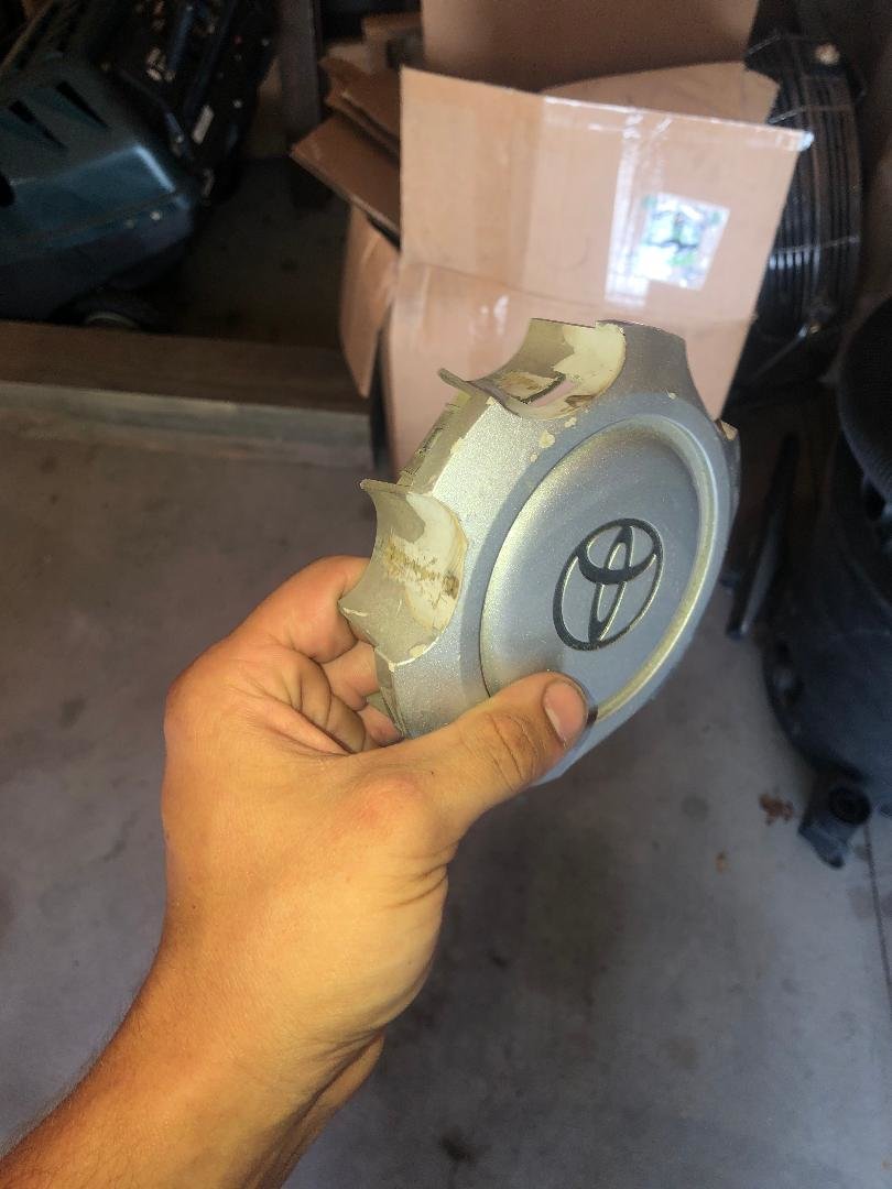

    going to the paint store to find some 'safe' stripper to use to take the coating off of these center caps and paint it black (emblem color is still TBD)
    or should i try to smooth the chipped parts off (salvaged caps) and paint black over the coating :notsure:
    edit: sandpaper is best option, no stripper(s)

    No need to strip them just get some sand paper, sand smooth and paint. You dont even have to sand the paint off just sand to get a smooth surface

    Agreed. You won't find a paint stripper that won't melt the plastic. Just sand them or do as @turbodb did and media blast them. Sanding would probably be your best bet tho.

    thanks! still gonna look for some all-weather quality paint
    what do you think for the emblem? red or silver/coal to match the powdercoated wheels?

    this looks good, does the entire finish on these caps have to be removed or just loose pieces?

    the pro paint shop told me most all stripping materials for pros (mostly for wood & varnish,etc) has been outlawed by the government
    picked up some 150 grit paper to get crackin onit in spare time
    these caps are going to be most likely used on the winter wheels/tires so smoothness is not paramount, just gotta find the proper paint that will last longer the better
