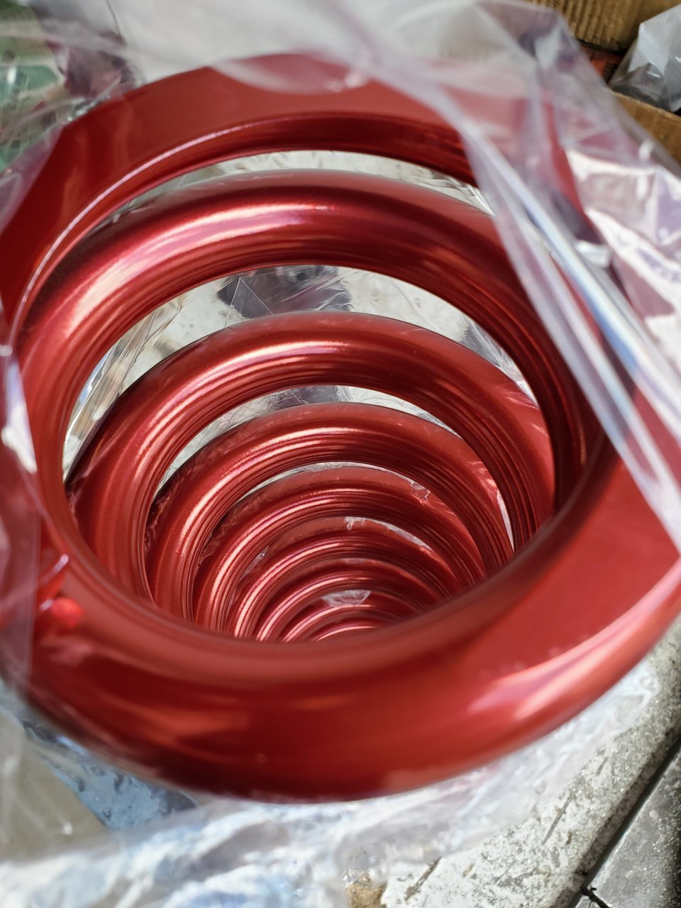

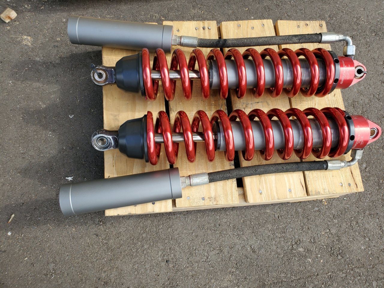

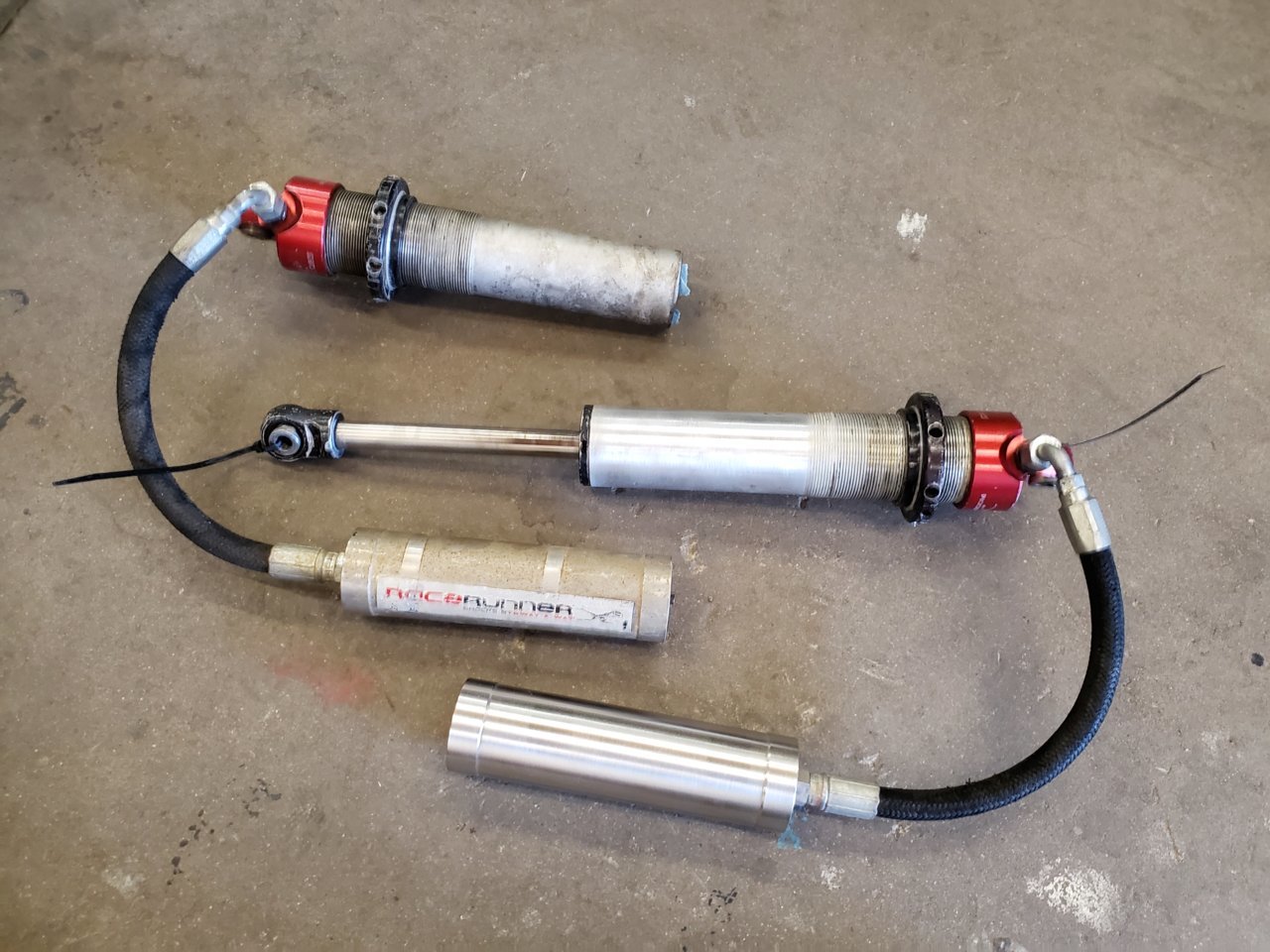

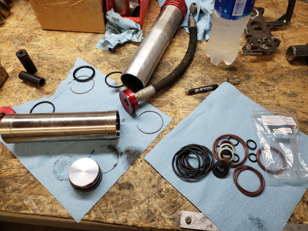

    Today I finished a shock rebuild for my truck. @Dalandser found these used Saw shocks on Craigslist and let me know about them. Luckily I had a friend driving to that part of Cali, so he was able to snag them for me.
    They definitely needed a rebuild, but that was advertised. Once I got into them, things got weird. I needed to revalve them to play nice with my Saw bypass shocks, but the shim sizes were the wrong I.D. compared to what was on the chart. After some deep thought and asking around, it turned out these Saw's had Icon shafts and seal heads! Wtf!
    So I ordered Saw seals off Ebay (43 bucks and showed up quick) and picked up Icon seal kit and new shim stacks from Sdhq locally. I'm definitely a function before form kinda guy, but the springs that came with the shocks looked terrible. I cracked my piggy bank and sent them off to get a fresh red powder coat, they came out great!
    I cleaned and scuffed every bit of the shocks, painted the resivours and coil over body (below the threads) with silver Steel-it paint. The collars were beat, but a little flap disc and a chamfer bit perked them right up. Painted the collars and seats with black Steel-it. After that it was simply a matter of swapping out the seals, o-rings, and valves, then reassembly.
    Next will be install and retune the bypass to suit.

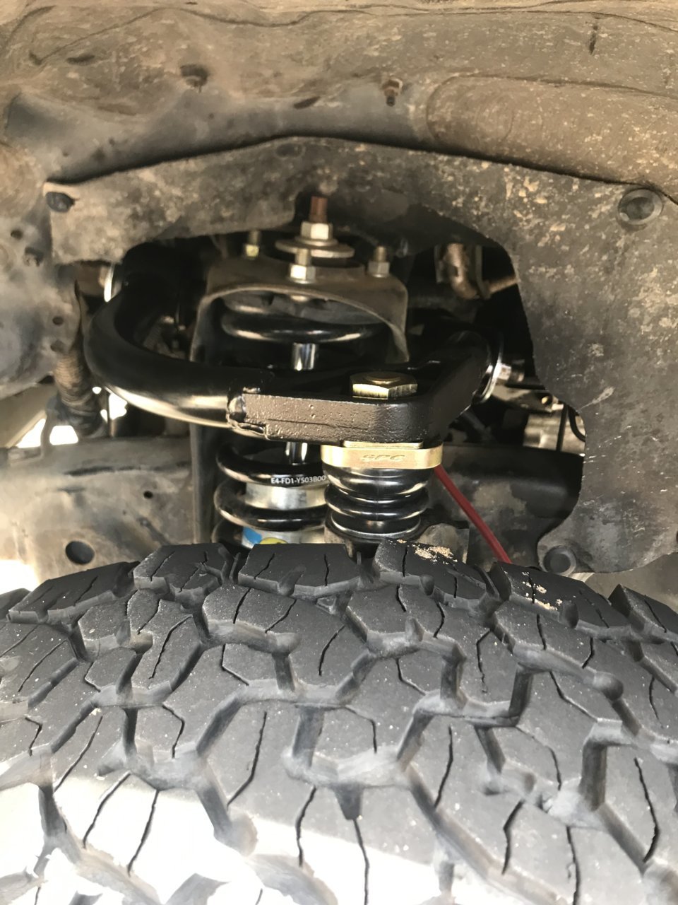

    Got my SPC uca’s installed and had the alignment done today. It drives so much better !
