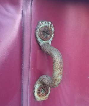

    Because this looks like ass and it would be nice to know if someone has found a good fix. Bedliner was a great suggestion but it's not for me because I want them metal colored. Stainless bolts also a good suggestion, thanks for the size!

    aluminum apparently is not the best material for the rope hooks
    out of curiosity i took my flashlight (with magnetic tip) out and inspected these hooks, and they are magnetic! I had no clue! had always thought they were non-corrosive material because I had never seen them get weathered back under there
    checked my old OEM exhaust that i have not disposed of yet and that was magnetic!
    took the magnet to my new aftermarket exhaust and bam NO magnetic!
    can these rope hooks be made (or available out there already) of material the exhaust is made of? or the alloy wheels material (those are non-magnetic as well)
    i just want some badass and durable rope hooks!
    now that my hooks will be exposed from the bedliner change i would prefer they not look like ass either!
    i will ask the LineX shop guy if he knows of any corrosive resistant rope hooks, since his specialty is truck beds (and all trucks probably have rope hooks) he would be the one to know!

    Is your exhaust stainless? If it's high in nickel then it is less magnetic if at all.

    its the borla exhaust aircraft grade stainless steel

    304 is austenitic and not very magnetic.

    and therefre highly resistant to corrosion?

    Not as good as T-316 but good.

    you have a topper shell to better cover your hooks from the elements?

    Yes. But my 92's look like that pic above. They get used so it doesnt bother me in the slightest. The ones in my dads 08 just got black rattle canned since theyre not used often.
