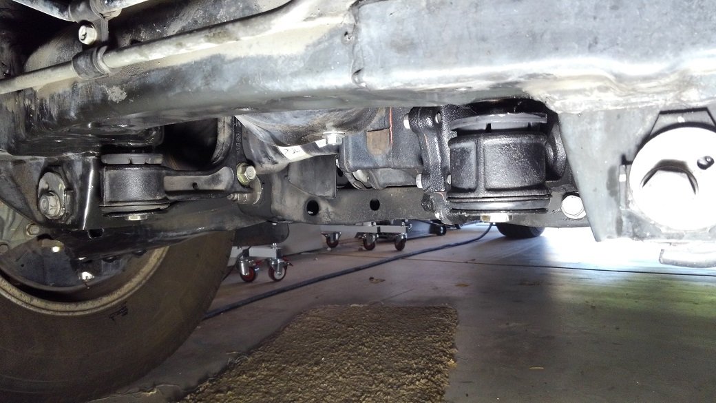

    Today I changed the engine oil, washed the truck, pressure washed the engine bay, vacuumed the interior and detailed the exterior to get all the trim looking good. While I had the skid plate off I decided to tackle a project I've been meaning to do for a while: replace the front differential support bushings. Thanks to @Plastics Guy for the custom bushing kit that he makes. I'd never used a gas torch before, so I went ahead and watched a safety video before diving in. He has good step-by-step instructions on his site for the procedure, so I won't repeat it here.

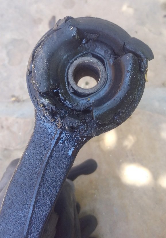

    Here's the Left side bushing, it's falling apart due to oil contamination from sloppy oil changes over the years:

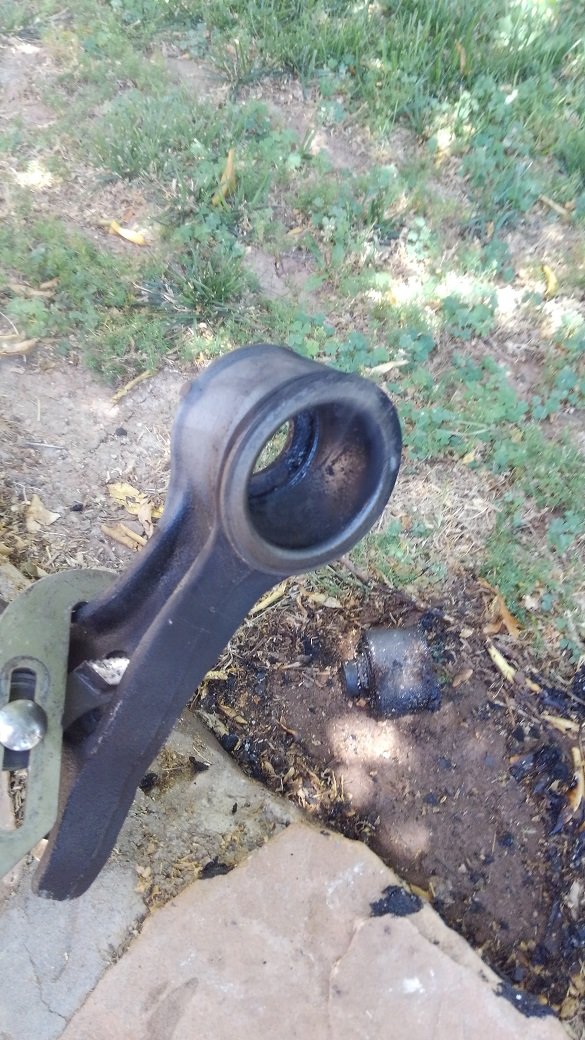

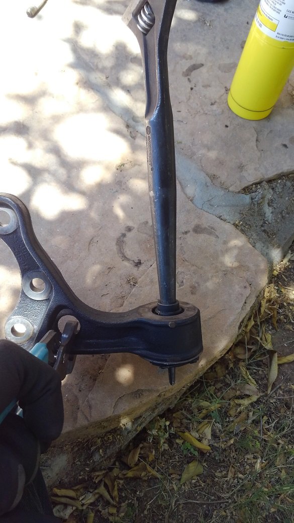

    Here's the setup I used to get the old bushing out. I used a SPUD wrench to push the bushing out once it was toasty. Sorry I didn't have anyone to take a picture of the action, but basically a couple minutes of heating around the bushing causes the rubber to melt (and catch on fire), then I poked it with the SPUD wrench and it fell out with almost no effort. Used a nearby garden hose to put out the flaming rubber.

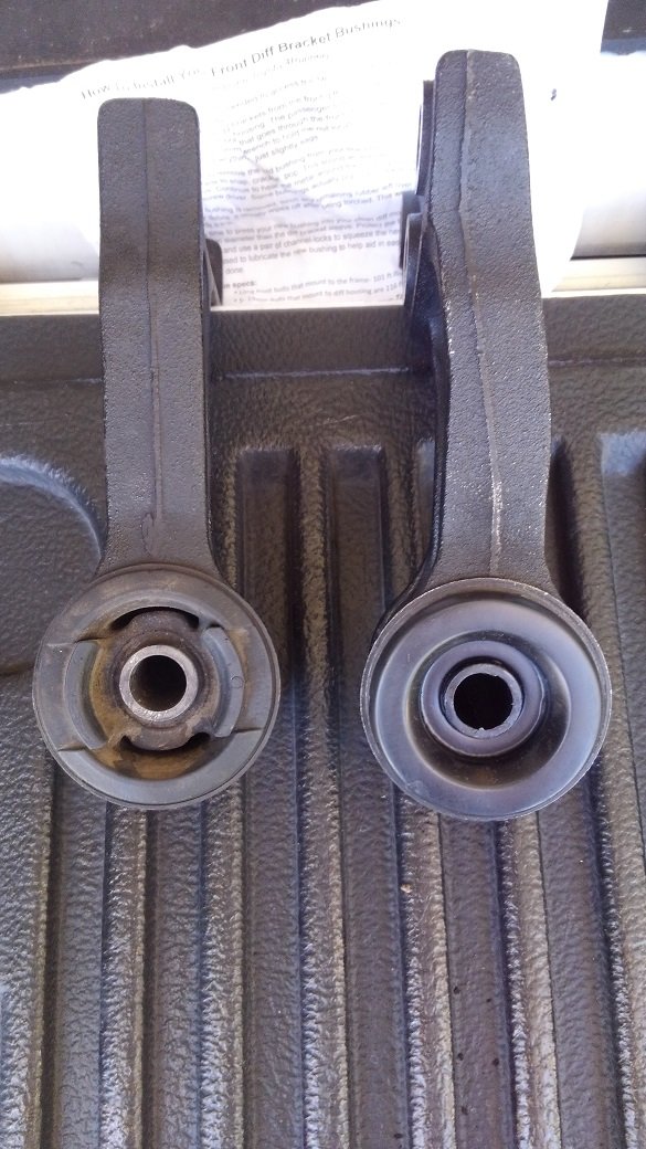

    Here's a comparison of an OEM bushing next to the new bushing. After cleaning the charred rubber from the arm and letting it cool I just poured some isopropyl alcohol on the new bushing and it slid in by hand.

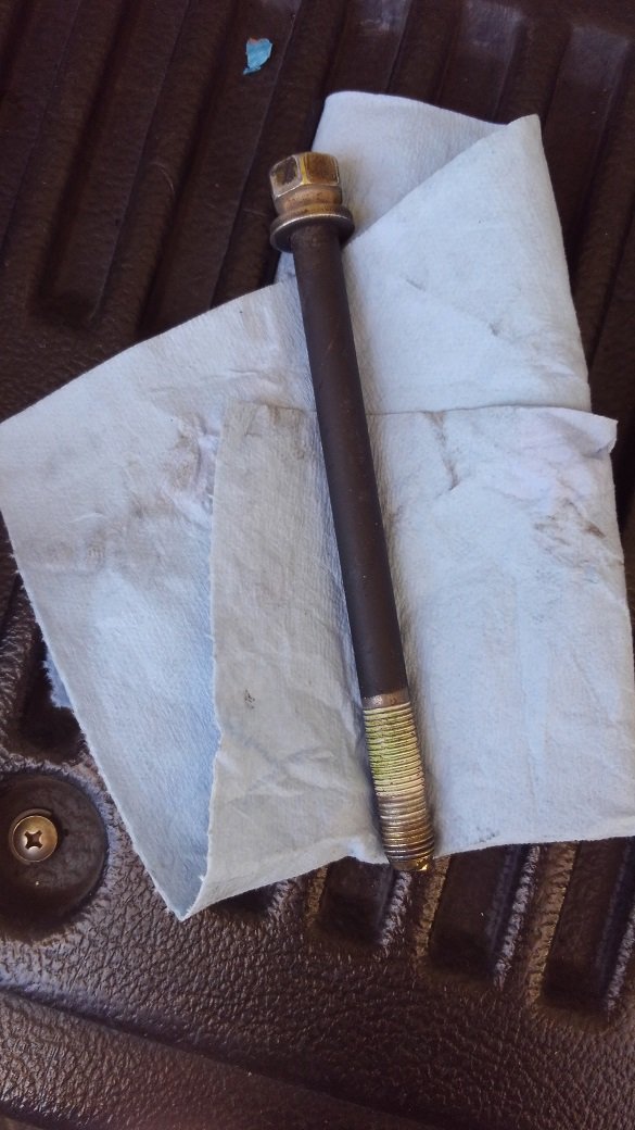

    The zinc plating on this frame mounting bolt was oxidized to hell so I wire brushed it and put a light coat of Rustoleum on it.
    Here they are installed again. I decided to leave the original Right side bushing intact, since it was in perfect condition and still flexible. I'm saving the extra bushing as a spare in case I ever need it.

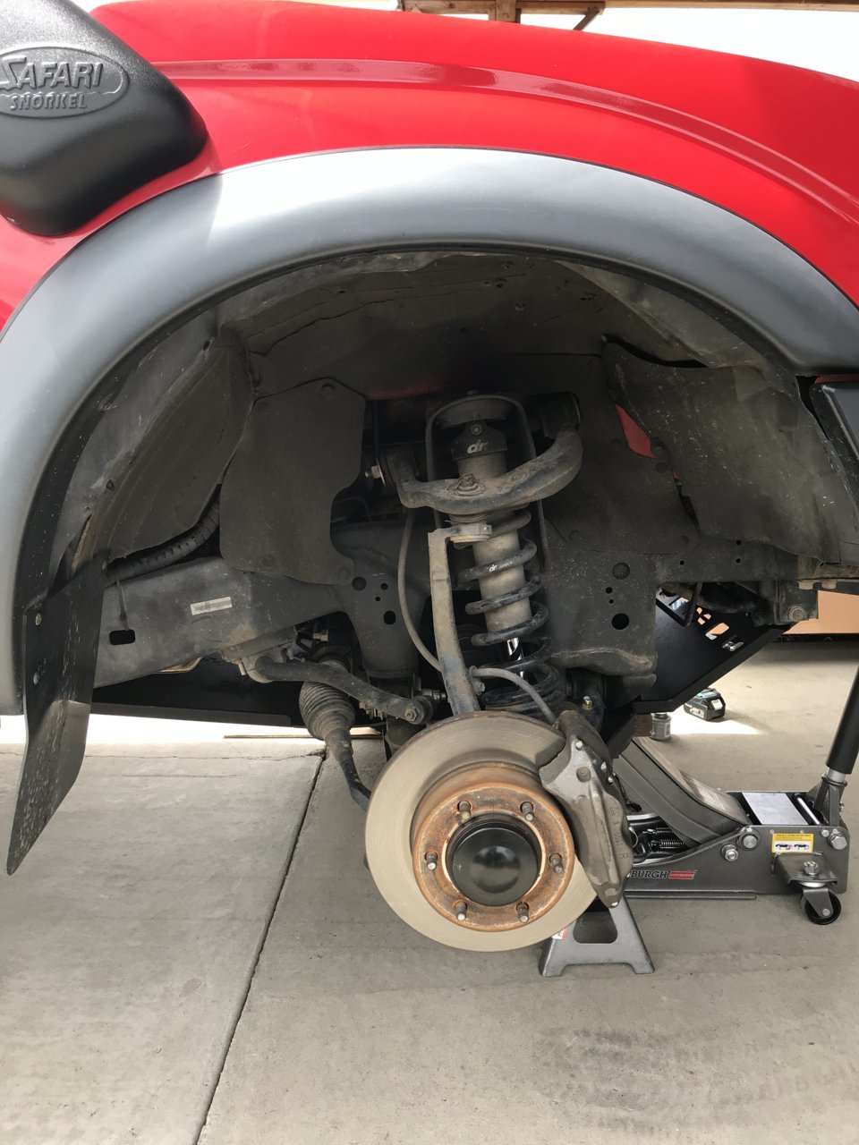

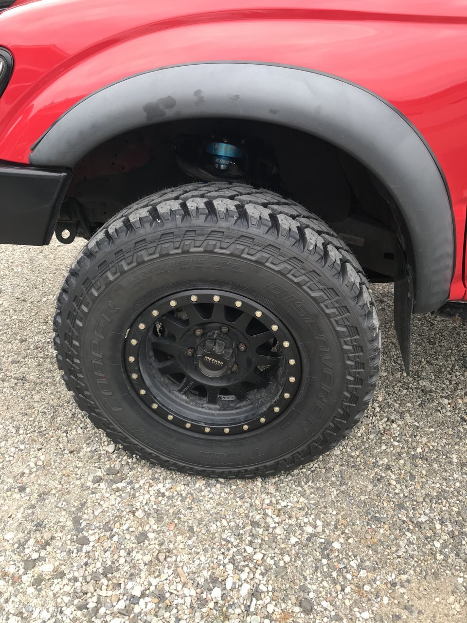

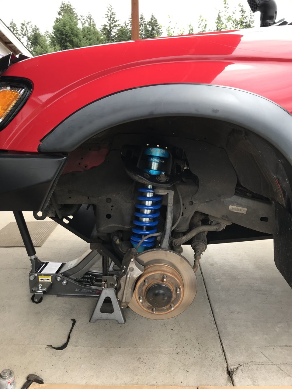

    today i replaced my old donahoe racing coilovers with some new kings and also got some new rubber

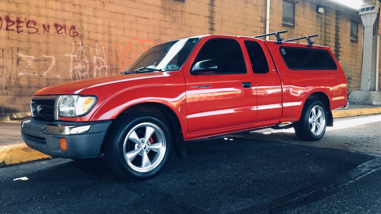

    Used the free time I had this morning to clean up the Taco and do some touch-up paintwork.
    There's nothing better than enjoying a Taco on Independence Day! Happy 4th, everybody!

    I think that year Taco has the best looking front end. Crager style rims look sharp!!

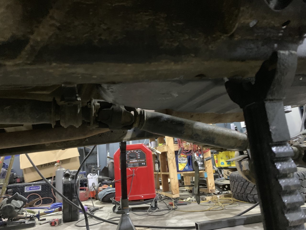

    And to stay relevant, not today, but gas tank is tucked above the frame now.
