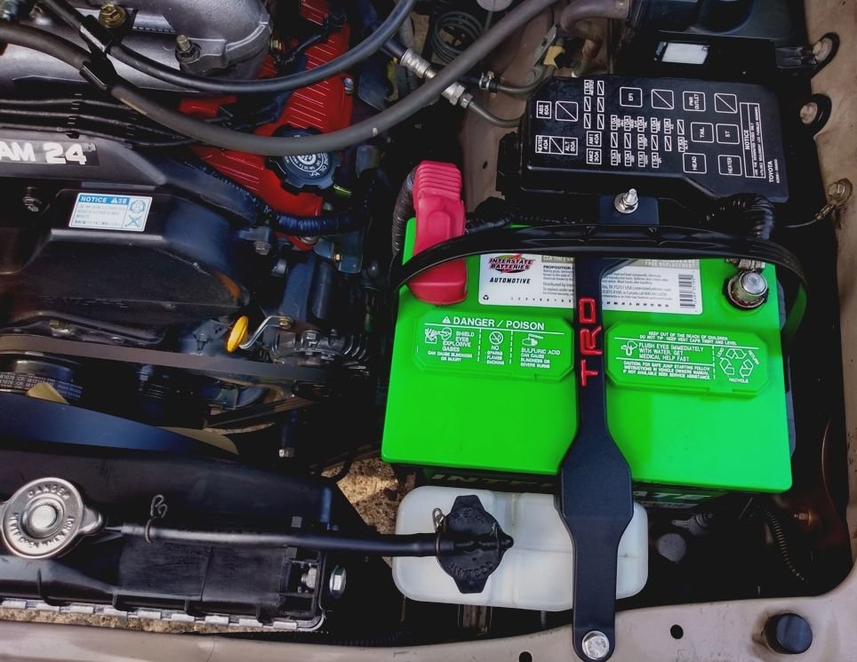

    Installed the aluminum TRD battery hold down this afternoon. @Coupe does a nice job of building these hold downs. Perfect fit.

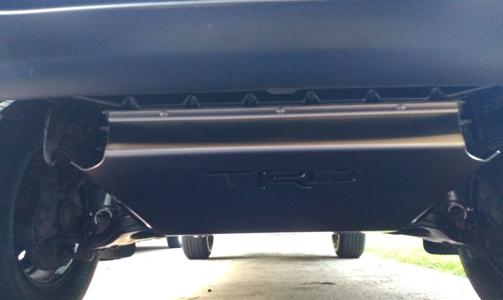

    Installed a skid plate this afternoon. Nice work by @22REthan. It feels like it improved aerodynamics for 80+ MPH interstate driving.

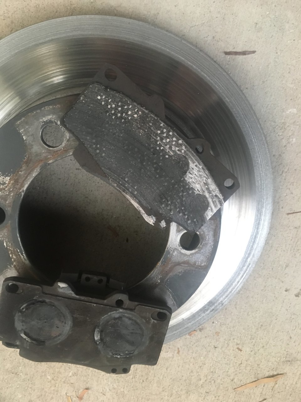

    My GF has been complaining about a “slight” grinding noise when braking while driving my old prerunner the last few days. Finally had a chance to pop off the tire today and found this....
    Poor bastard had worn down to the backing and started to dig into the edge of the rotor. I had suspected the caliper of being on it’s way out last time I did pads(wearing unevenly) and this confirmed it. Swapping out calipers, rotors and pads tomorrow and my throw a set of ss wheelers lines that having been collecting dust while I’m at it.
    Best part is that she is really pumped to learn how to fix all this stuff. So we have our day planned tomorrow. It’s nice to have a wiling partner while doing this stuff haha

    Yep. Looks like stock photography or from a brochure.
