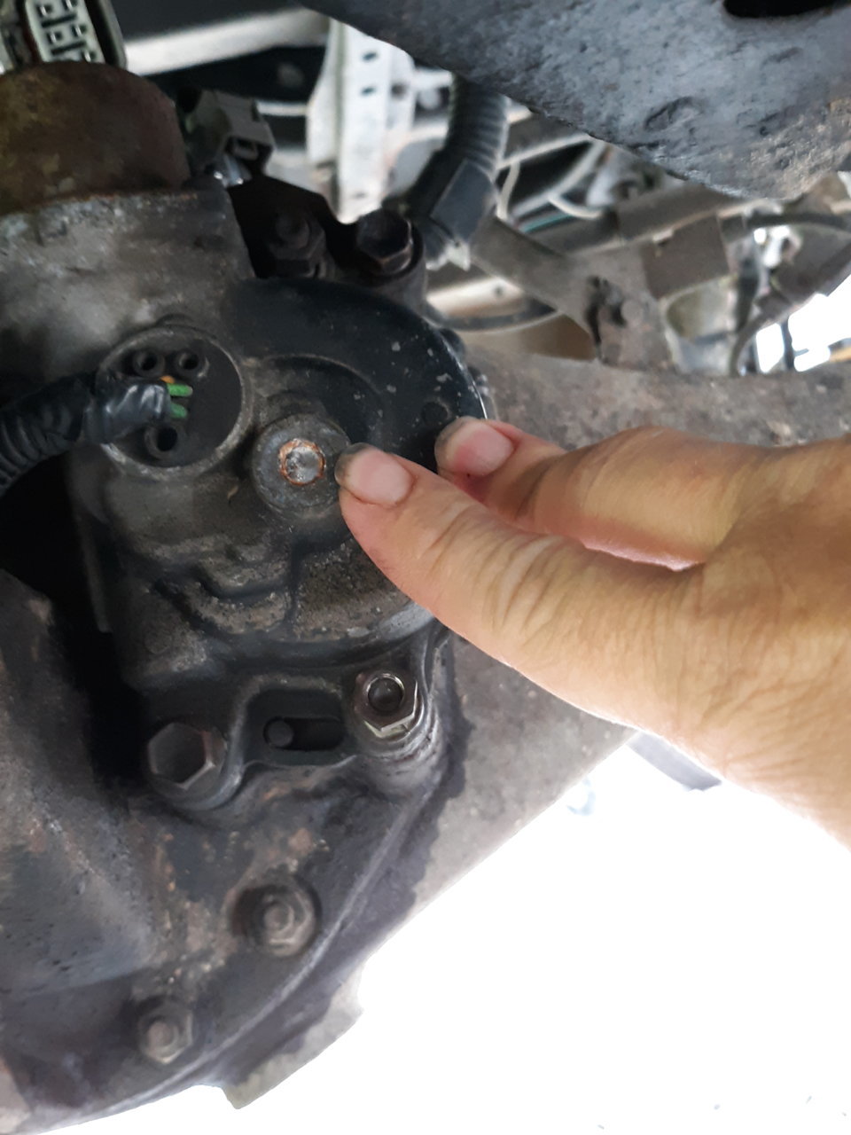

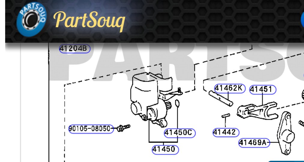

    Did the bolt head have a crush washer or any type gasket? If not, I'd say it does not go through.
  2. Jul 6, 2019 at 6:12 AM
    Wsidr1
    Wsidr1 Well-Known Member
    Jul 11, 2018
    #259004
    3,079
    Indiana
    2 x 95.5 Ext 2.7L & 3.4L A/T 4x4
    See the O-ring on the inside surface. That is likely the seal. For the record, I don't have a diff lock, so I am just going by what I can see here.

    I'm working in a gravel drive, when it broke I lost the head so I couldn't tell

    I know it's not activated because I can hold one tire and the other spins. All bolts are out and wires are unplugged. I'll just beat and pry somemore thanks for the help

    Turns out I was being to big a pussy and afraid I was going to break something after I broke that bolt. A little frustration and a bigger pry bar she came right out. A couple operations of the switch and it worked just fine. Thanks again

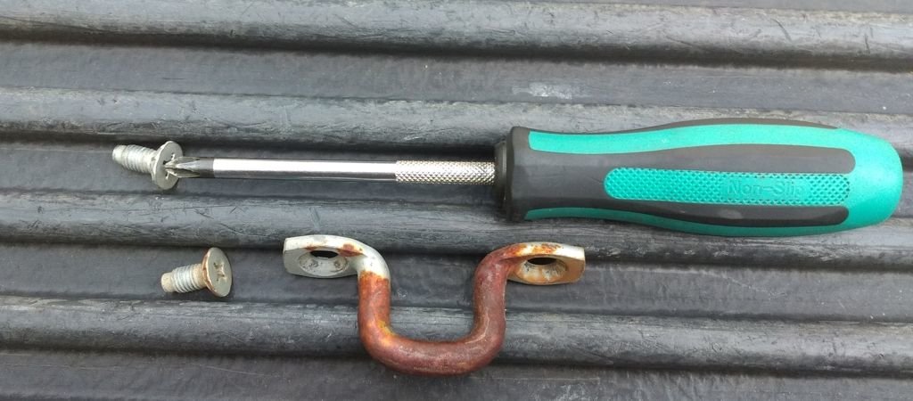

    took truck to dealer as last resort to get these damned rope hooks off before Monday
    they had the proper tool and a mini sledgehammer to get 3 1/2 hooks off VERY SMOOTHLY they came out, last one I had stripped myself had to have the head snapped to get the hook off
    i can deal with getting that broken stuff out and rethreaded at another point in time i guess one last headache for now
    but now i found another headache to deal with :( :mad:
    i suppose it is best to coat threads with antiseize when I get them put back in

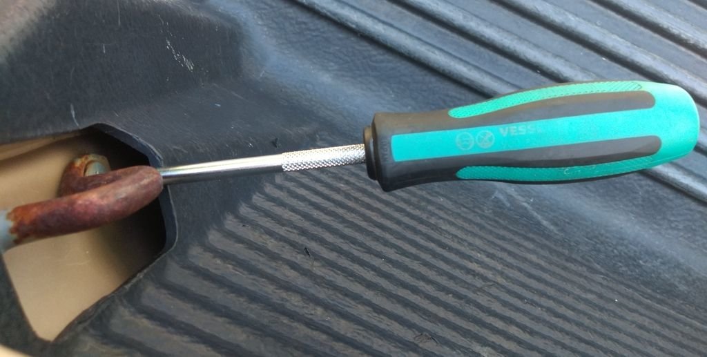

    CS_AR
    CS_AR Well-Known Member
    Apr 3, 2019
    #289019
    12,817
    1999 Tacoma PreRunner TRD
    Everything but the driveshaft. B03A - 410
    Removed my bed hooks using my #2 JIS driver. I have rusty hooks like everybody else.
    No effort required to remove the screws when using my JIS driver.
    I will throw them in a bucket of diluted muriatic acid then hit them with some VHT ceramic paint and bake to get a good ceramic finish.
    JIS drivers make screwing around with Japenese cars easy.
    https://www.youtube.com/watch?v=gEwVUZr5xxQ
    BYJOSHCOOK, Kiloyard and GQ7227 like this.
