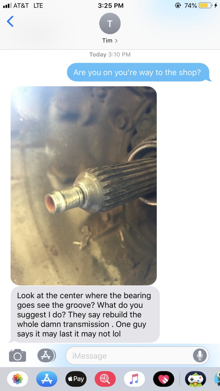

    Not my tranny it’s my buddy’s with a first gen Tacoma. His clutch went out and they found this. Any ideas to fix it? 029AF567-5FFB-4FE9-8AA1-400350049C1F.jpg

    Looks like it wore the race down, old bearing probably siezed. If it runs like that even with a new pilot bearing it'll likely wobble and take out the input shaft bearing sooner than later. I'd either have the input shaft swapped, or I'd have the input shaft clad welded and turned down to spec on a lathe. Putting that back together as is, is asking for failure.

    Yup, I’m sure it’s a failed pilot bearing.
    Probably didn’t put an OEM one in last clutch job.
    Pretty sure you can get a new input shaft. Probably cheaper to just find a used low Mileage transmission for 400-500.
