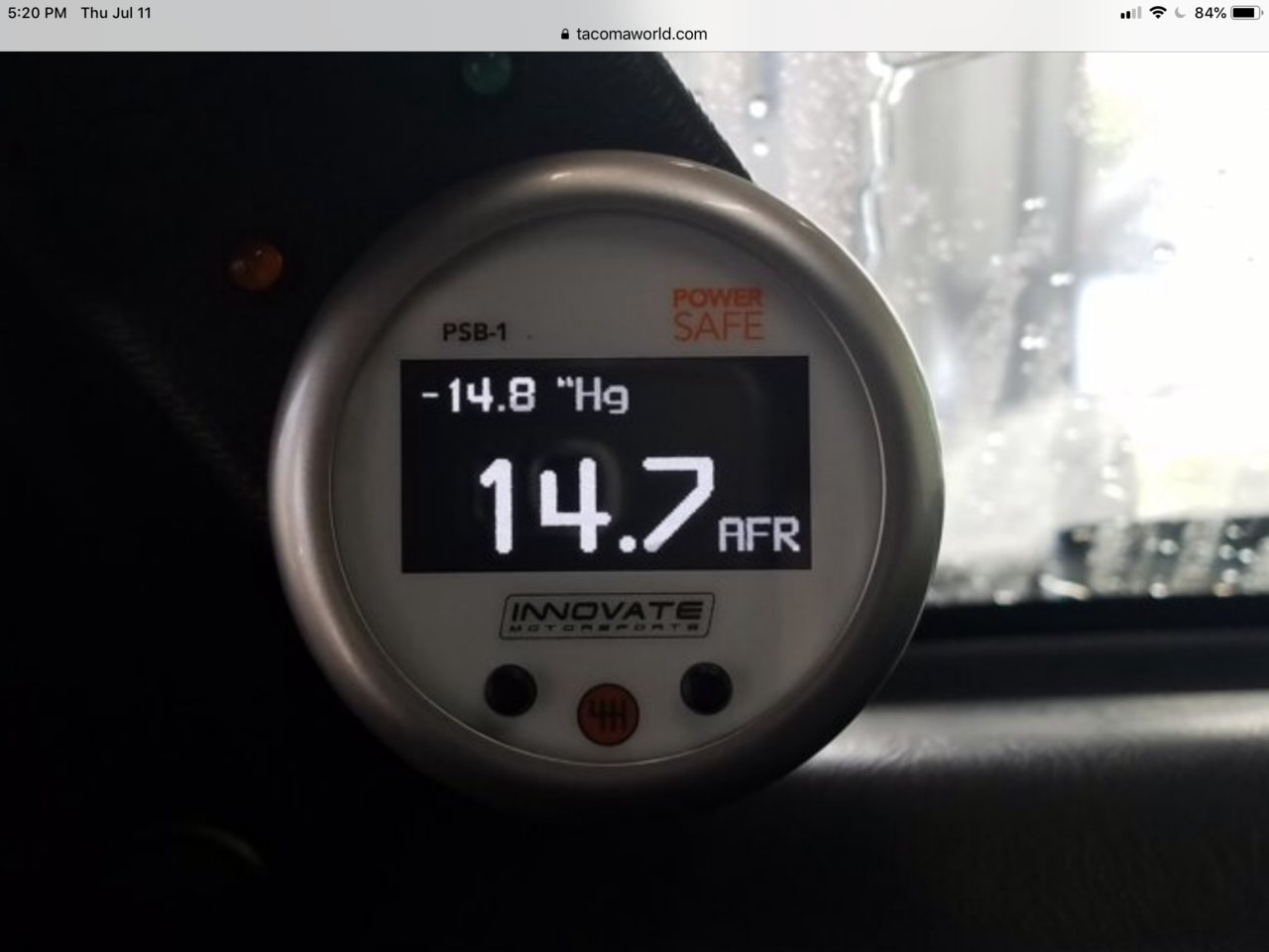

    Let us know how that holds up my analog gauge from power tanks has a floating dial. So I need to replace the gauge with something better.
    Cleaned my throttle body ,replaced my throttle position sensor. I tried to pull off my IAC but started to strip the last screw so that didn't happen. Went to go wheeling and my driver's side door handle broke. And heard something fall down the door so that should be fun.
    Went wheeling.
