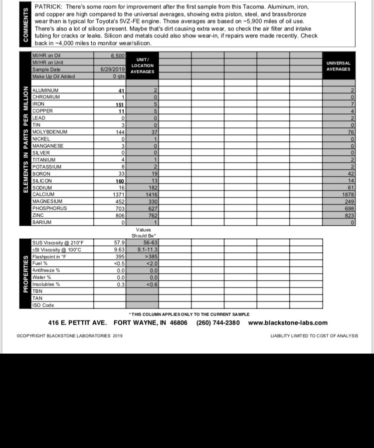

    Got my Blackstone report back for the new truck and confirmed what I was suspecting. The old air flow tube from the filter to throttle body was dried and cracked so i’m not surprised if some dust/dirt got into the engine. Still need to seal up some cracks in the air filter box and replace all my dry rotted vacuum lines and it should be dirt proof moving forward. Fresh synthetic and the new air flow tube should help a lot though.
    Hopefully it’ll level out after the next oil change. Kinda of bummed on these results, wish the previous owners would’ve taken better care of it, but those are the breaks.

    Hey Patrick, Hide your information.
    Wow, Silicon is extremely high.... Like you said, dust bypassed the filter. What oil was in there? Plenty of Moly and quite alot of Calcium? Is this Toyota Genuine Oil by any chance? Very stout add pack.
    Lots of wear across the spectrum. 2-3,000 miles until you get it sorted

    It’s all outdated info, I just never updated it. Good lookin out though
    It was a firestone oil change prior to my ownership. I’m pretty sure it was the cheapest conventional they offered, so 6500 miles was starting to push it. I was planning on pulling it again in 4000 to see if any improvements were made.

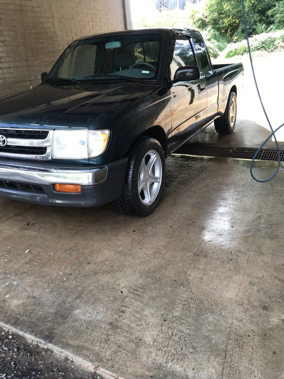

    Washed my Yota and gave it some gas 4D16CFEB-4994-48BD-8AF5-15707E584B78.jpg
