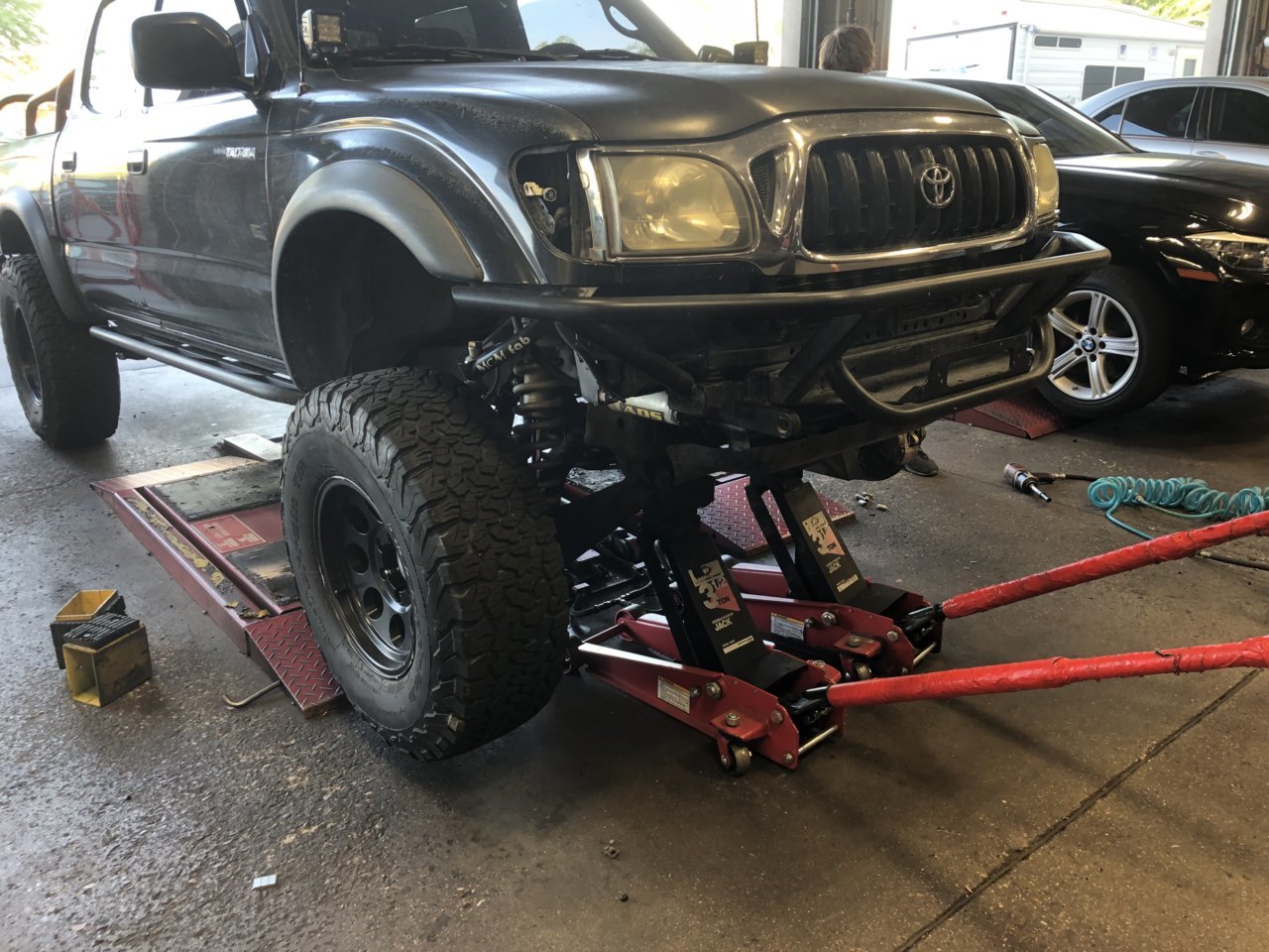

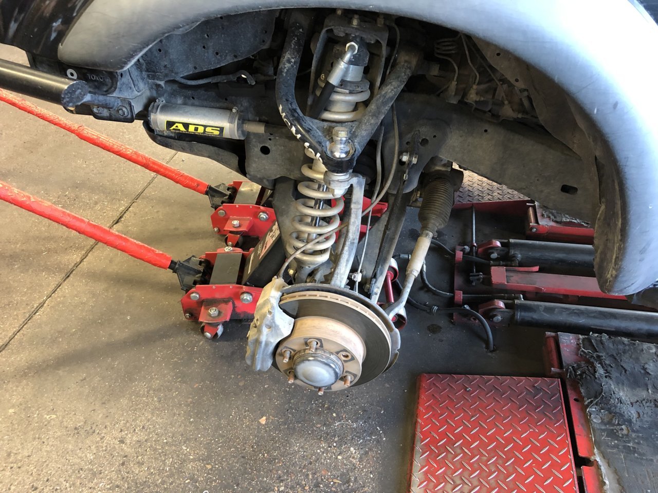

    I would do the easy thing, pull the front driveline and continue down the road. A front bearing should squeal and affect steering, same with shock bushings. Good luck, hope its the cheapest easiest thing.

    Sounds wheel speed dependant. Maybe you lost a wheel weight or two? :notsure:
    Or maybe some broken wheel studs. :rolleyes:

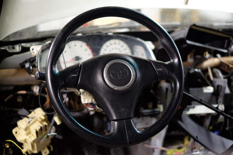

    I’ve been meaning to install mine. It’s plug-n-play from what I’ve read on 2001-2004, however since the cruise control changed in 2001 the cruise control stalk on the IS300 wheel isn’t compatible on 1995-2000. This can be fixed by simply swapping the resistors on the stalks, there’s only three of them.
    Five minutes with a soldering iron probably.
    I also snatched the clockspring because I wanted the trans shifters to control track up/down and volume up/down instead of shifting the transmission. Easy to do with some additional resistors and a stereo interface.
    If you don’t care about cruise control or the shifters it’ll bolt right up to your steering column. You just have to do a little repinning to get the horn to work.
    The IS300 is a desirable steering wheel swap because the airbag squibs are the same. It isn’t the dual stage charge found on most other Toyotas. Only a few vehicles of the era still used that old single stage squib, including the IS300 and RAV4.
