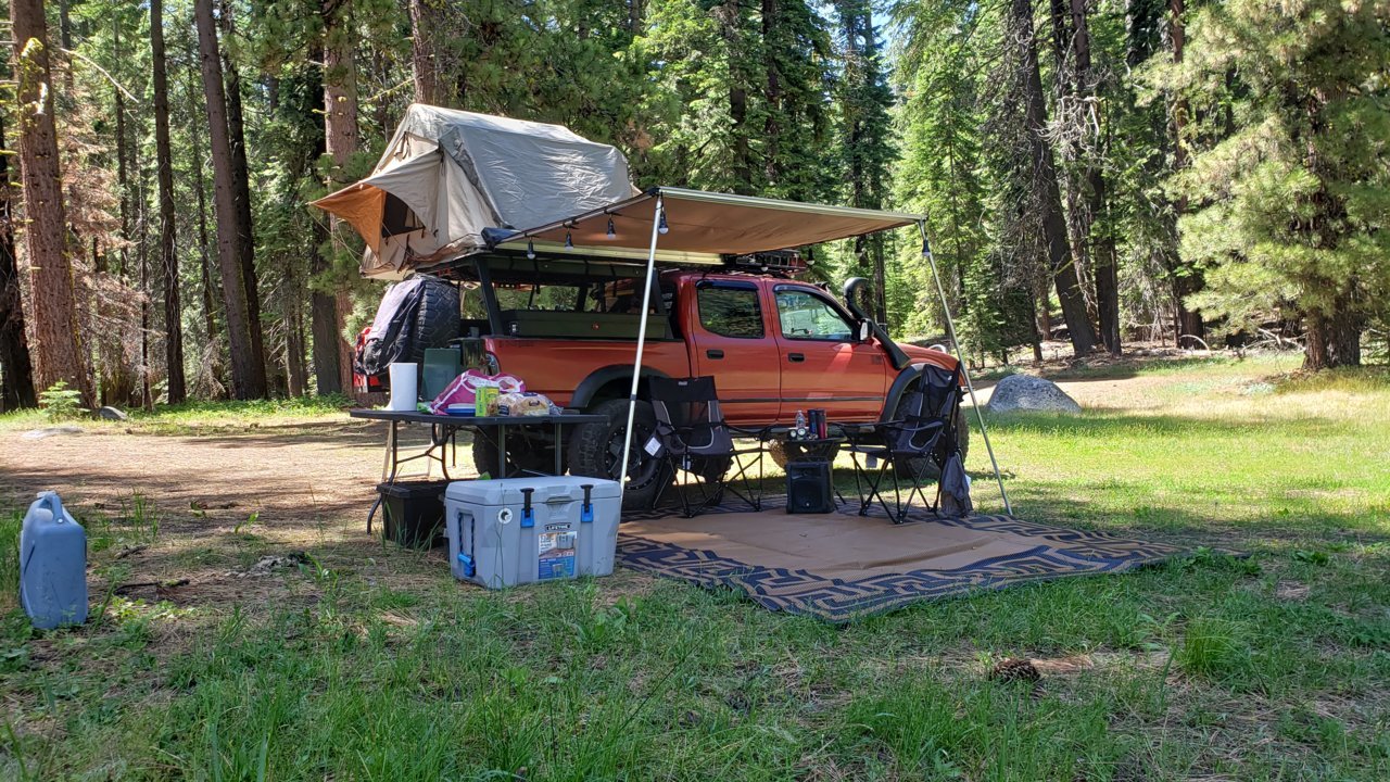

    Well, my weekend plans were cut a bit short this passed weekend. We got a really late start Friday night... and then our Trans temps started to spike and truck over heated on the way up to our campsite... at about 10PM. By the time we made it to our campsite, got set up, and got to bed, it was passed 2AM. We were much closer to camp than home, it was late, and I didn't feel like making the drive home at that point.
    Was the first trip, fully loaded, since the 4wd swap (and also going from 265 to 285 tires). Pretty sure I have the right ideas on how to solve the problems... and that's what I'll be doing this weekend. :rolleyes:

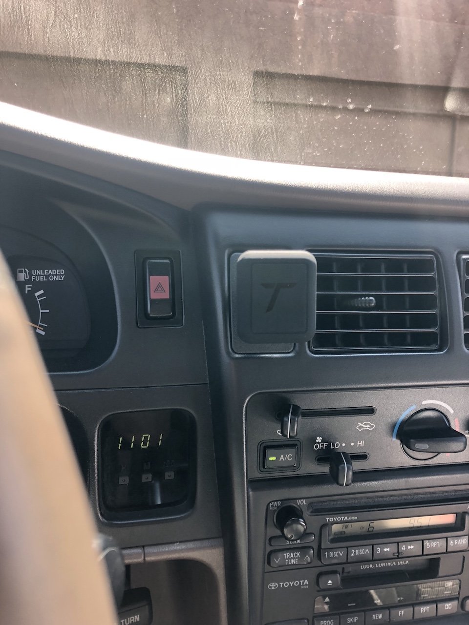

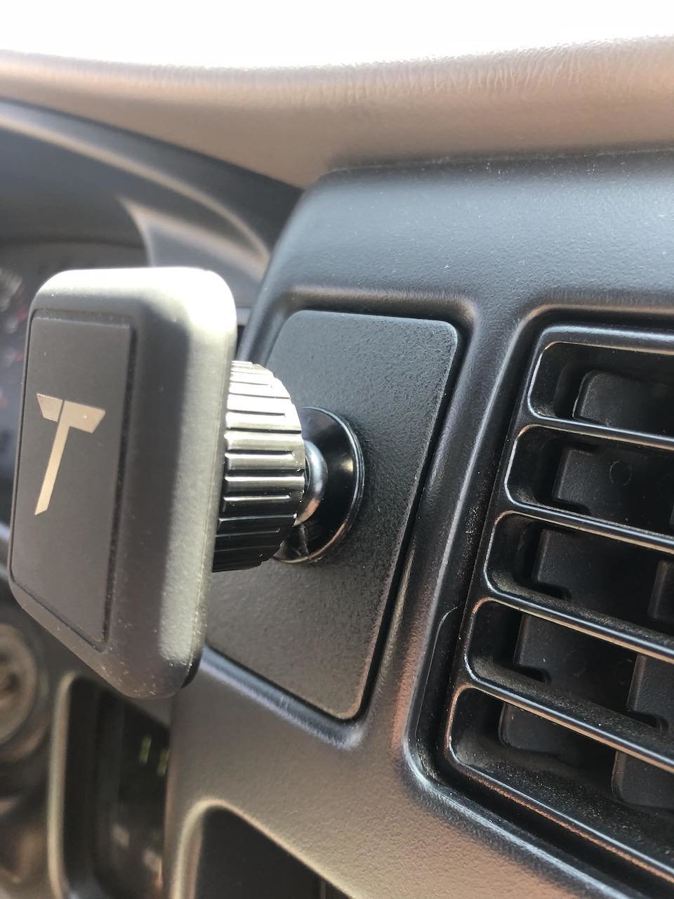

    I made a phone mount today. Came out pretty good, really clean looking and stable.

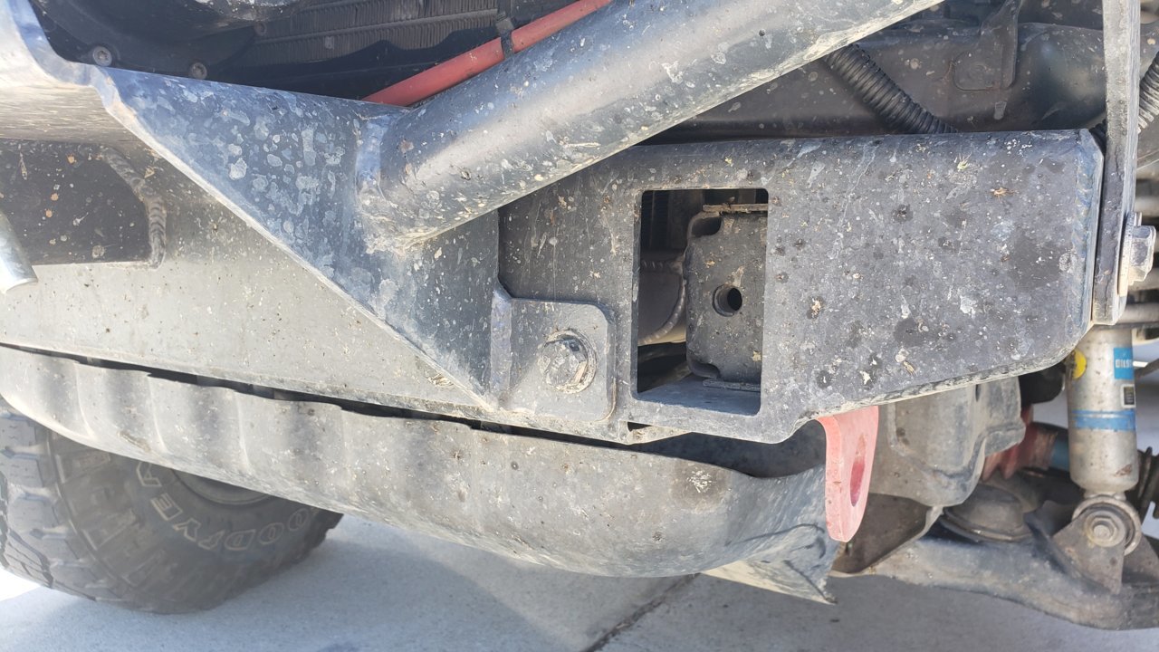

    I did replace the fan clutch to the "tow duty" Aisin fan clutch.
    I don't have a tranny cooler (yet) other than just where it runs through the bottom of the radiator. But I just realized, this past weekend, that entire section of the bottom of my radiator is basically behind the crossmember my TrailGear front bumper is mounted to.
