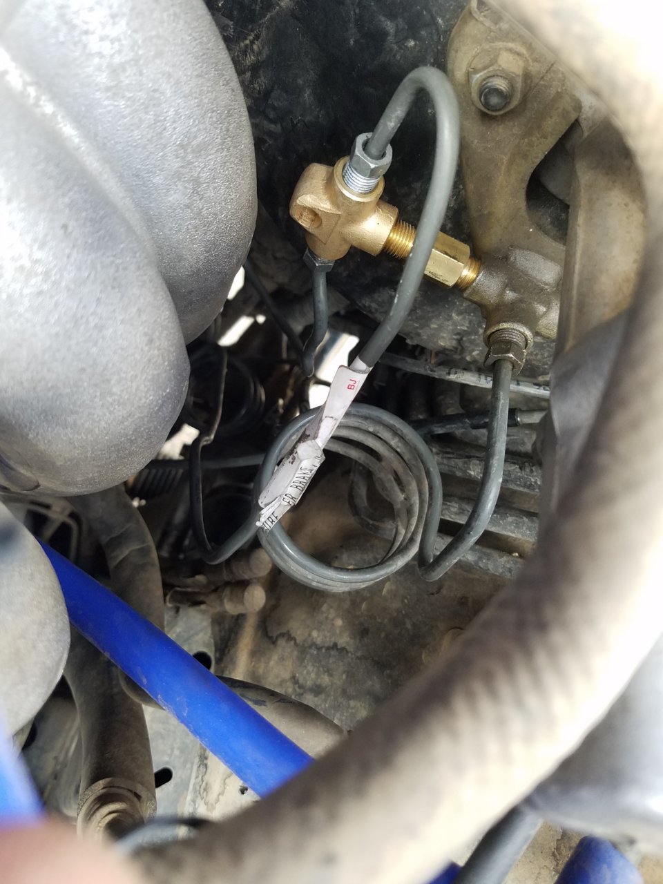

    My version of the abs delete. Lowrange sells the T and union. I reused the short passenger line and another one of the longer lines with the coil from the old system. The longer line went from the T to the passenger caliper. The short line went from the port on the master closest to the cab, to the return on the lspv on the frame. The part number for the new line I bought is 473126A160. This connected the driver caliper to the new T. The lines are very easy to bend to fit the form you want.
