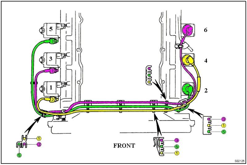

    I like the design of those, i'm gonna look into them
    It was a short line that goes from a hardline under the brake fluid reservoir to another hardline between the #4 & #6 cylinder spark plugs
    You can actually see one half in this pic, it has a little holder attached for the #6 wire

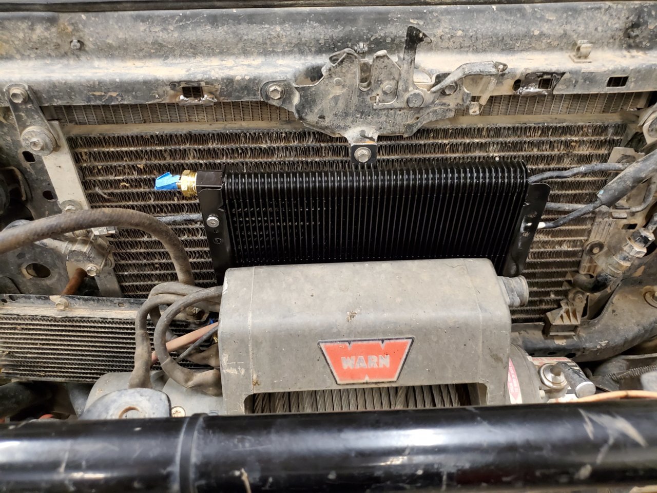

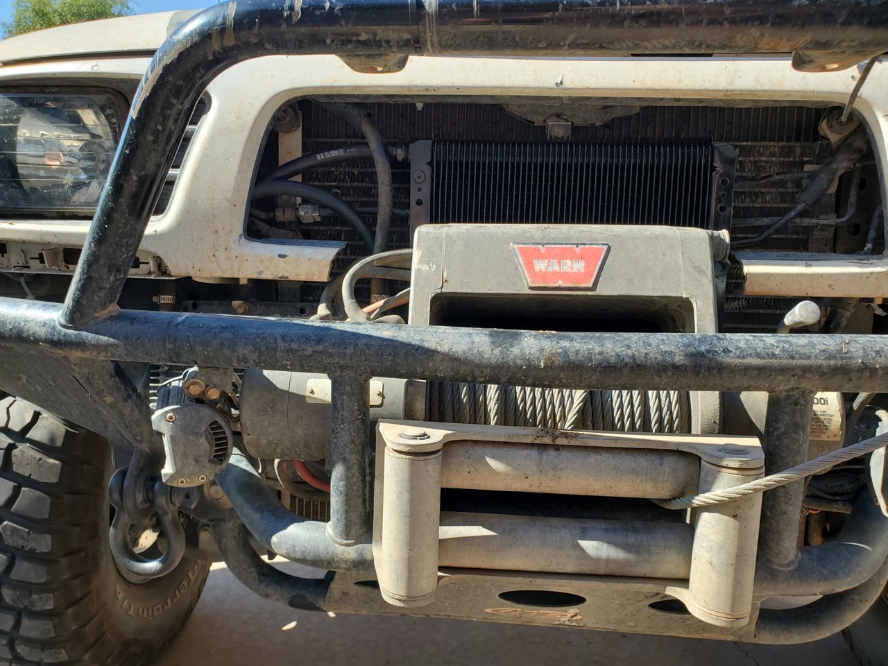

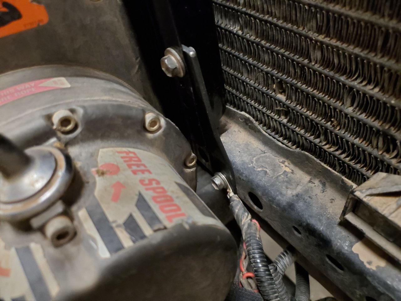

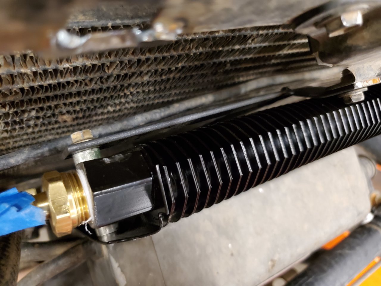

    I added a B&M transmission cooler to help keep temps down with the added stress from the recent supercharger install. It's the biggest cooler they offer so there wasn't much room between the core support and winch. I removed the stock core support and made a new one out of some flat strap to make room. I made a couple little brackets, ran the lines and had to remove the grill to get it in there. Might move it over later to get a little more air flow, but this work for now.20190726_172149.jpg 20190726_172153.jpg 20190726_172200.jpg 20190727_161431.jpg
