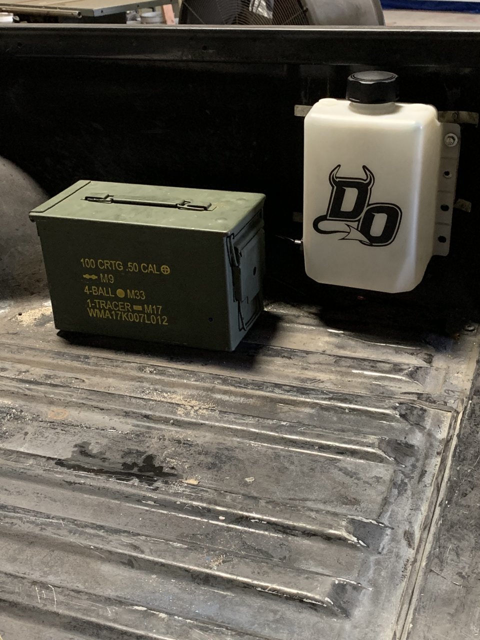

    Will get better pics and test drive tomorrow. But everything works like it should. IMG_20190727_202502365.jpg

    Nice! Is it a smaller diameter?

    Yes. By about 1.5" or so.

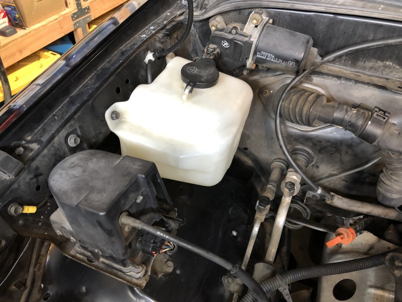

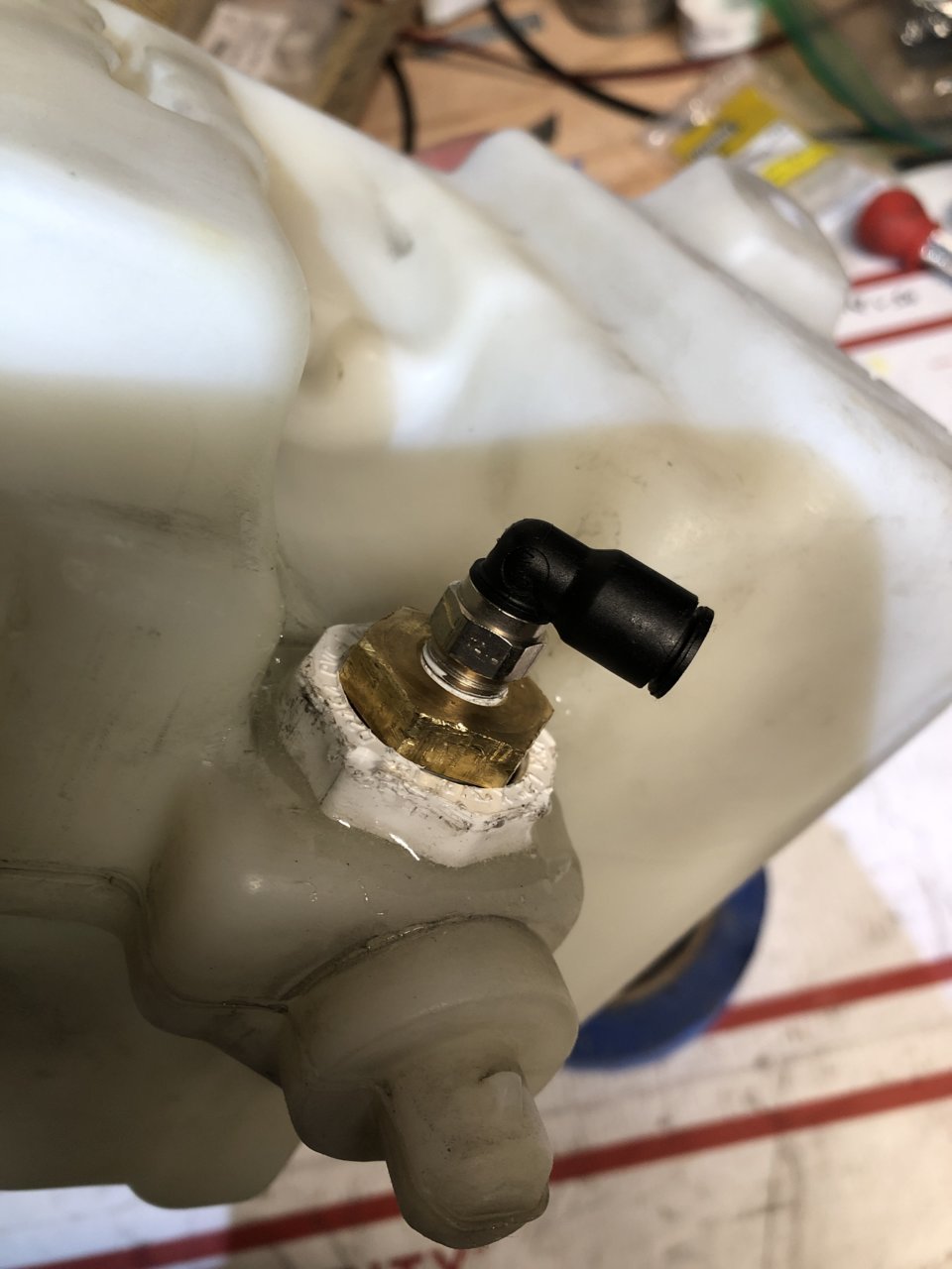

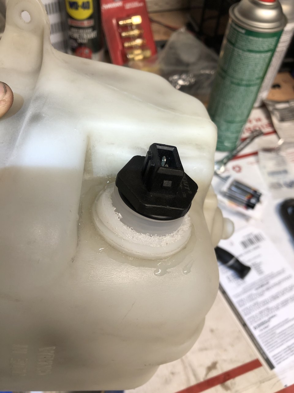

    Here’s how I mounted my reservoir. I modified a non cold weather spec washer reservoir to accept the quick connect from the AEM reservoir. The pump is mounted right below it, not pictured.
    Since I used a Tacoma reservoir it fits perfectly in this spot. This isn’t the stock mounting spot, it actually mount where the cruise control is. One hole is tapped but I have to drill another near the washer motor.
    I drilled out the original pump hole and used a variety of step down adapters and epoxy.
    For the low fluid sensor, I drilled out the AEM reservoir bung with a 2” hole saw with my drill press and epoxied the bung to the reservoir in a hole I created.
  10. Jul 27, 2019 at 5:56 PM
