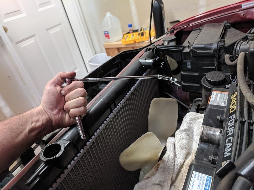

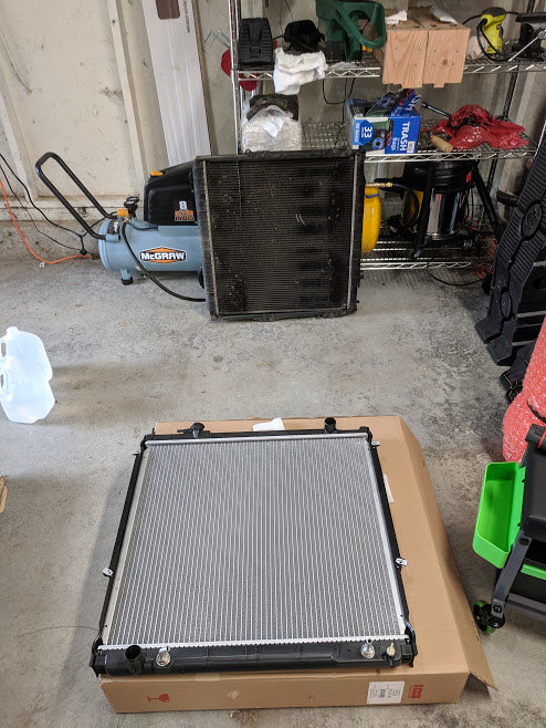

    Replaced OE Harrison rad. No issues with it, just 15 years old with ~173k miles on it. Paranoid about that strawberry milkshake...
    Remove grill to replace radiator? Nah, too lazy for that.
    1 flush cycle of distilled water, just because. Shop that did the timing belt and water pump right before I bought the trugg filled red coolant, but no idea what type. New rad is Denso 221-3138, Toyota Long Life antifreeze 1 gal fill, rest distilled water. I'm probably 40-45% antifreeze, but it doesn't get that cold here.

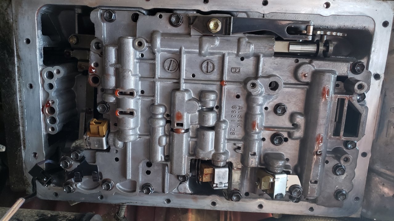

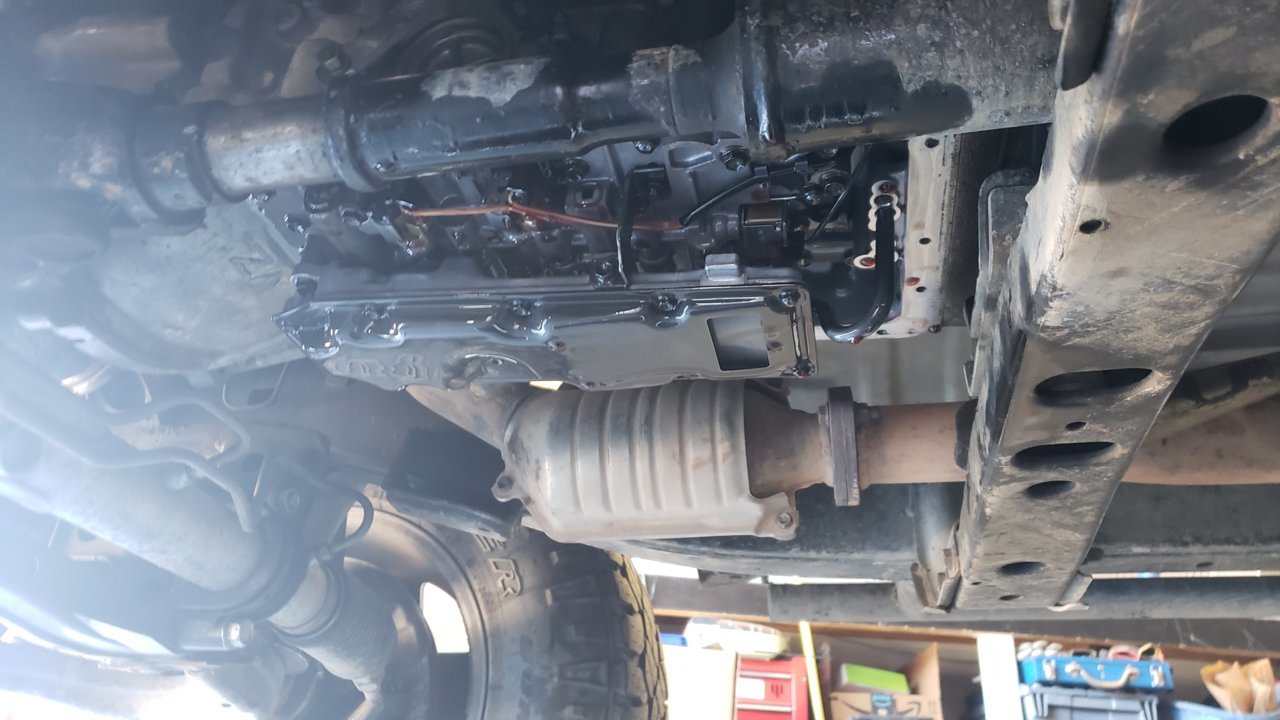

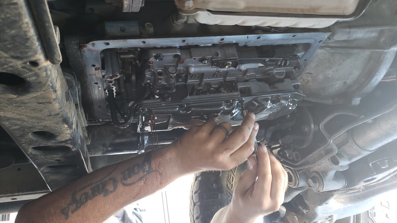

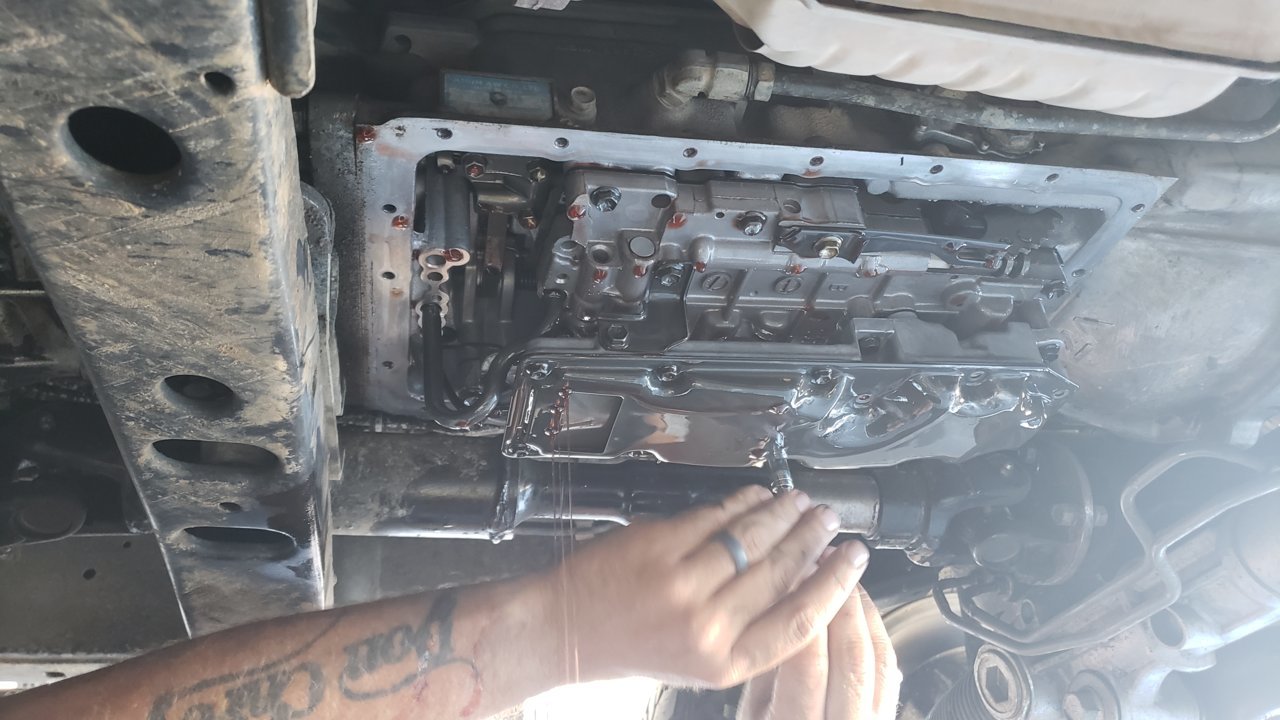

    Dropped the valve body on the trans to replace the Lock up Relay Valve bushing. When this bushing is worn, it can cause Torque Converter lock up delay and over heating.

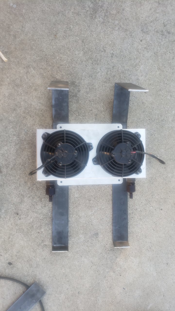

    Started fabricating the brackets to mount a transmission cooler under the bed.

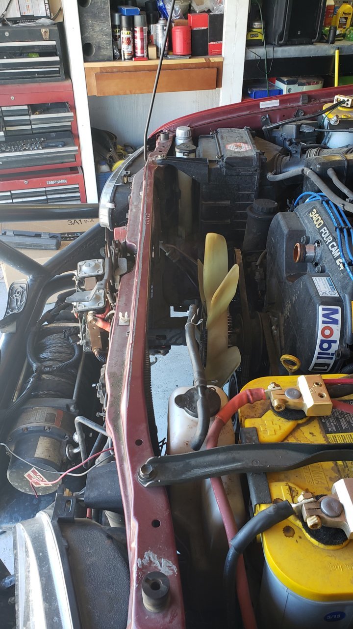

    Removed the radiator to get better measurements on where to trim the shroud to fit better. Also made it easier to replace the thermostat. And I shoved a stainles steel spring in the lower radiator hose. (no way that thing can collapse now). Flushed the system twice before tearing it down. And reverse flused the heater core.

    That’s a big ass transmission cooler. With the Trucool I have I get temps of 140-160 on highway. And I hardly get above 190 around town or going up hills. That’s plenty really.

    160-180 is the ideal temp for a transmission usually. so your doin good

    Is this preventative or did the tranny have symptoms? I'm interested because I have an auto 1st gen.
    Thanks.

    It was suggested in the instructions for the shift kit I put in when I did the 4wd swap. Didn't say you "need" to do it for the shift kit. But it did say a worn bushing can cause slow lock up and heating issues. My trans has been running hot lately, so I decided to go ahead and do it.
