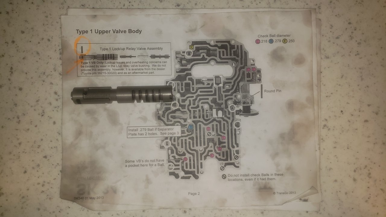

    Here is the old bushing. It's pictured (orange arrow). It's in the side of the upper valve body. But you have to split the upper valve body from the lower valve body to get the retainer out (orange circle). Which means doing it at the same time you're doing the shift kit makes a HELLOFALOT more sense than the way I did it... lol.20190727_212938.jpg
    ***NOTE*** there are multiple A340F valve bodies, this part number works for mine, but you have to make sure you get the right bushing for the right valve body. The Transgo instructions make it pretty simple to identify which valve body you have.

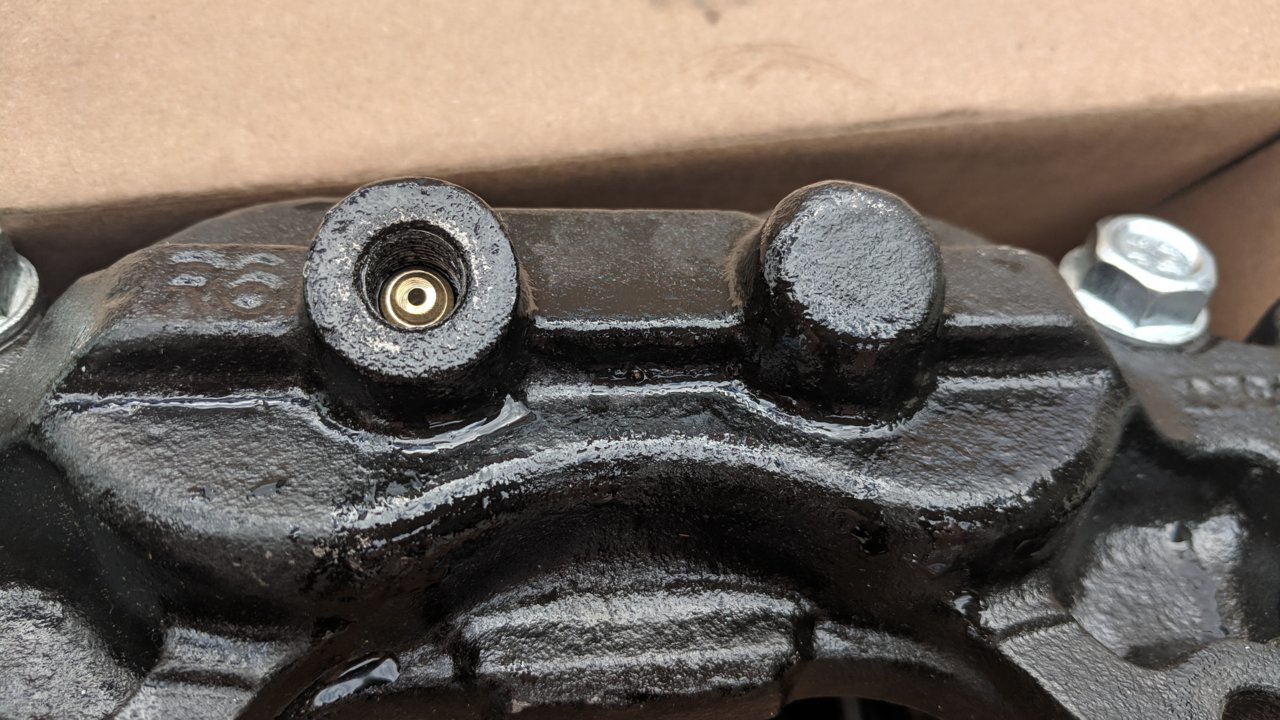

    Is that tightened down? If it is, it's way too loose. If it's not (and is just a test fit), then the key is going to be to ensure that the surface on the caliper where the crush washer goes is ground and not painted. Otherwise you won't get a good seal when you snug it down.
    You don't want it to look like this:

    Test fit. And yes I filed it smooth.
