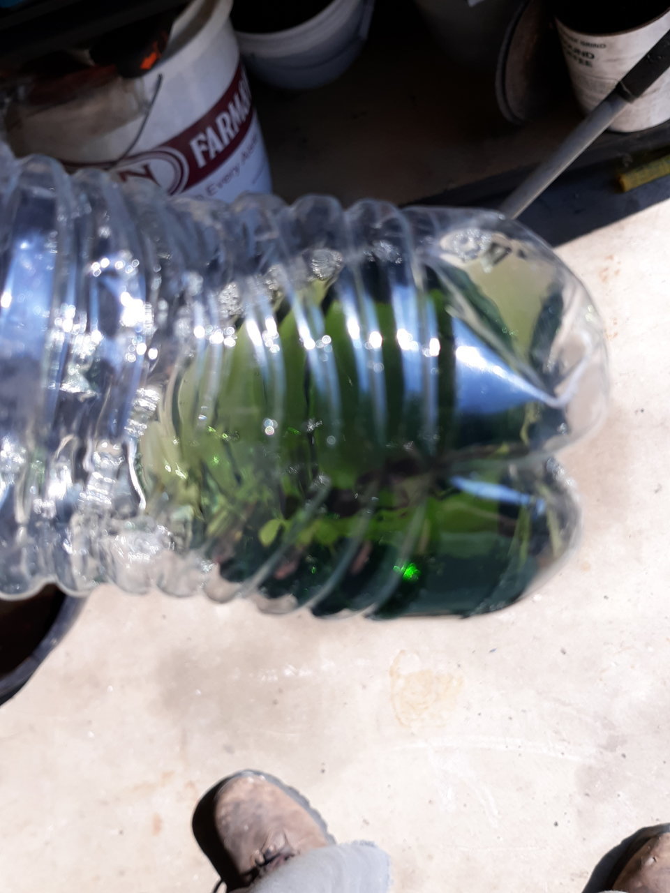

    Nope, that fluid has gone bad. It picks up water and corrodes the brake lines gradually turning green, it turns a darker green as it wears away rubber seals, and eventually sooty grey signalling your braking system is about ready for a replacement of everything. Every three years is the usual interval as brake fluid is hygroscopic and absorbs water.

    Thanks for the help. Guess I'll be bleeding the whole system tomorrow

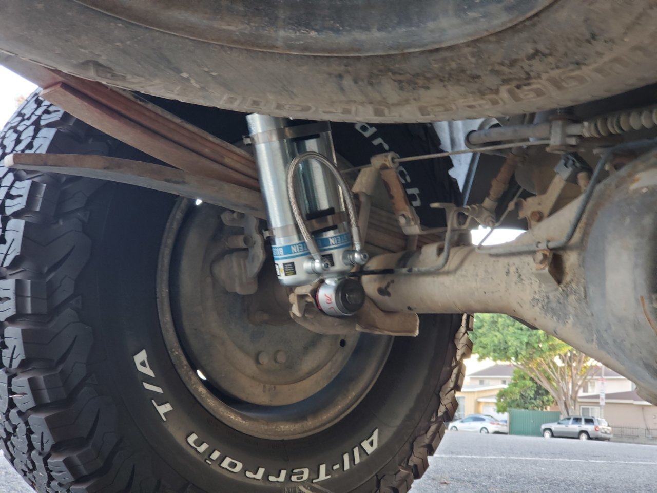

    Got bilstein 5160s put on today. The shop I went to put them on upside down and told me it was fine. Not sure how I feel about it. Dont really that's you cant see the reservoirs. Function over fashion always. And the truck drives smooth as it should. But I did just replace some rancho 9000s that were past due. Is this gonna cause any problems? Any thoughts?

    Thought it looked odd.

    Just get some worm drive clamps and a section of rubber hose. Cut the hose to length. Thread the worm drive clamp through the hose. Attach the resi's to the crossmember with said clamps.

    I think you can get them rather large but I typically like the rubber isolators and a worm clamp.
    But you can get the fancy billet clamps too, just gotta make sure you have the clearance and the right tube OD and reservoir OD
    https://www.kartek.com/parts-categories/shock-reservoir-clamps.html

    Never seen that before o_O I think it should be fine depending on the shock... just be careful if you plan on taking it off road

    What are the compressed and extended measurements? I may need these.
