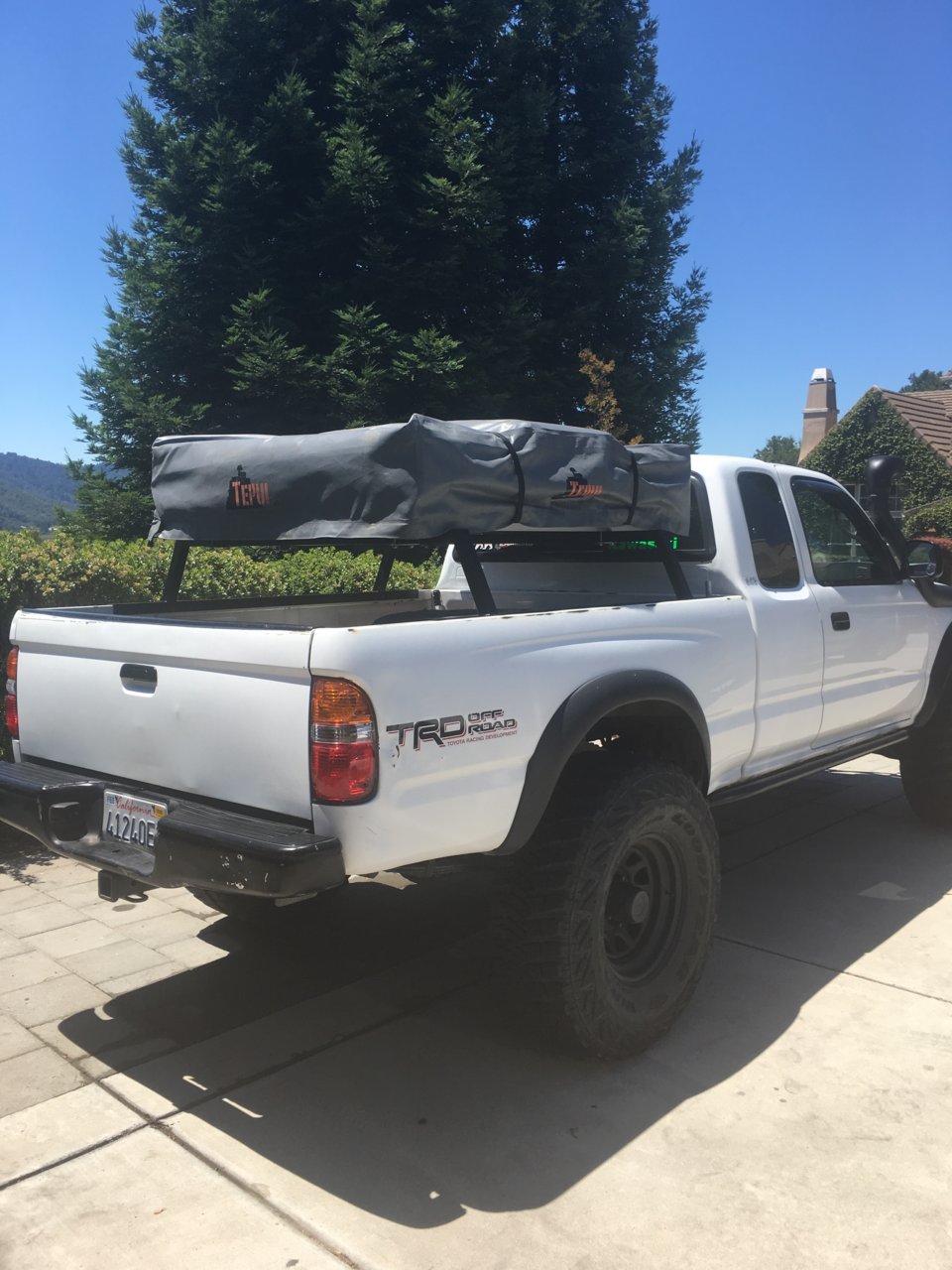

    I like how you can quickly reconfigure with that upper mount. Nice idea.

    What upper mount is that?

    Truck parts
    Rack and tent all mounted

    Damn. They don’t make those any more

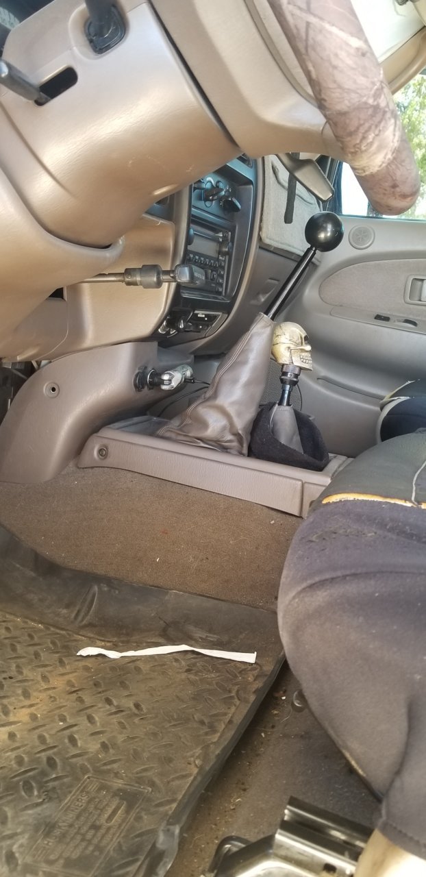

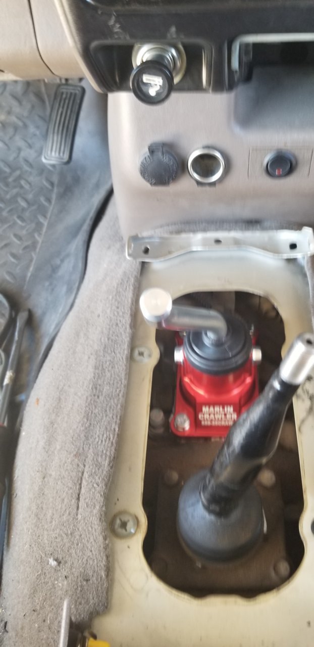

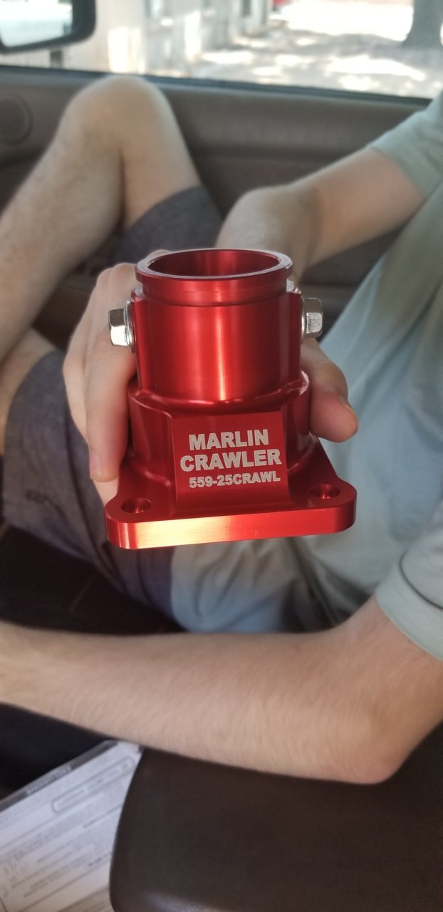

    So.... I dont recommend be fat and wrenching when it's a 106 out,( Feels like 120)...
    But if you do I hope it's for something that you think is cool.
    In such I'd like to offer exhibit A ; for awesome.
    The shifter sits up a couple of inches higher. So I'm not sure if my #'s translate correctly ,the stock throw was 5 1/2 " and the new is about 3 1/4.
    And I fixed my outside door handle .but broke the inside one... go figure. At least I can open it .

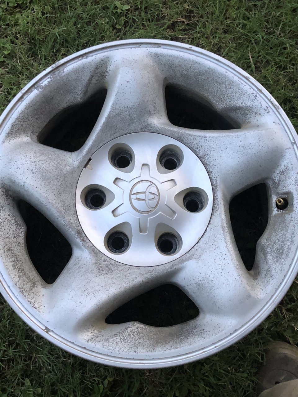

    Anyone know if these rims are painted? Looks like it, but did 1 coat of aircraft stripper on one and it didn’t do anything, just left a orange coating. Picked up the whole set for $50, so I’m trying to to put too much money into them.

    Nope look like the oem 16x7 rims I had. The black is probably oxidization. Try some aluminum cleaner it will come right off. Or sand them with 80,100, 150 grit.

    Thanks! Should have hit them with aluminum cleaner first but it looked painted.
