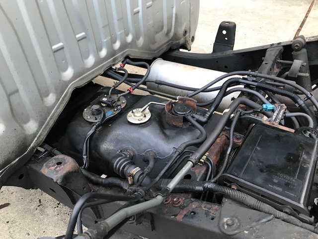

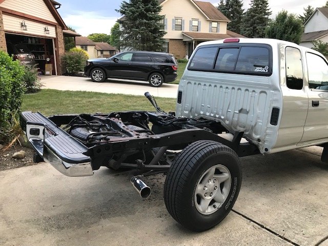

    did you paint that with a better quality paint?
    that POR 15 stuff I hear does not last for too long, cracks and peels easily sometimes
    not bad looking at all for 16 year old frame!

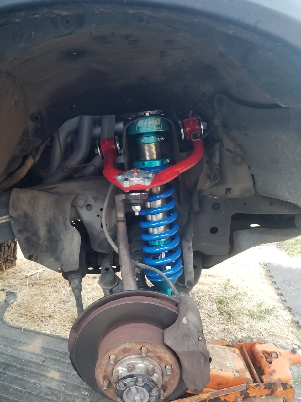

    What's the general consensus with JBA's in the first gen community? I am thinking a sealed ball joint might be best for me in the NE as much as I want to run TC bling.

    You get more adjustability with SPCs but the couple people I know with JBAs really like them as well.
    FWIW Mevotech sells rebranded SPCs for about half the cost.

    you wanna talk about stealership?
    i priced a new front fuel tube at local dealer ... $65 !!!
    camelback was about $25 ... plus shipping but a flat $20 with some other parts ordered to cut shipping down a bit

    But how many people are fully taking advantage of that adjustment? From what i was reading, a lot of people only could use like 3 settings. I am hopefully pairing the UCA with an extended travel coilover from ADS, and I worry it won't handle the abuse. But they are like 30 mins from me, so if it breaks I can literally show up at their door.

    TBH I don't know of many that adjust the SPCs much outside of the normal D setting. You automatically get some additional caster when you install them and I was able to get mine to 3˚ via the lower cams at the alignment shop so there was no need to change the normal setting on the UCAs. I guess it's just there if you need it which might be nice to have for some, but unnecessary for others.
    One thing I do like about the JBAs that the SPCs don't have is the ability to grease the bushings in the arms. I haven't had my SPC bushings make any noise yet so maybe it's not all that important but it's nice feature if you ask me.

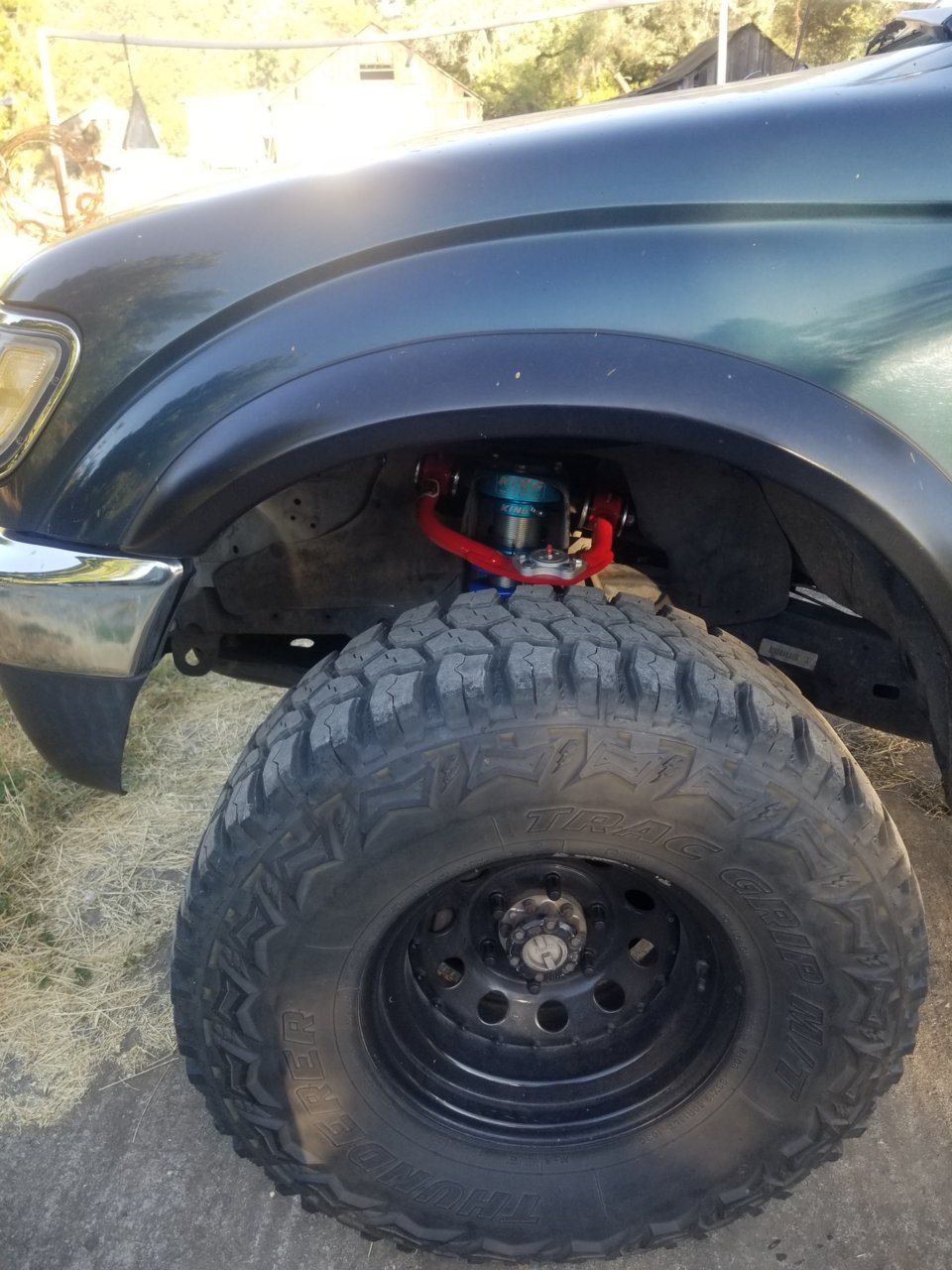

    JBA or SPC - get whatever one you want. Red or black.

    I do as well. I'm not buying the JBA because of the red.

    Paint is cheap, pick a color.

    Lol there is something that would piss me the fuck off about rattle canning my $450 upper control arms.
