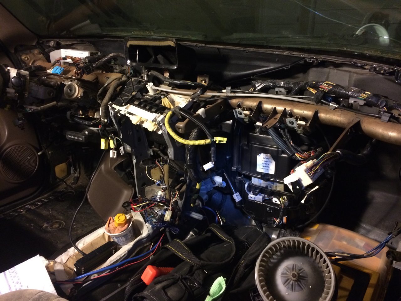

    But I was cleaning the whole area back there - if you remove the glove box and the lower panels and the blower motor you’ll have enough taken off to get it. You’d have to pull out the lower shroud around the AC evaporator to get to thoroughly clean it but I was able to pull it and vacuum up most of it.

    those parts underneath are not bad, I took one apart to the heater core at a salvage yard earlier this year, its pulling the dash apart that worries me, i need to replace and find where all these foam chunks have been spewing from the vents and find the weird rattle on the highway at 70mph with fresh air flow setting on ... i have no idea yet where it is coming from

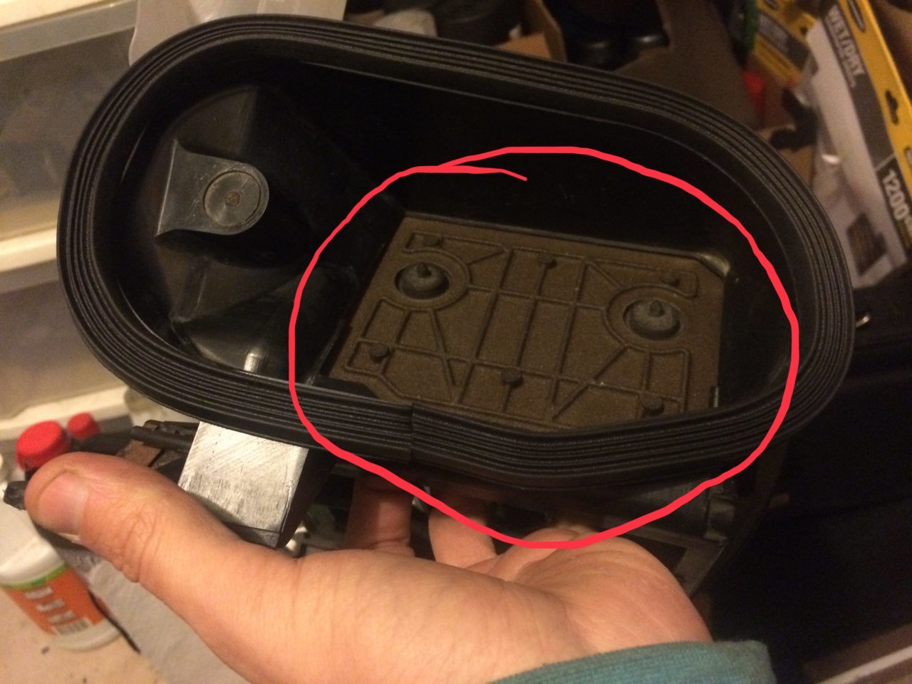

    I cleaned all the remaining foam off of the trap door for the vents which was completely coming apart when I barely touched it. I figured living in Southern California wouldn’t matter too much with cool air coming in in the winter and I nearly never use the AC so the sealing / insulating effects of the foam isn’t just a thing I care about vs. the foam falling off.

    very nice, i wonder if the loss of foam cushioning on the trap door is causing this vibration at certain wind speeds

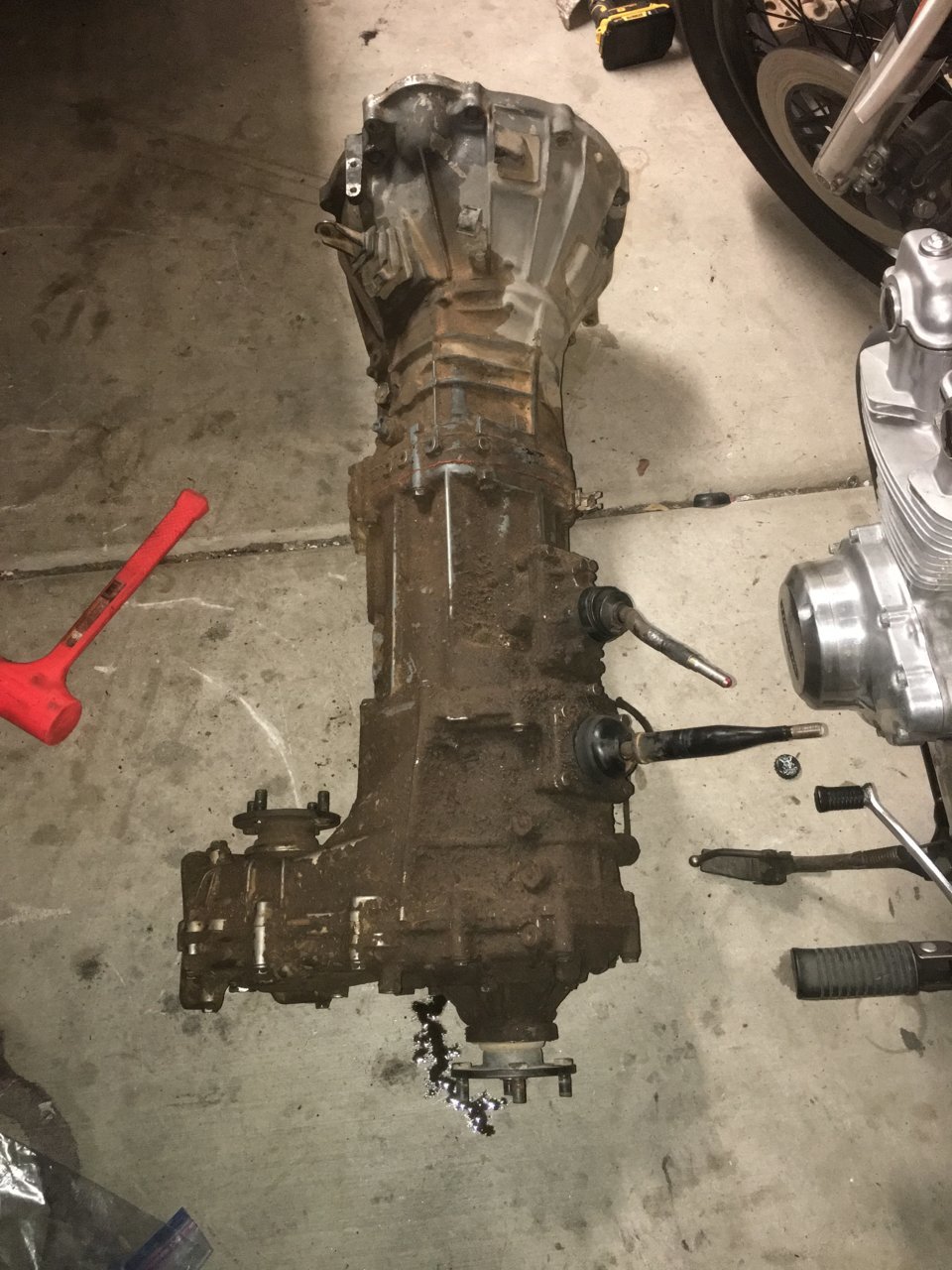

    Pulled my transmission last night. Sending it off to get rebuilt tomorrow. Going to pull my front diff and replace my fuel filter next.

    Why you messing with the diff, new gears? :confused:

    It was a challenge, but well worth the savings, not to mention the knowledge I gained.

    It has a bad leak, and I just want everything up to spec. Also, the owners before didn’t take care of the truck.
