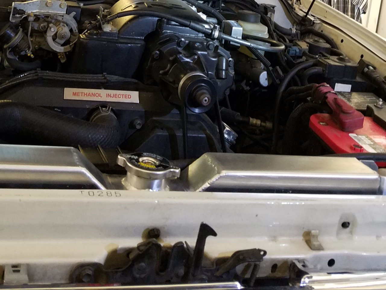

    No,
    The guy that made my radiator did a fantastic job and made it in under 5 days.
    But I’m not going to promote him because he gave me a quote for the job and when it was finished
    the price was 230.00 more.

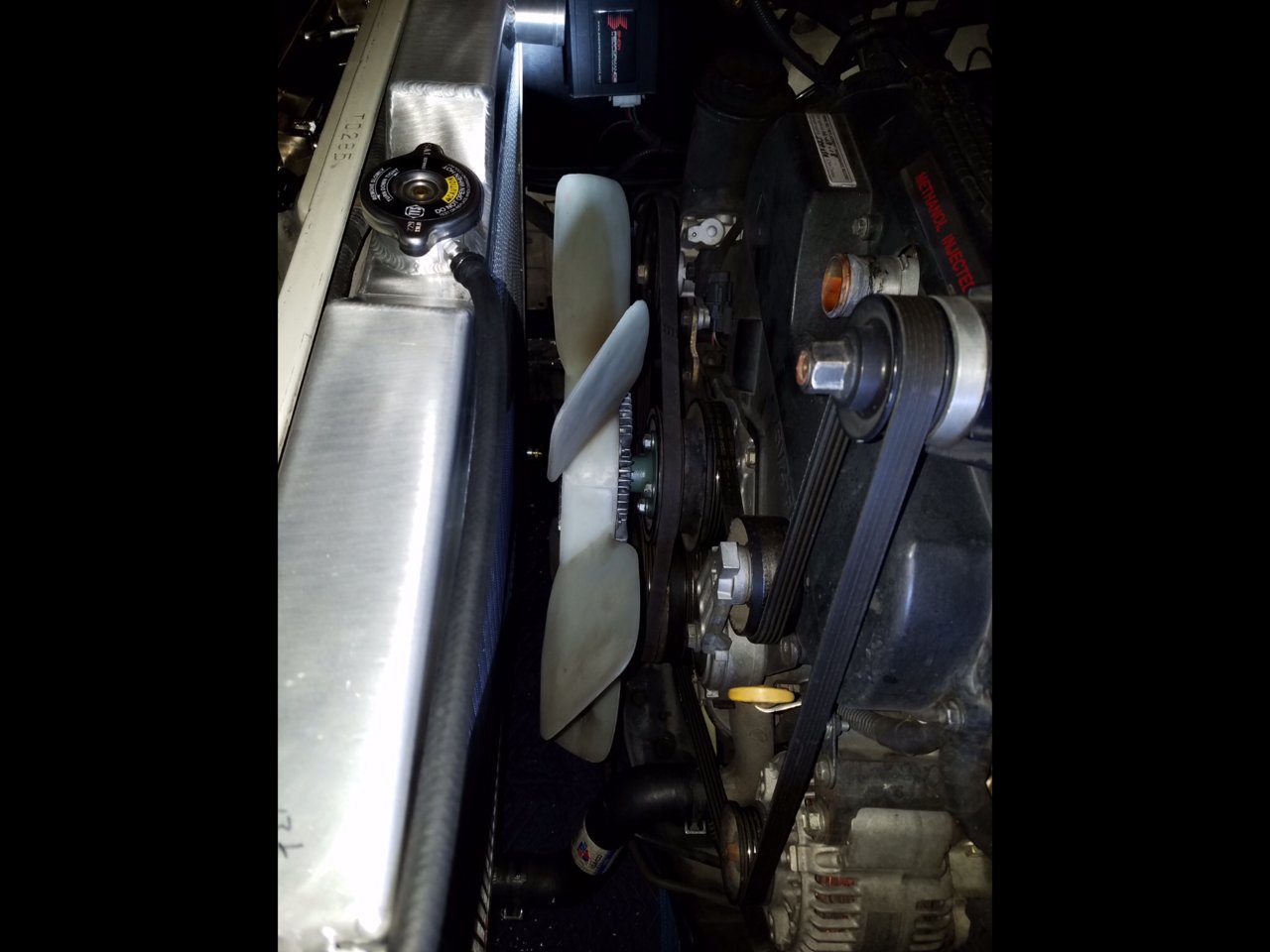

    Also he put the radiator cap section in the center instead of to the left side and because of that it hit the hood so I had to send it back and have the center section lowered so now the cap
    is lower than the top of the radiator and is a pain to try and fill and have no air bubbles in the system.
    I have to fill it from the heater hose with a T fitting.

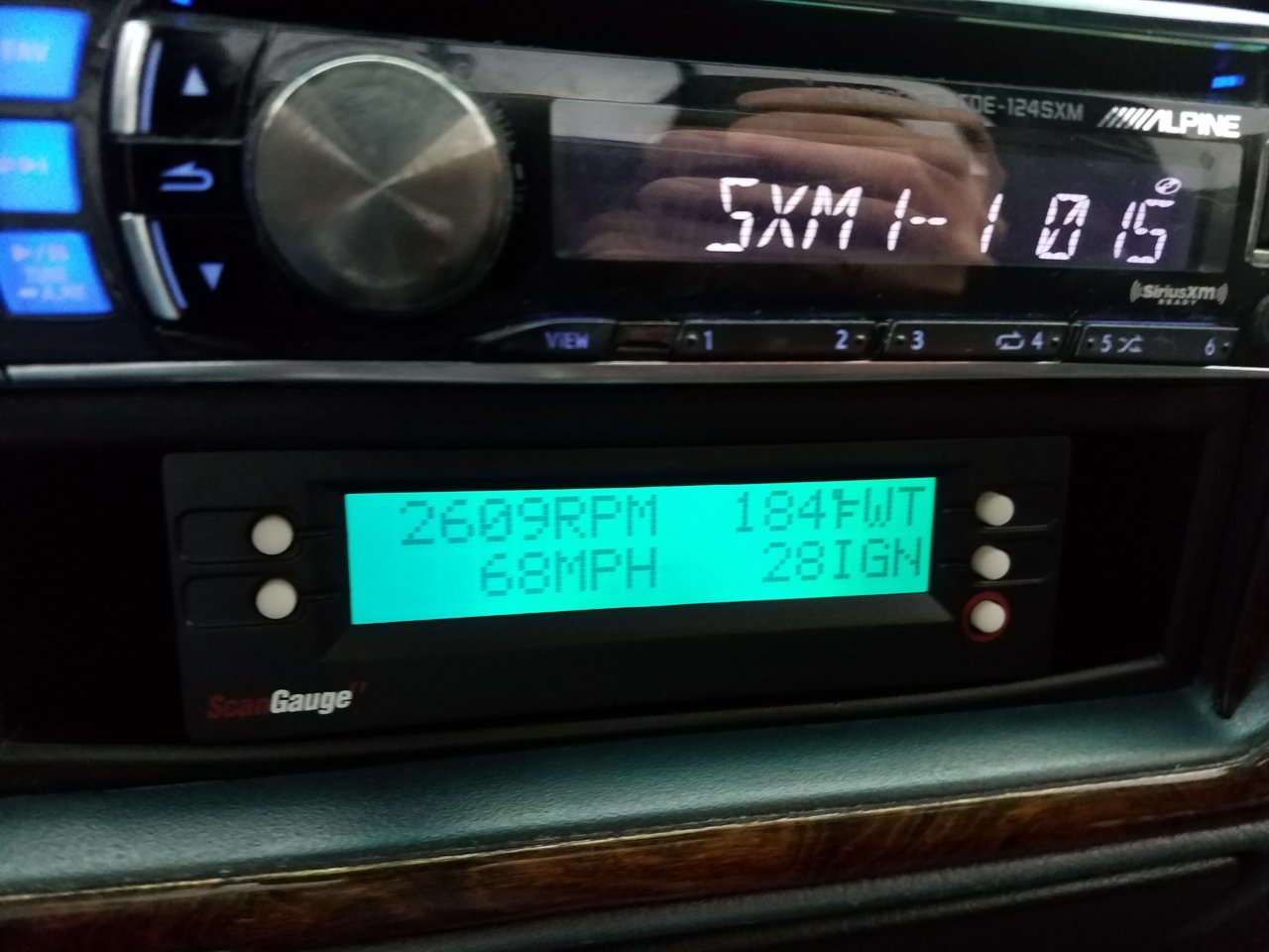

    Overall I’m very happy tho, the radiator is built like a tank at 35 pounds of aluminum compared to the Champion at 15 pounds, stock at 10 pounds and my temperatures are running
    at 184-186 degrees with outside temperatures at 80 degrees yesterday.

    I've seen the cap issue happen with Mishomoto radiators on other cars.

    Well that will definitely not be an issue here lol

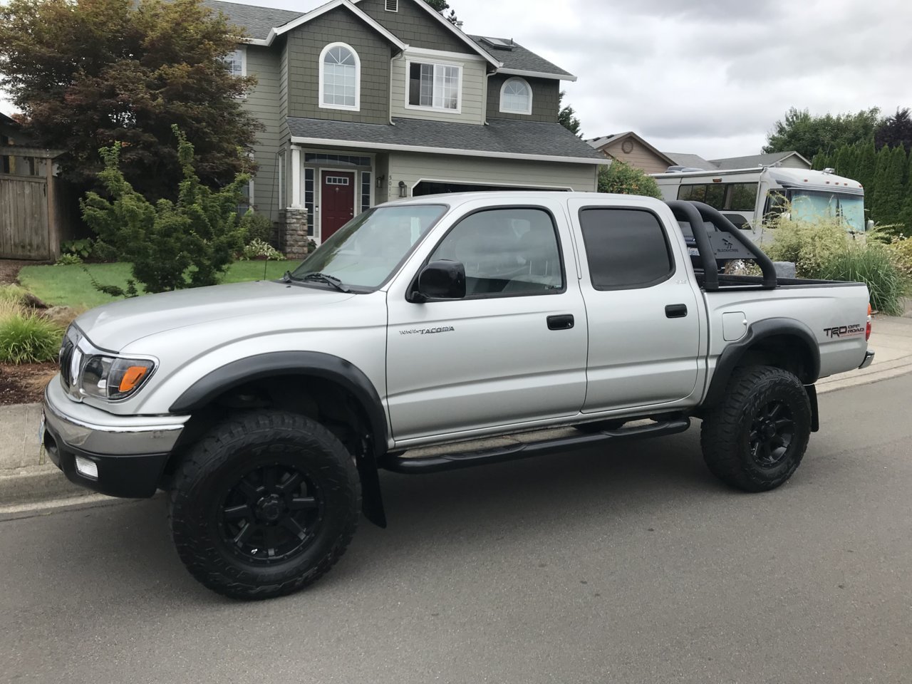

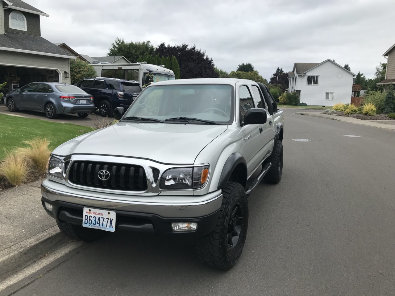

    Black Horse Off Road Roll Bar RB003BK
    Roast me guys, the mounting panel is two inches too wide, the top is two inches too short. I still like it old school. Sprucing up the 2003 to go for another 107K miles.

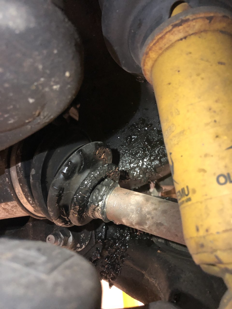

    Changed oil/filter, lubed drive shaft, and rotated tires. After finding cv boot is busted. At least it’s parts store lifetime warranty, just hate changing them :annoyed:
