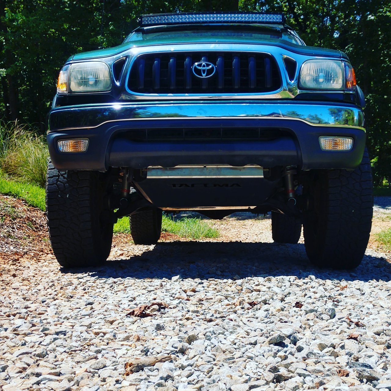

    IMG_20190819_170844_166.jpg installed new skid plate..then hit the Georgia Traverse.. Thanks Ethan !!

    Is that one of the skids that 22rethan sells on here? Looks good, I was close to buying one a couple years ago but came across a good deal on a Budbuilt set locally

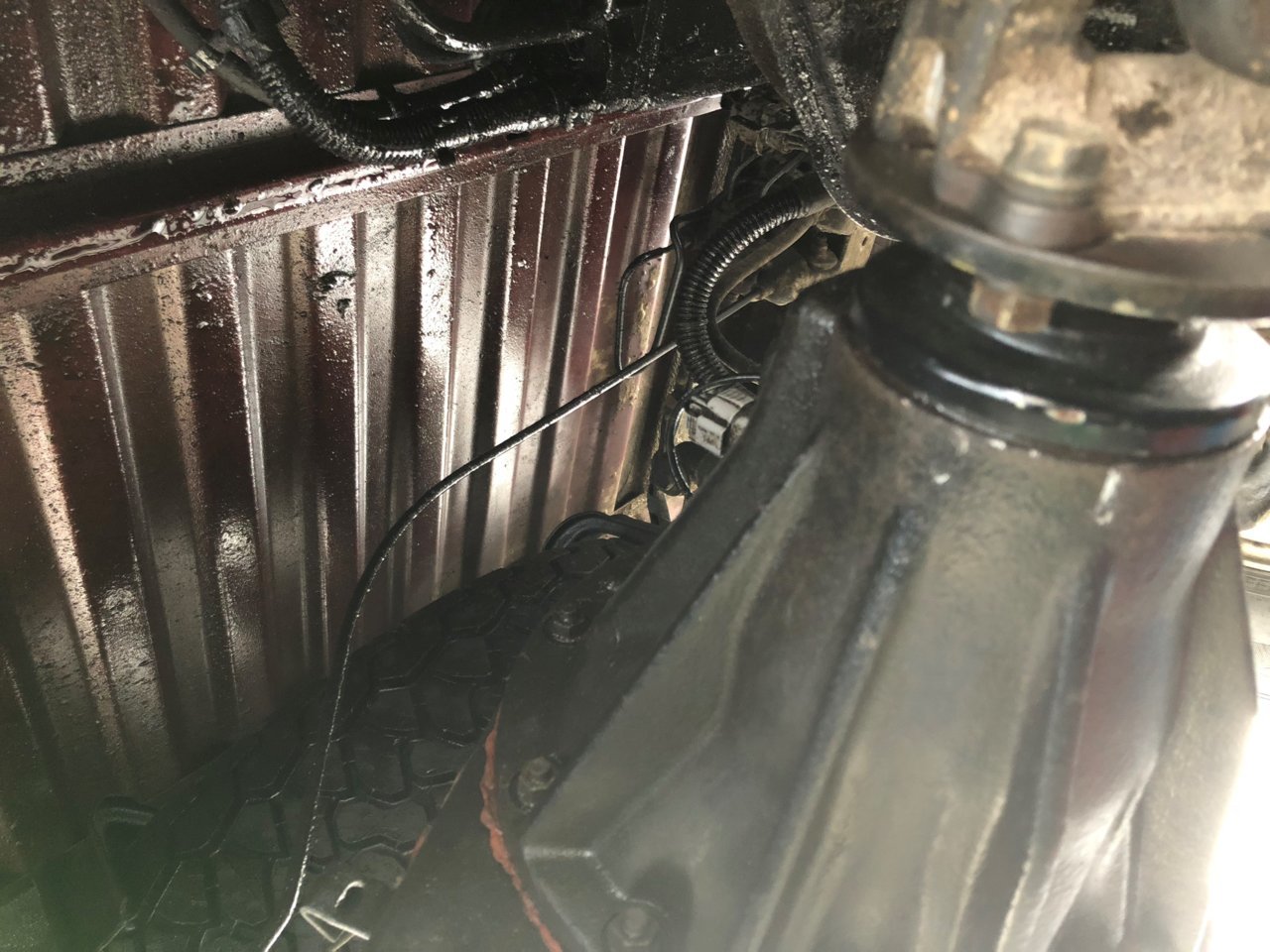

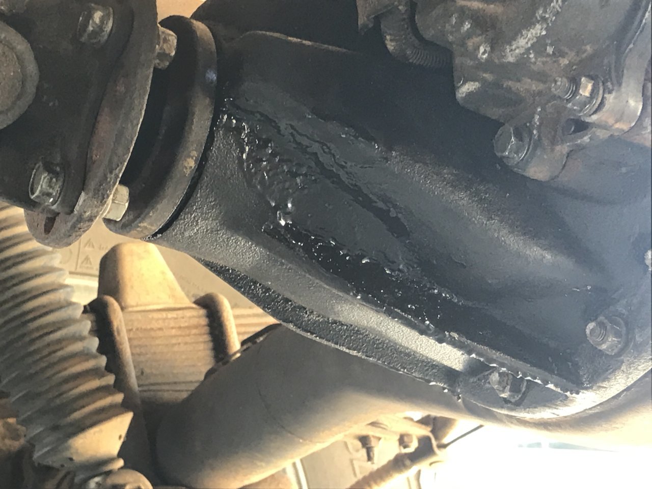

    @ThunderOne I had the same problem for awhile, turned out that i wore a grove into the yoke from where the seal rides( if my nomenclature is correct ).
    slung oil all around the undercarriage. I also rebuild my re-end not to long ago due to a whine i was experiencing on decel, it was my inner pinion bearing. But i replaced both inner and outer. I'd also check the mesh of your new gears, i usually just use a bit of anti-seize on ring and check the pattern to make sure it looks right.

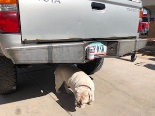

    IMG_0783.jpg New CBI rear bumper kit...

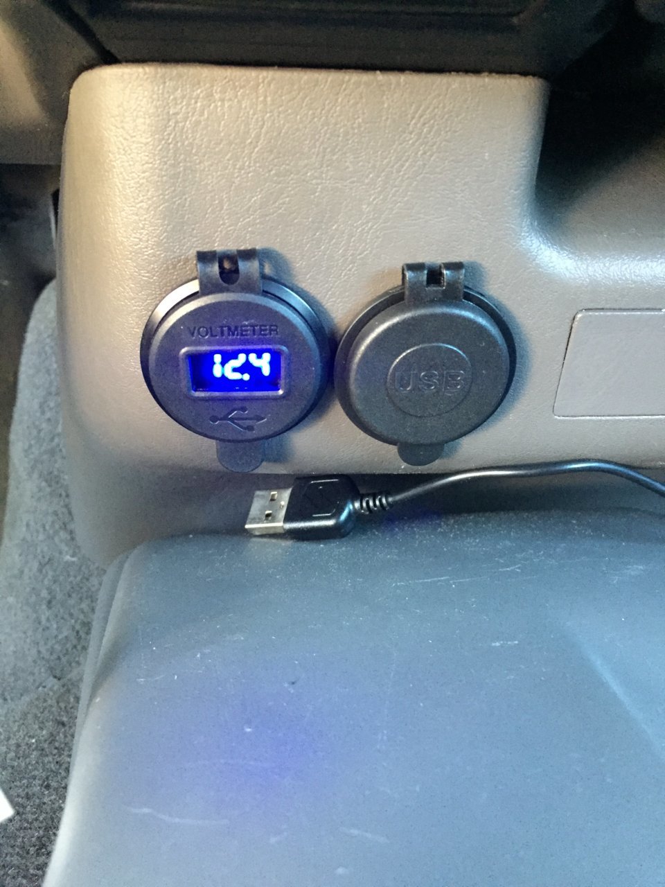

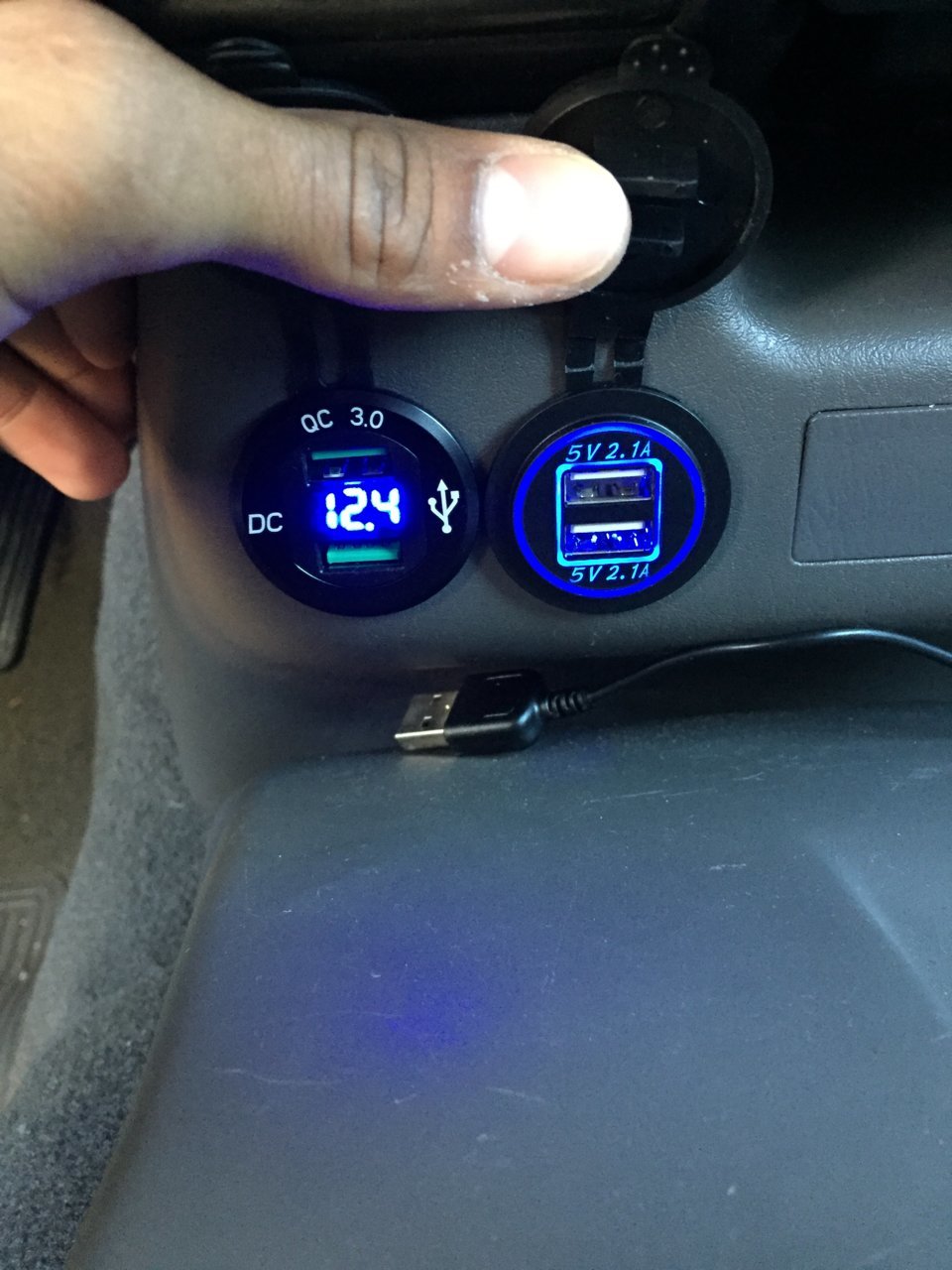

    A4C5D0DD-FC29-4F3B-97F9-2DF52CEEAD26.jpg 4D14314A-72BB-4CBC-954F-AE3BD1417263.jpg Replaced the two power sockets with USB ports

    I have the same one on the left but in orange. Wont charge my phone, says its too slow. I use it to run a dashcam instead.

    I’ve used it for a day so far and haven’t had an issue, I guess time will tell.

    What’s the point of the voltage readout? I’m going to wire one direct to the battery so I can charge a phone but I don’t want a screen on all the time. A lot of them have the display now.
