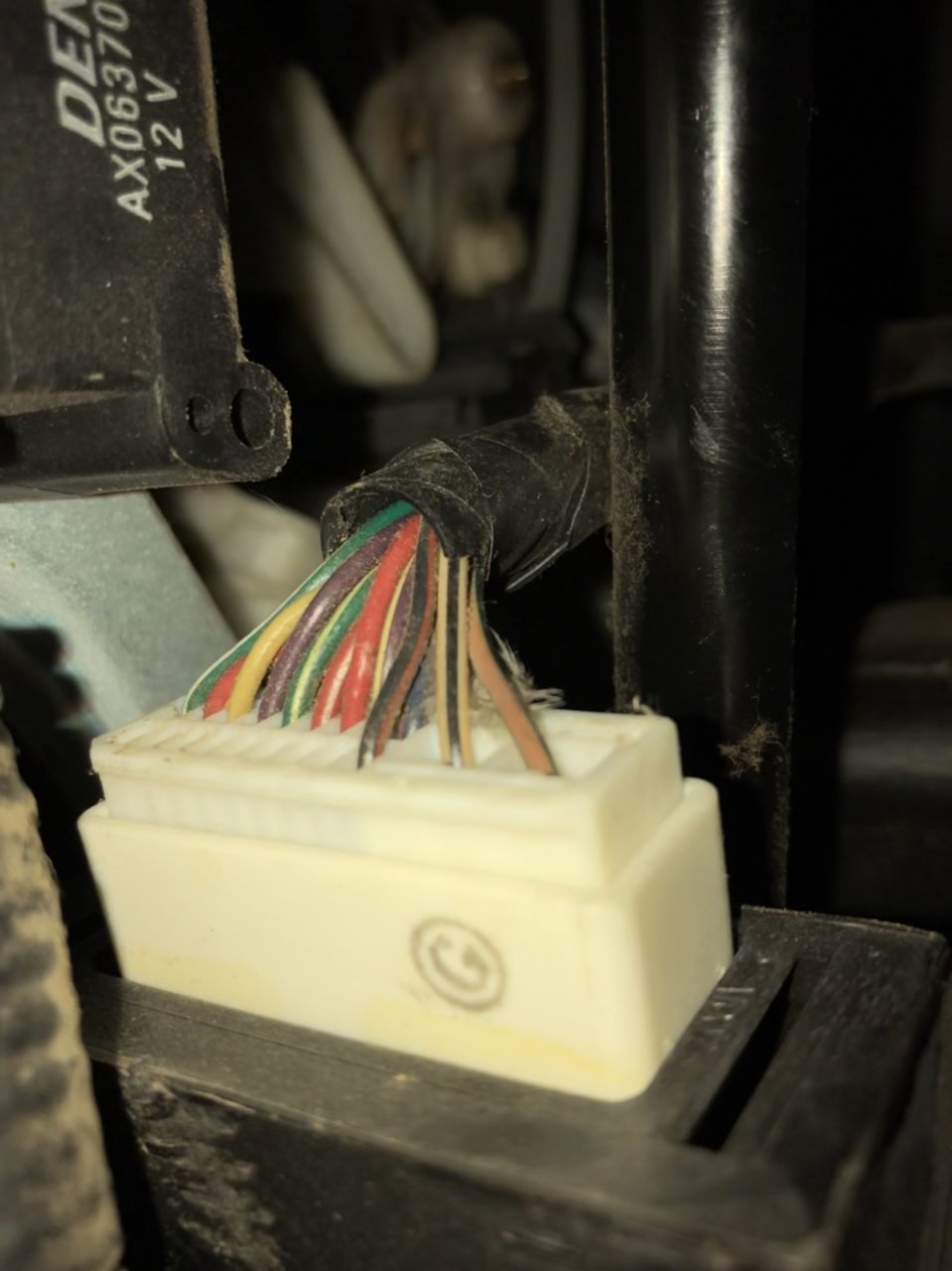

    Alrighty guys, I’ve searched and found little more than confusion on this topic. I need help from the pros here. I have a 2003 that I want to delete my day time running lights. Anyone know exactly which wire to cut for sure? Anyone have access to the wiring schematic for the ‘03 DRL relay. This is what I have under the dash.

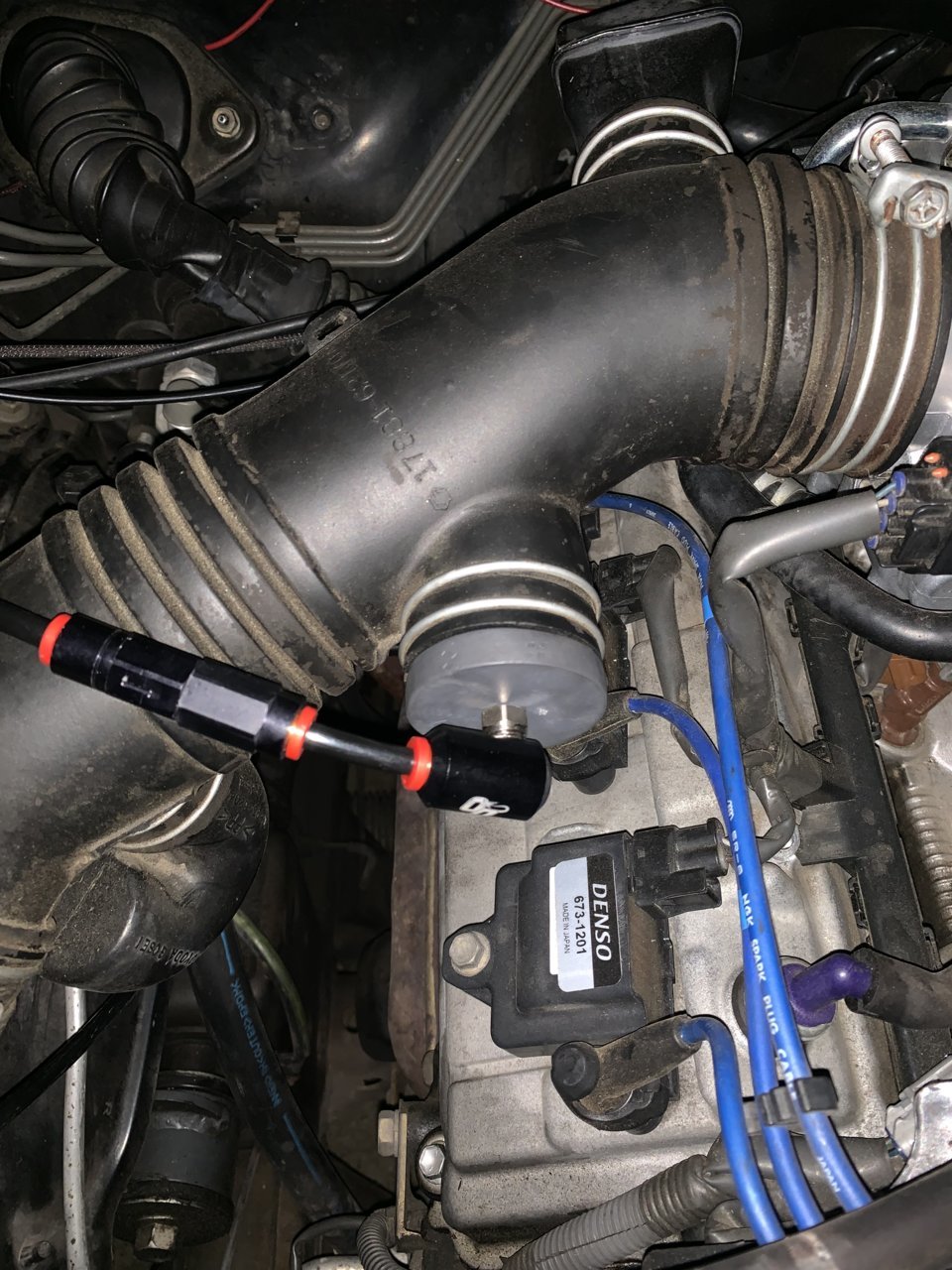

    Was needing a new intake tube to install my meth injection kit in and ended up copying @mechanicjon pretty much exactly lol. Costed me about $70 as the cheapest aluminum tube i could find was $30. Overall I think it looks really clean and was cheaper than all the expensive plastic ones.66C5EB15-056E-406D-807C-697E7735CFCC.jpg

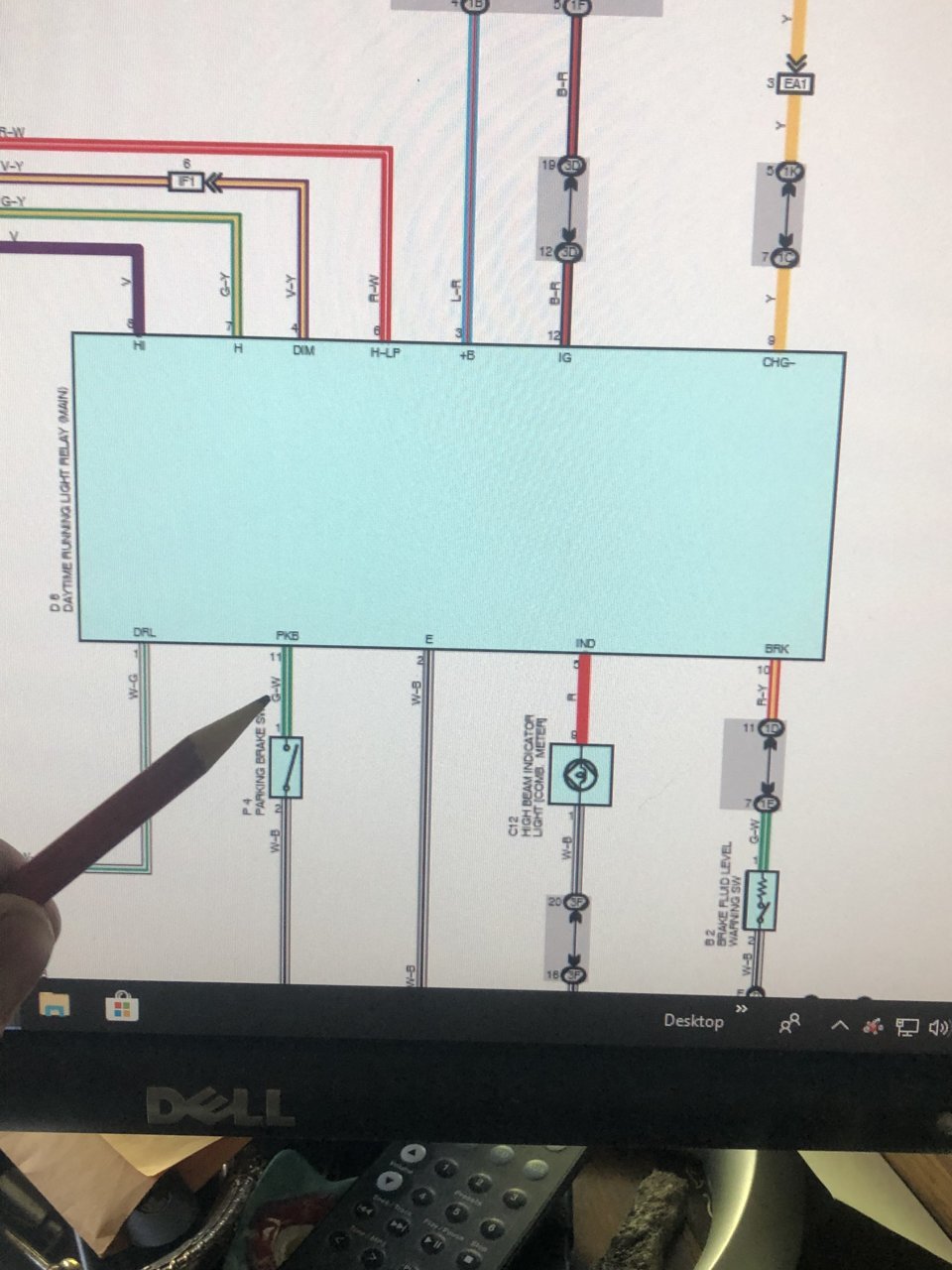

    I got the wiring diagram from TIS. cut the green/white wire. It’s the parking brake switch. I did this with my 2000, but I put a switch in instead of cutting it

    That’s great info. Thank you

    Here’s what I did.

    Ok for those following along, the blow information will not disable DRL on a 2003 Double Cab Tacoma. The information below will instead allow the DRL to be on even when the parking brake in set.
    I’ll take the blame for the error. What I am looking for is which wire to cut to completely disable the DRL. I don’t want them on at all (Parked, In Drive etc.)
