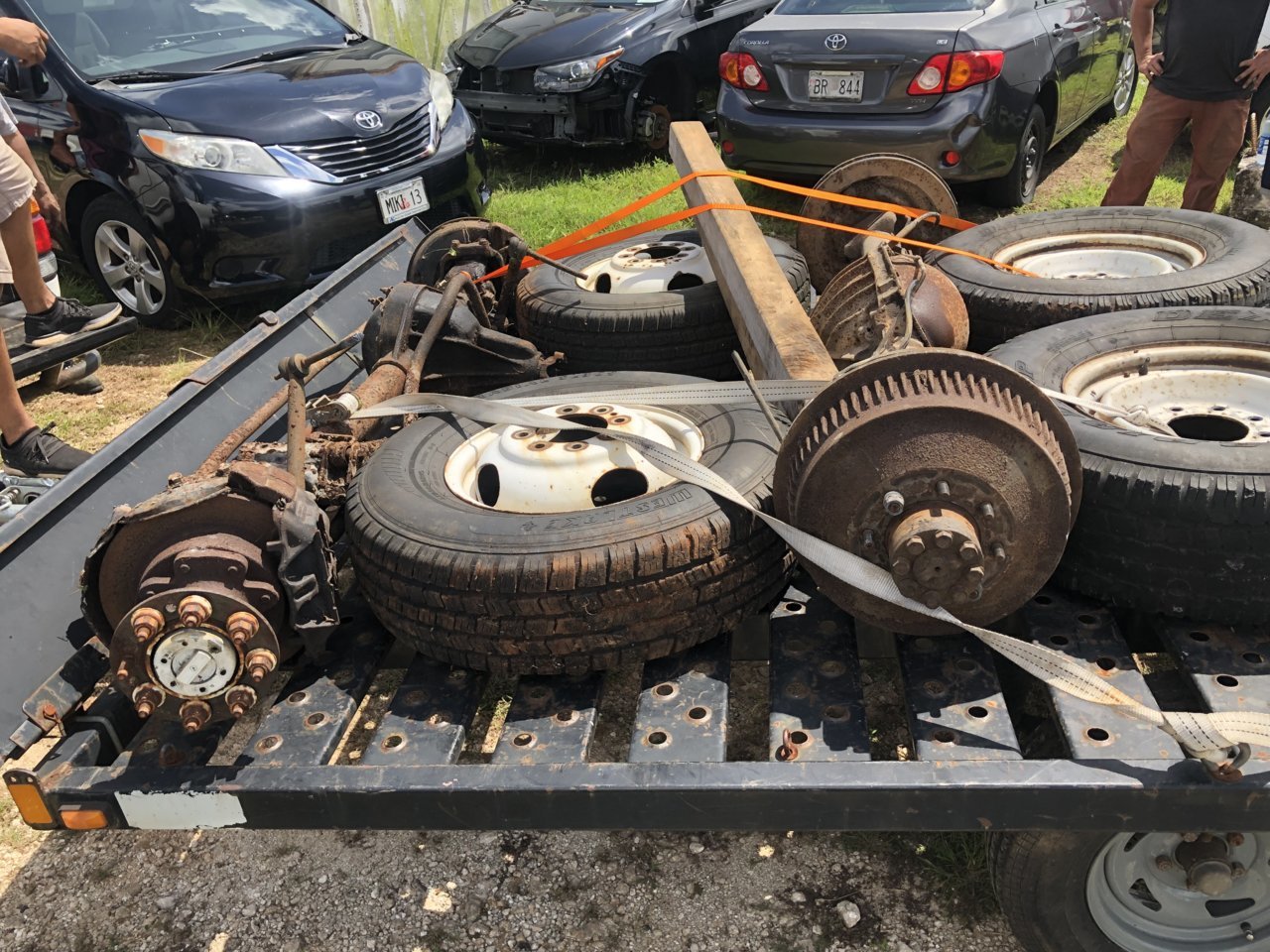

    starting over from scratch
    Picked up some junk :notsure:

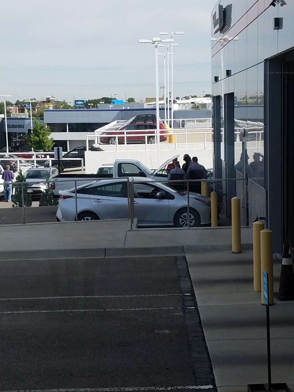

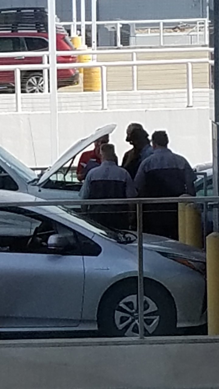

    Just ANOTHER oil change today.
    But was Free as a I passed the 600k mark
    as 5 Toyota tech's inspect the truck:)

    i have gotten that crowd a couple times locally lol
    standing around the old geezer midwest truck that is about as old or older than some of the techs that may have never seen the old style pickup up close and personal
    its too bad the service in my area is VERY subpar and lacking
    ... what sort of reaction did you get from that new radiator?

    They're all trying to decide who gets to take it for a joy ride next time you bring it in ;)

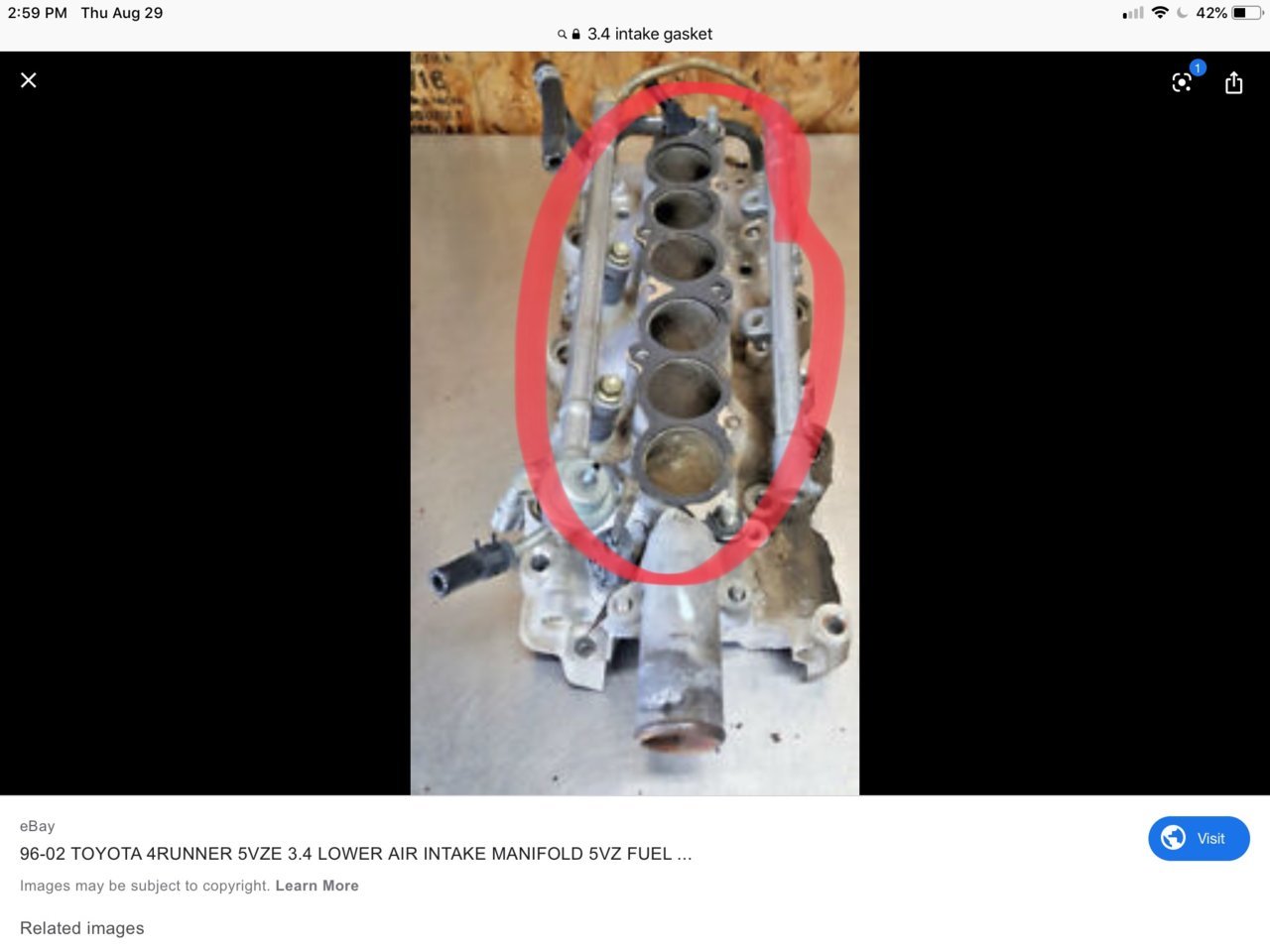

    Does anybody know if the head to lower intake manifold gaskets are reusable?

    I would only reuse them if they were installed very recently. Otherwise, getting new is cheap insurance against leaks.

    Any pitting on the head around the coolant ports?

    No idea, I don’t have anything apart yet. Just going to hold off on the project and get all the parts I may need.

    The top gasket is for sure reusable

    The metal gaskets can be reused a few times. Unless their rusting
