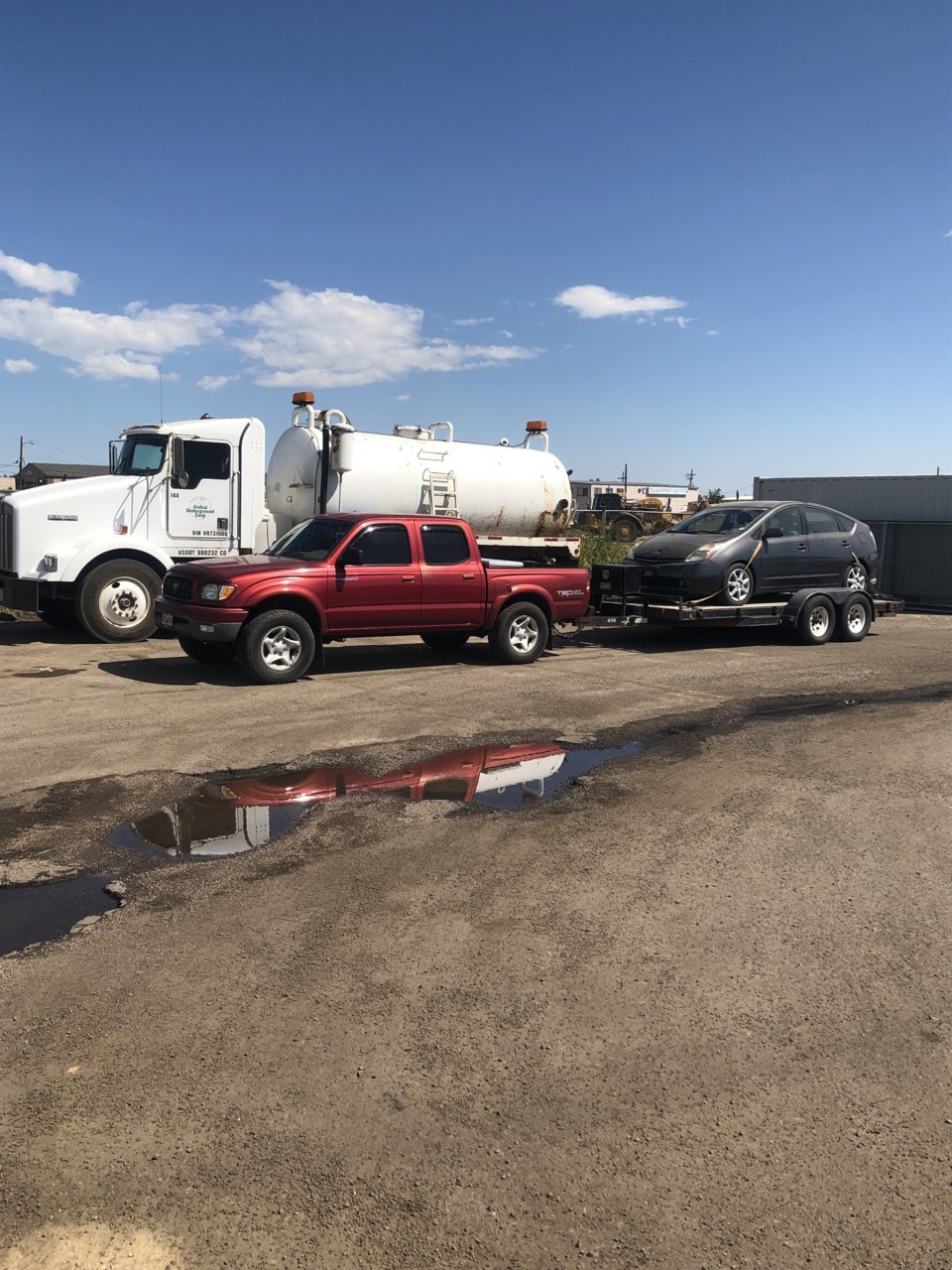

    Towed it to my aunts house. Need to fix it so I can sell it. My boss told me I needed to get it out of the back lot at my dealer before construction starts

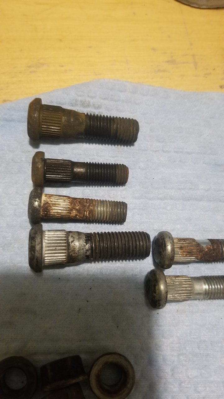

    Not exactly, I just did a bunch of work on mine. I don't live near salt water at all l, and wash the truck religiously. These aftermarket plated studs are from the hub to housing and wheel studs. I just wanted to show the
    difference in what you pay for. You can see the cad plated ones have flatter threads and more rust and corrosion. They are newer then the factory black ones.

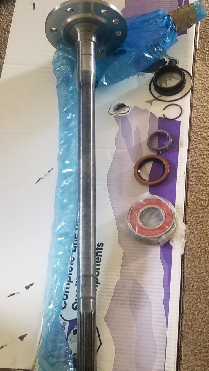

    I was doing this, thats why I discovered it.

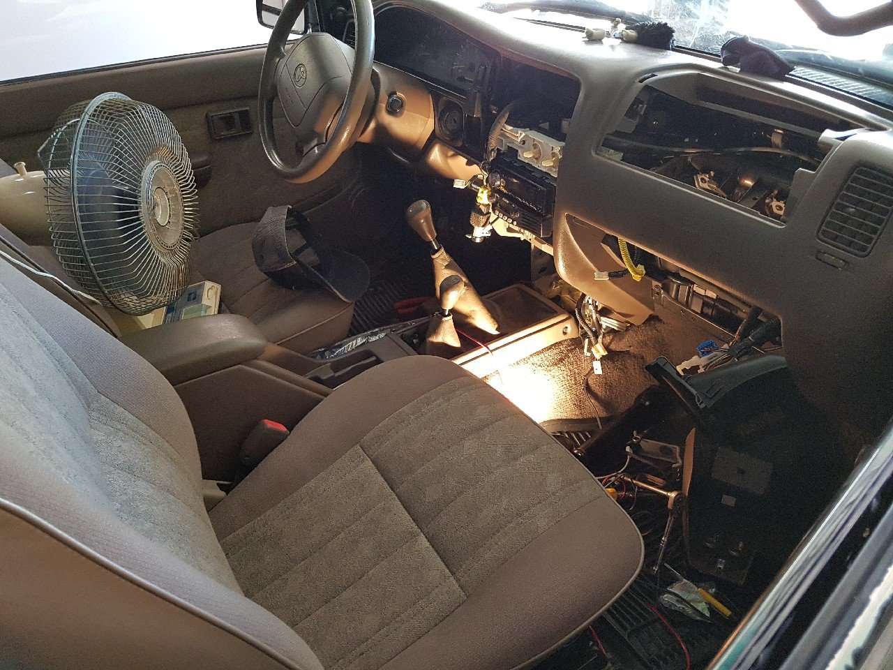

    Looking for a place for an amplifier to go with the new speakers. :)

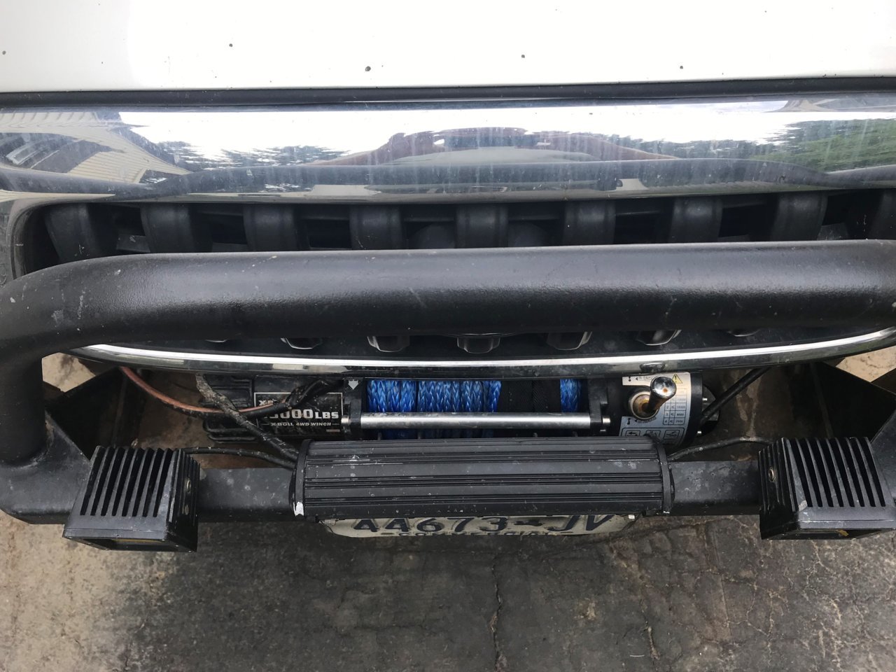

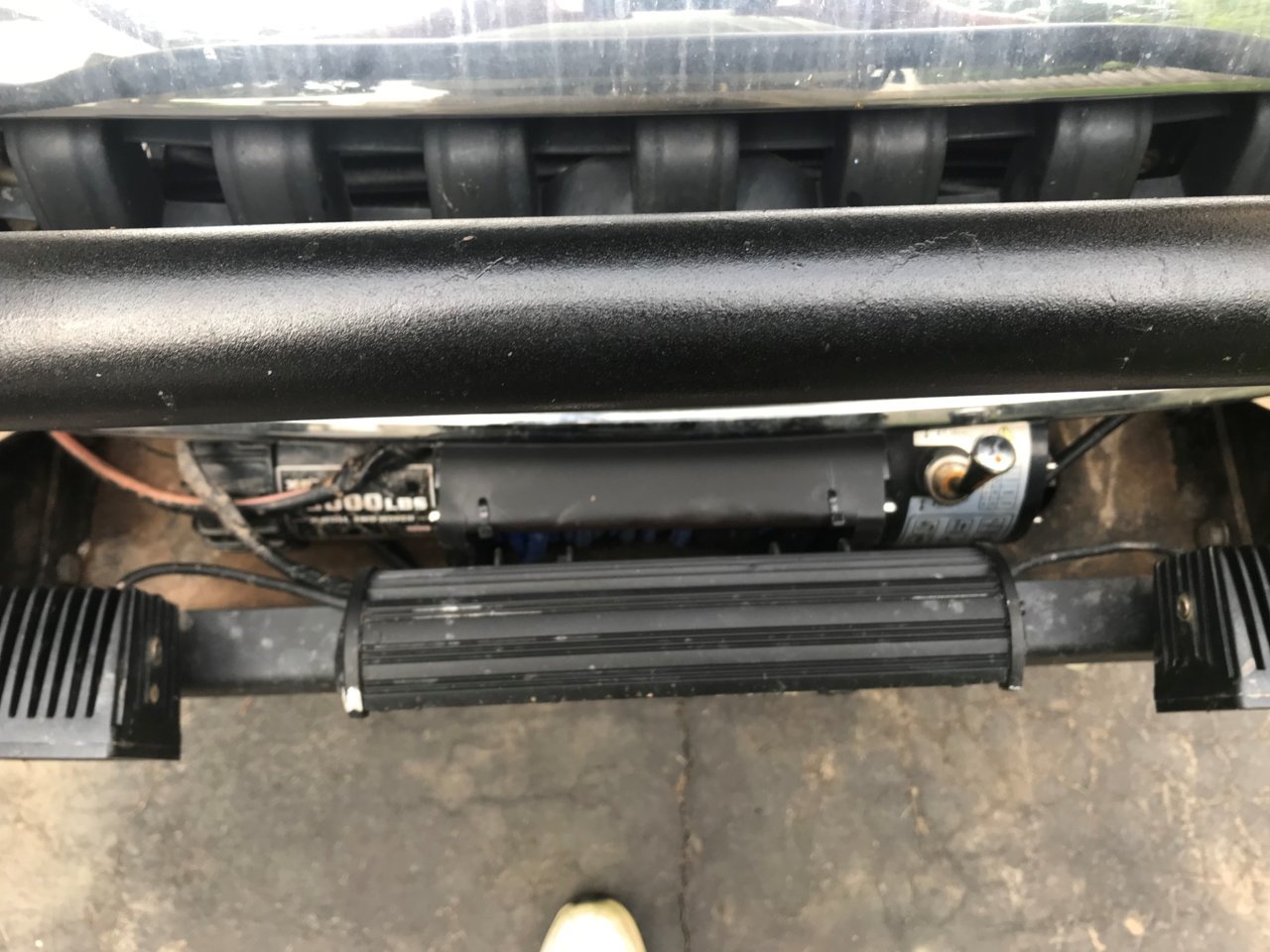

    ……...First of two minor projects today. I built a little panel for the top of my winch to keep the sun from fading/weakening the synthetic line. Used a 10 inch x approx. 8 piece of aluminum flashing. Ten inch was just enough to span across the top of the winch. I cut 3/4 x 1 notches on each corner to allow me to wrap/roll the ends around the rods on the top of the winch. Fastened it all with four zip ties.
    Before:
    After:
