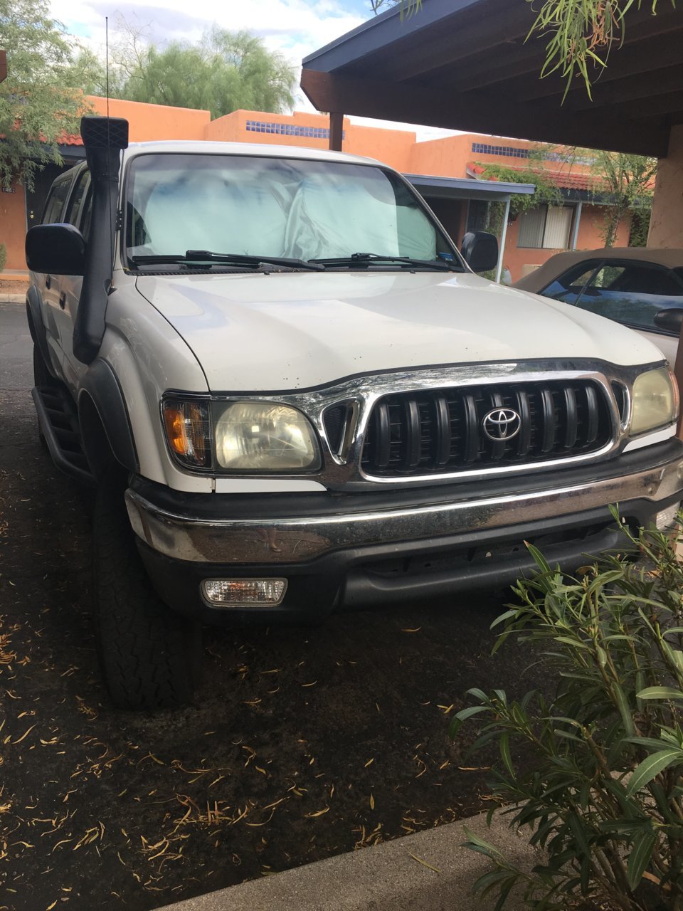

    Going to swap fenders to remove the snorkel from the Prerunner?

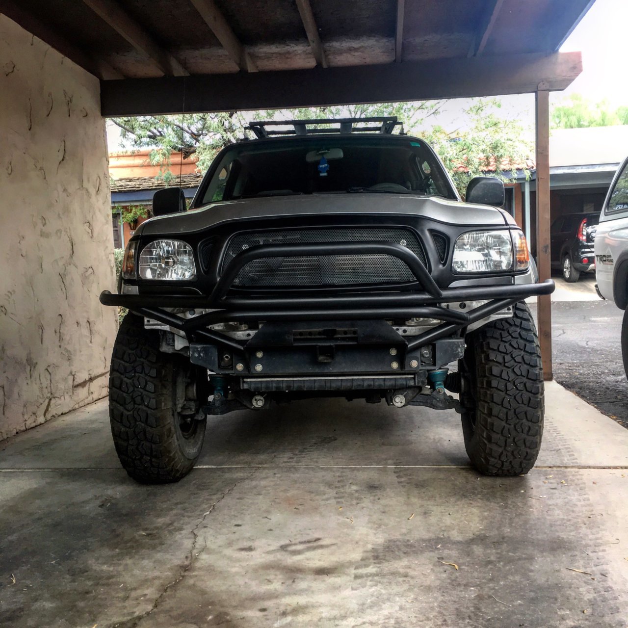

    Nah, too much work. I’d have to plug the a pilar holes as well. It still does it’s job on that truck and the gf likes it and since she drives it now it’ll stay.
    The 4wd truck was in a minor front end collision, so the passenger fender doesn’t line up as well as it should. The prerunner is in great shape inside and out, so I’ll leave it alone

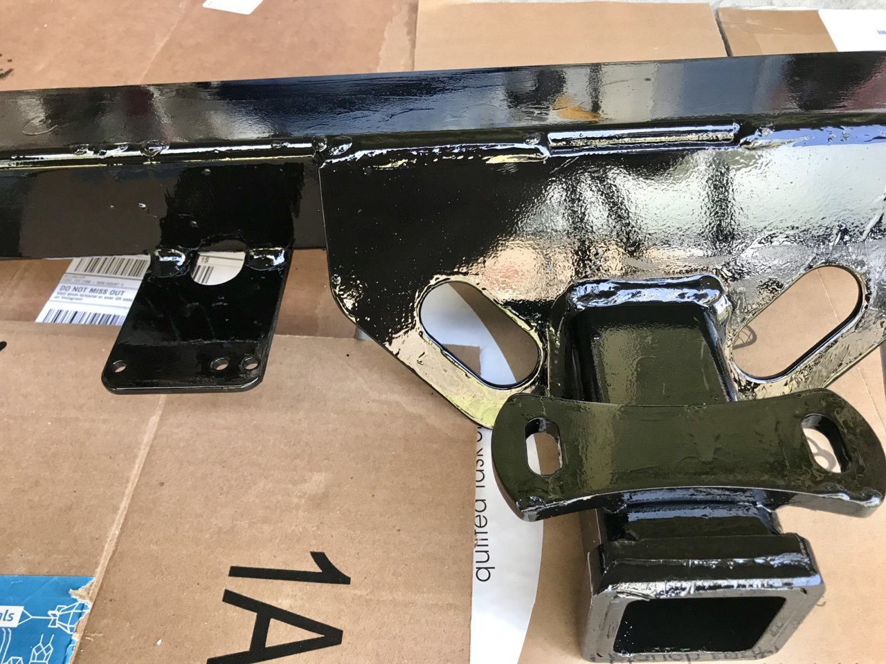

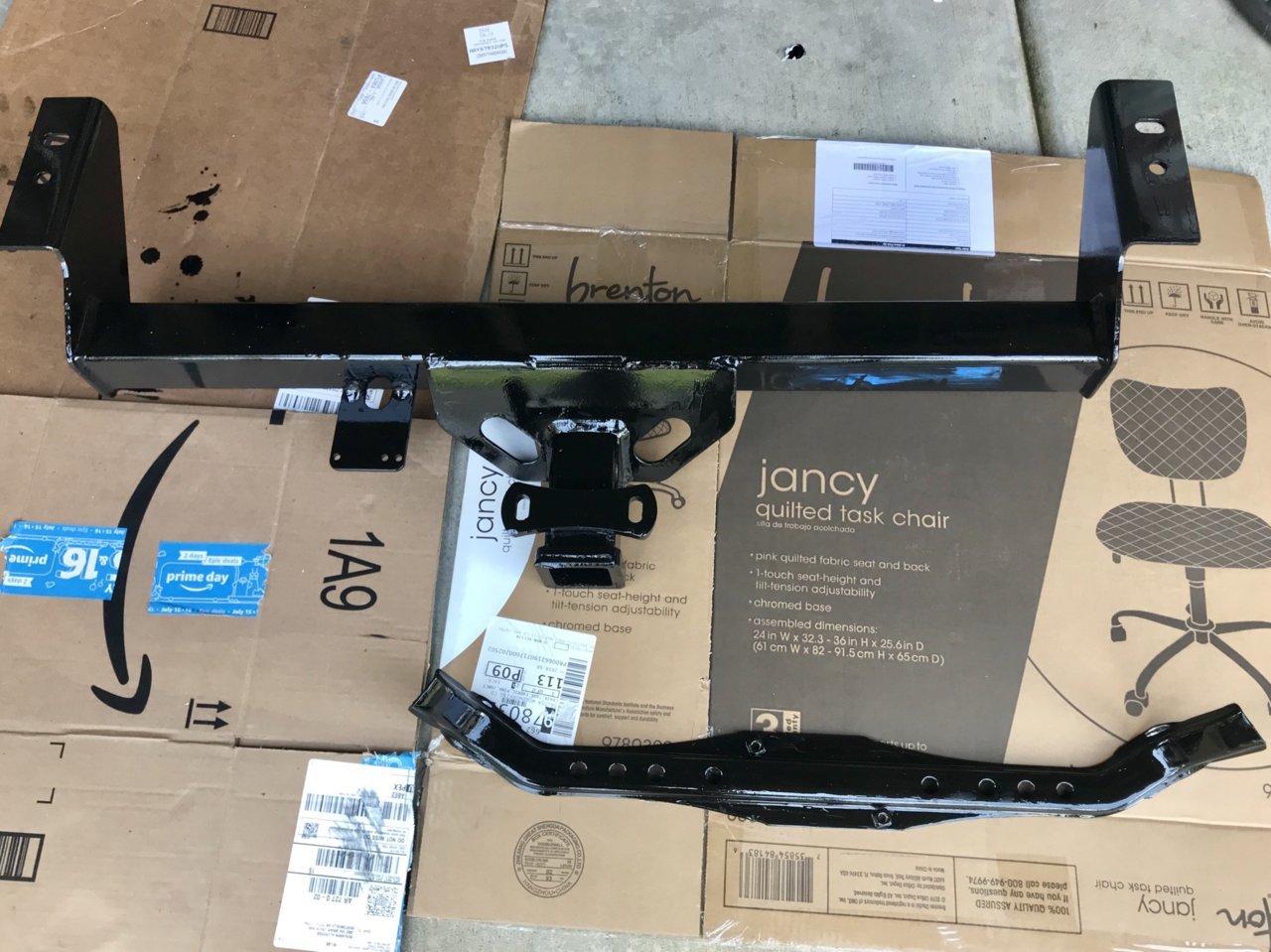

    POR-15 the Reese receiver that came on truck new and the spare tire carrier (other carrier not pictured).

    Por15 gets broken down pretty easily by UV. You’re probably better off with regular paint.

    unless you add that clear coat stuff over it

    Por-15 is a rust inhibitor. It should be covered by paint. Also, I agree with you UV will break down Por-15 quickly(If not covered).

    I’m using the POR-15 Top Coat on the receiver hitch. The spare tire carrier is up under the truck covered by the spare tire so I’m not to worried about it
