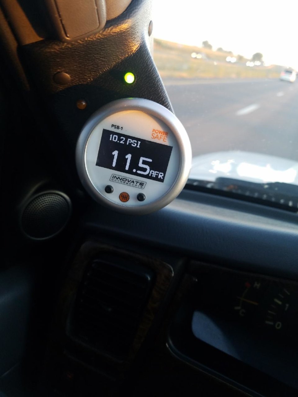

    My AFR are perfect at 11.5 with 10.2 pounds of boost that starts at 4 pounds and goes all the way up.

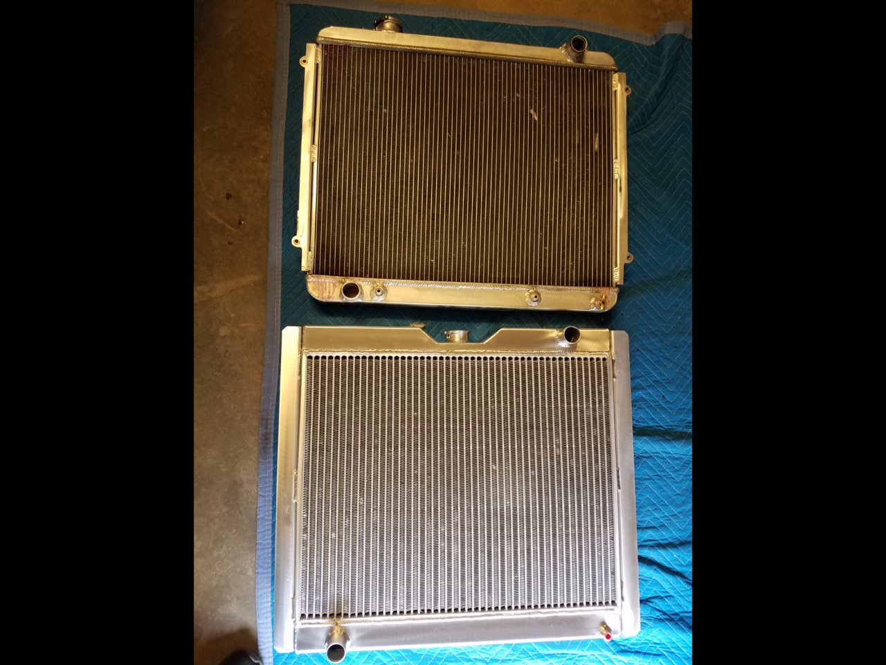

    Are you running a 170 thermostat? I just put one in and now my temps are 175-180 and the engine runs much better, but I do have a better radiator. By getting the engine temp down that means the supercharger temps come down too,

    Yes, I have a 170 with the champ radiator. It runs 180-185 when it’s below 90 degrees or so. When it’s above 95, everything suffers. trans, AC, and engine runs higher and spikes much quicker with load. It runs 185-190 when hot, 190 under load. Trans goes up to 200.
    Those numbers aren’t bad at all really. But with the added heat pump the performance suffers. I need to cool that intake off as much as possible.
    It’s also my perception because AC can’t cool the truck on 93* and sunny days. It’s coming out around ~43-45 but it just can’t take the heat out of the air. When it’s cloudy but hot it does better. So I think it’s just the color that’s such a detriment.

    I had a custom one made that’s 3 times the quality than the Champion, so I have no use for the champion now. The new custom is the one on the bottom.
    The champion I’m selling is sealed in the box still
