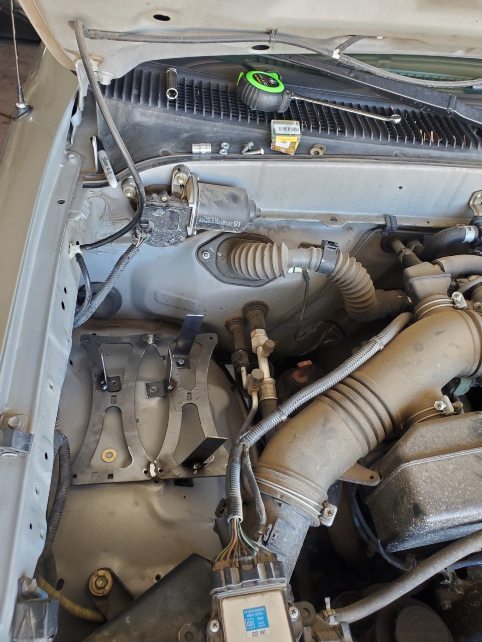

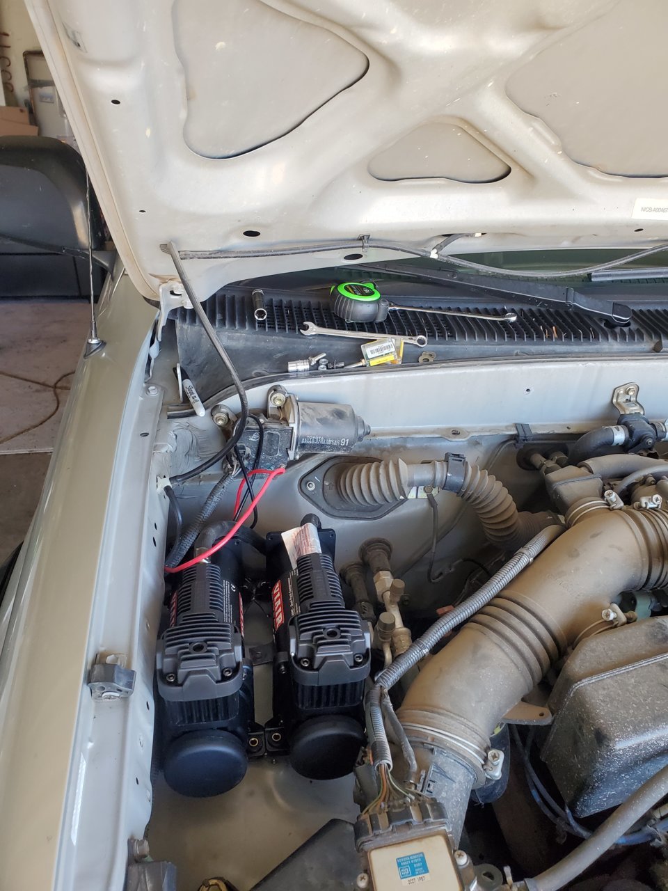

    Figure while I wait for my 3rd members to come in I mount up my dual pumps, overkill but why not. Still waiting for all the other parts to show up. Ordered pumps from AVS in Fresno, the kit they sell comes with a nice set of plasma cut brackets. I just had to make my own mounting tabs.20190921_112549.jpg 20190921_114053.jpg

    How fast are them pumps?

    These are the viair 444c dual pack, specs on viairs website says 0-200psi on a 2.5 gal tank is 2 min 30 sec. I'm gonna run a 3gal tank but regulate it at 120psi max. These pumps are 100% duty cycle at 100psi and 50% at 200psi.
