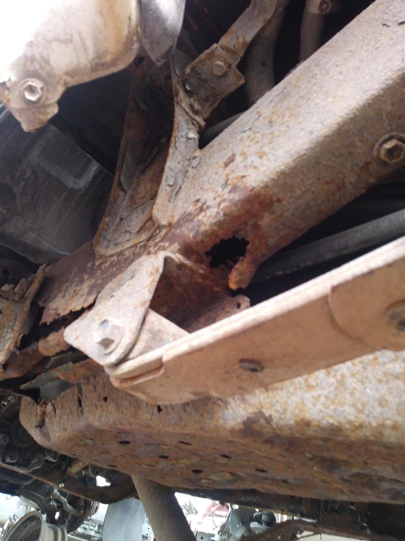

    oh crap, I thought you custom modified your frame to drain better
    is it not this bad yet?
    i am still trying to figure out what exactly is behind this section and why it does this sort of thing and preventative measures to take

    I parked on a slope and put a garden hose in it on the high end. The first time I did it my frame was filled over half way up with dirt and gravel so in addition to the hose I ran a plumbers snake back and forth through it to loosen things up. Worked great.
