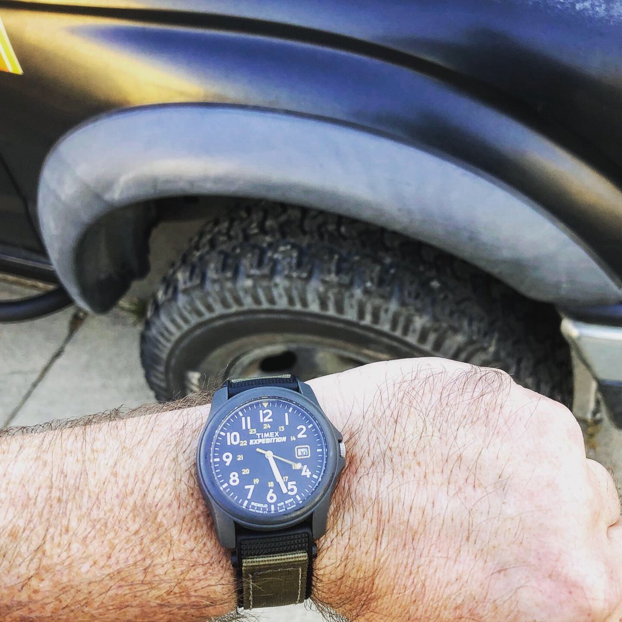

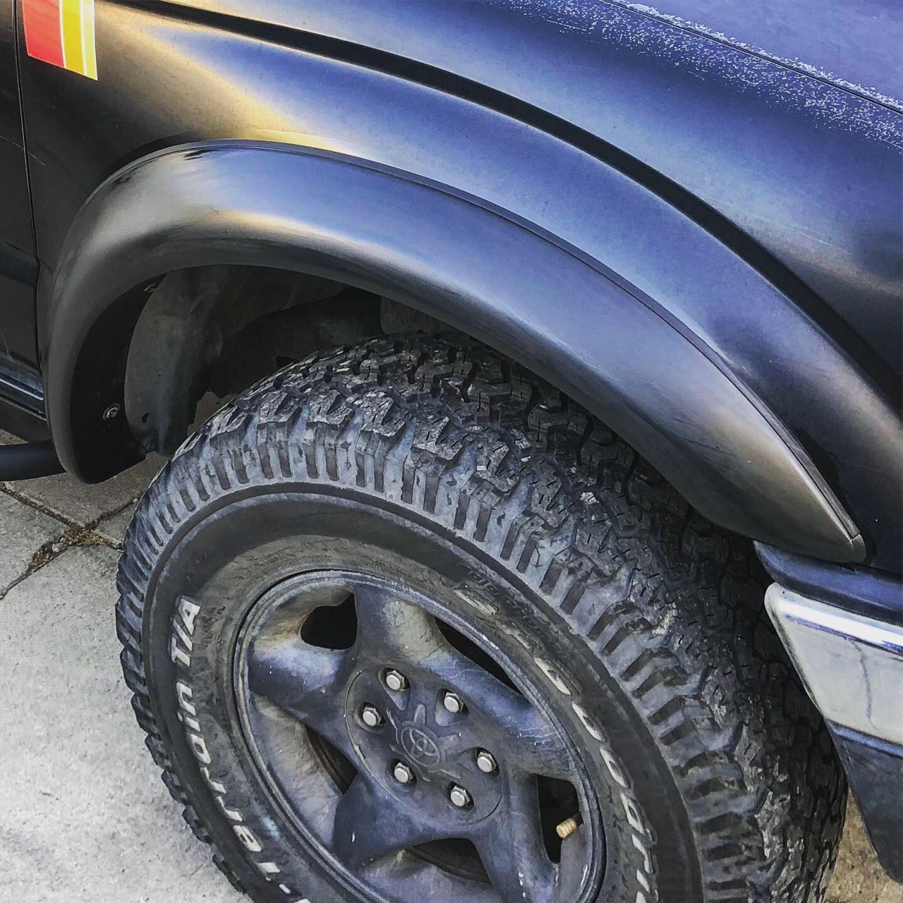

    Hit my plastics with some CERAKOTE TRIM COAT. Holy hell, what a difference. Pretty easy to do, and you get a free buzz (I'm wearing a respirator next time).
    BEFORE:
