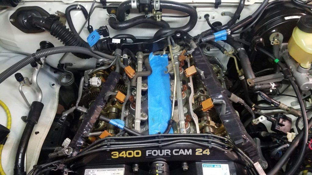

    Yes. They were both in perfect condition and not brittle at all. Regardless, wrapped both during the VC gasket replacement with a high heat silicone tape...

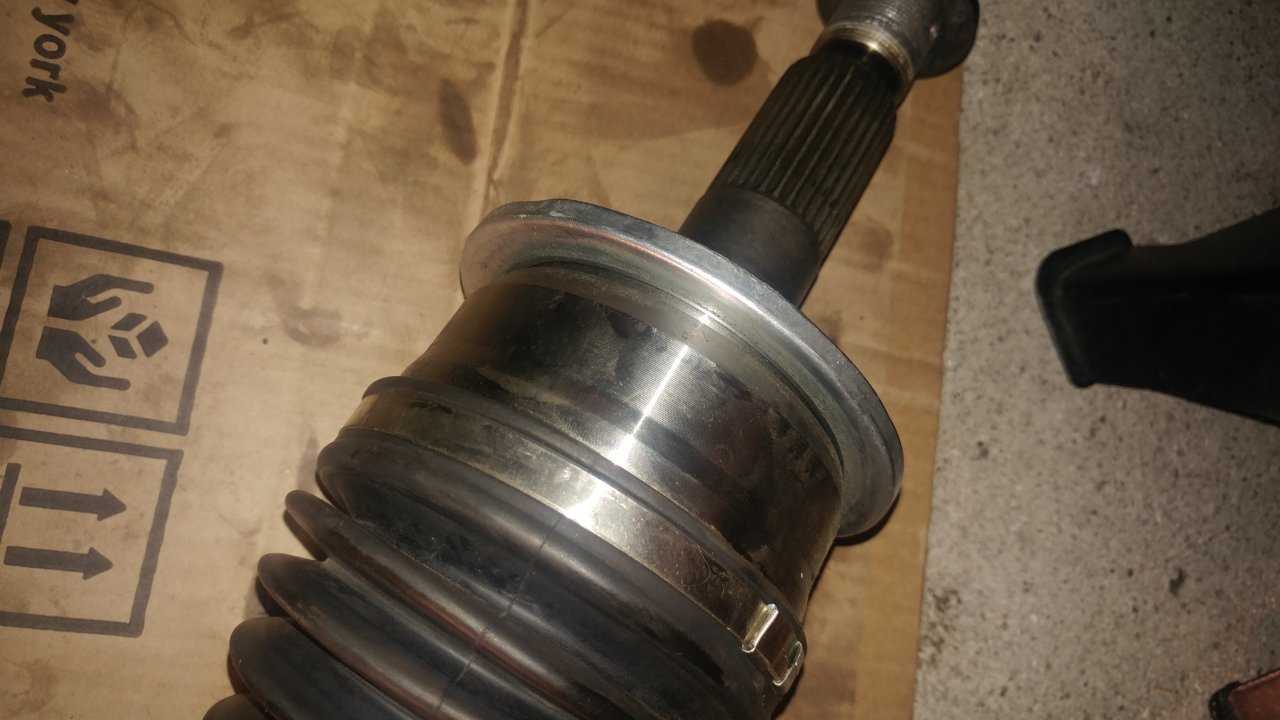

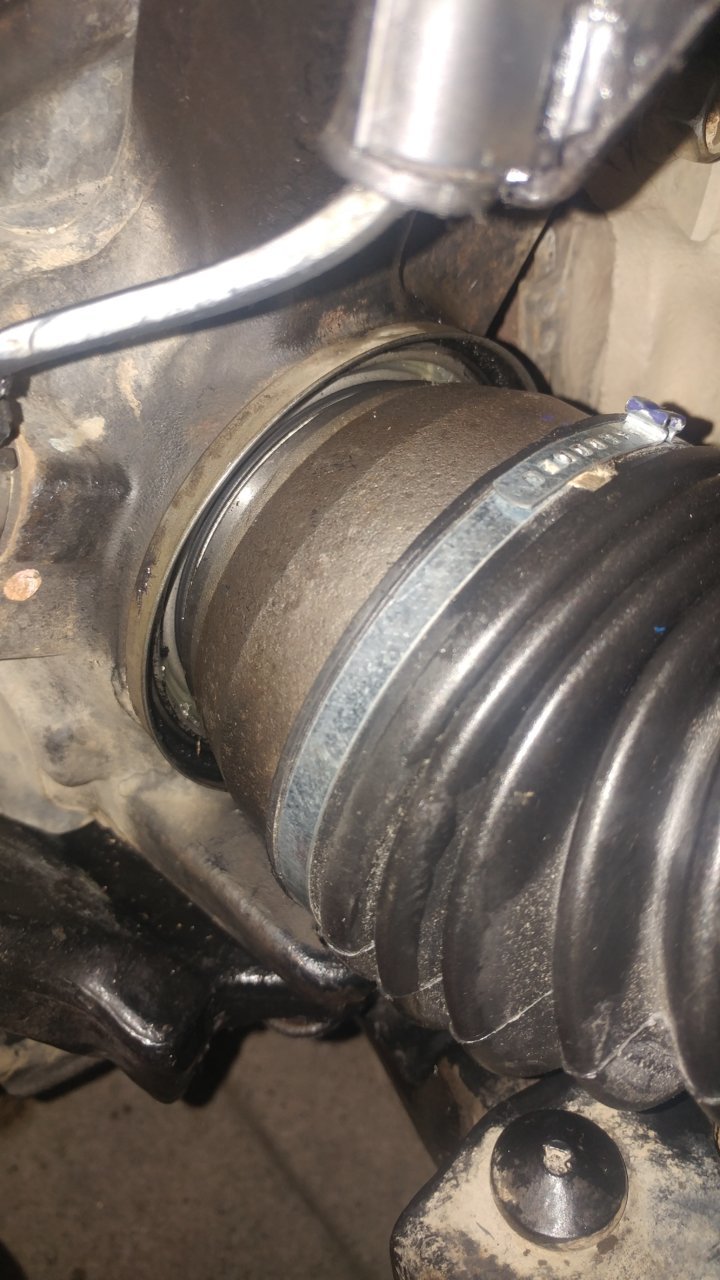

    I just got my Drivers side CV axle in...but looking at it where it meets the back of the spindle it seems like there should be something there to keep dirt and debris from getting into the bearing no? Or does this look correct?
    Edit - looked at the old axle and it looks like the new one is missing the shield that should be on the end...good ol O'Reilleys.

    You going to take it off and return it?

    Yeah I've got no choice really...you can see the wheel bearing is exposed back there, something tells me if I run it like this I'm going to end up with a much more expensive repair in no time. I just got that wheel bearing replaced last year too.

    Weird, I’ve been through 10 and they’ve never made a mistake there. The axles are shit, but at least they always fit and had everything
    eon_blue[QUOTED] likes this.

    Yeah it looked like it just cones into the spindle no protection to the bearing at all. I know them bears are $80 each and they have to be pressed out to.

    Sucks but yeah nice catch. Those wheel bearings are sensitive enough as is, mud bath wouldn’t be good for em :rofl:
