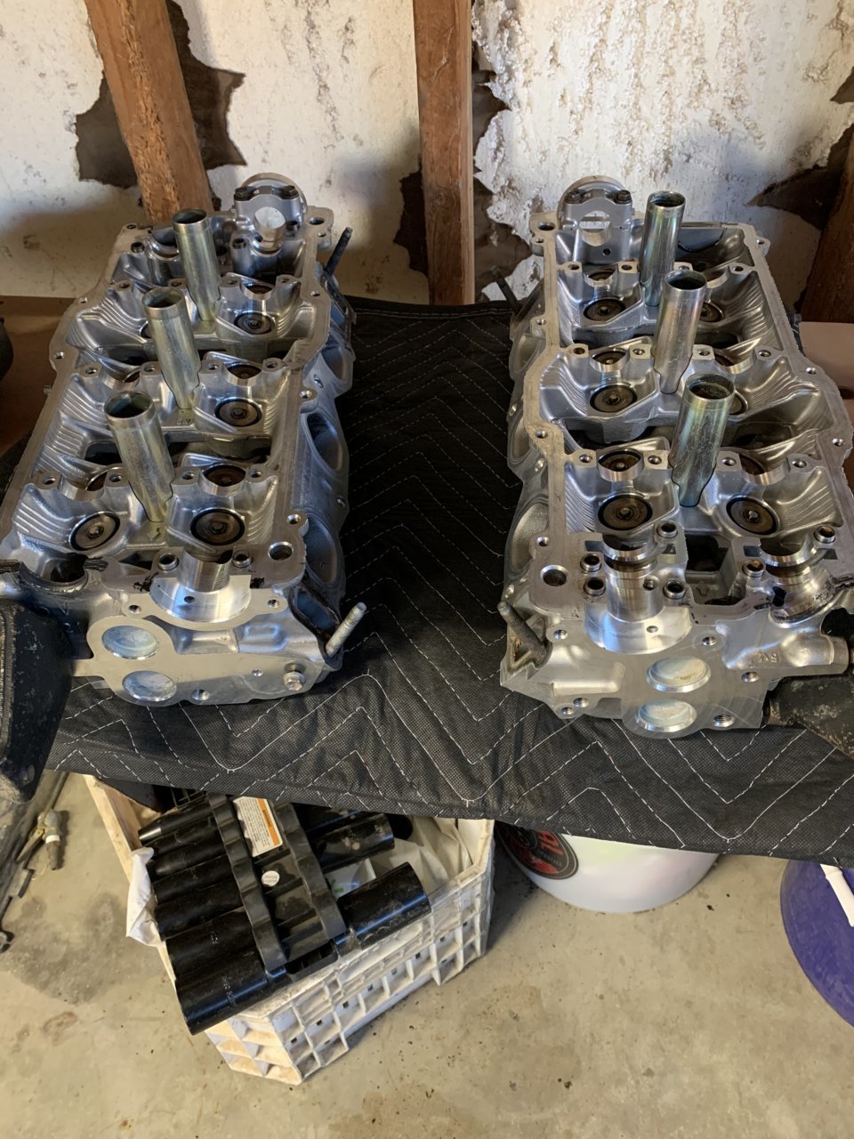

    :drool:All shiny, will start putting back together tomorrow morning 7BA28BBE-AD32-4A55-8530-ECBA0517A83A.jpg

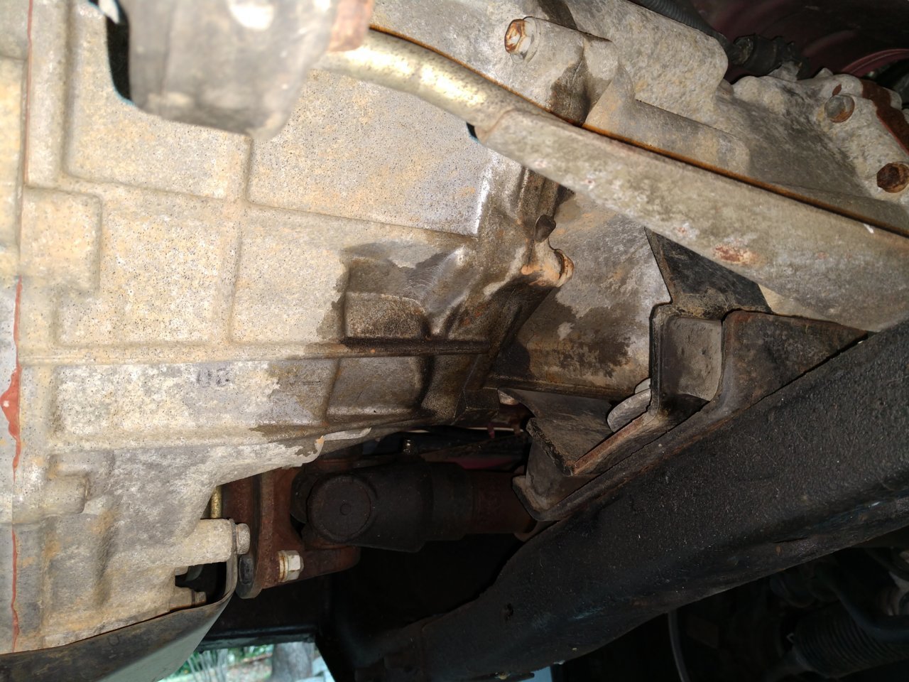

    Being that my frame warranty is up in 11 days, I crawled under and inspected/removed all rust that I could get to. Also shot a can and a half of fluid film in the inside of the frame. Didnt see anything worth bringing up to the dealer, only spot I couldnt get was inside the coil buckets, so I just shot a ton of FF in there. Ill coat the outside of the frame at a later date.
    Also found a new leak. Gonna keep an eye on it, no rush to fix it. IMG_20191005_142557625.jpg
