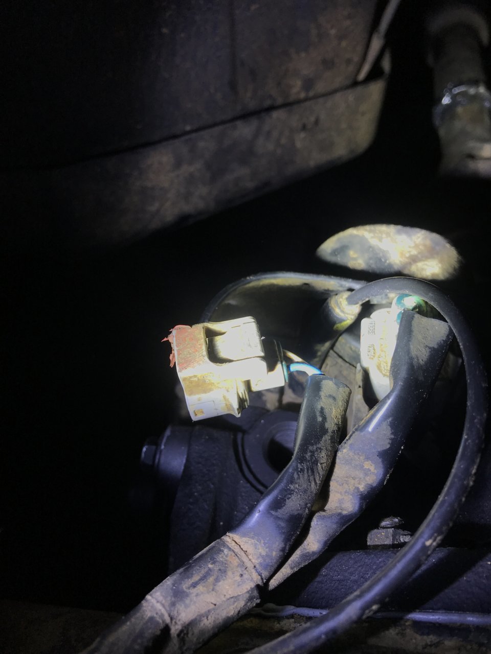

    What size socket is for the thing that plugs into the rear diff (not the housing) for the e locker? And does anyone know a part # for it?
    also, can I drive without it plugged in or will gear oil puke out of the hole?
    notice the hole under the connector where said sensor or doomaflotchy goes (edit, apparently its the rear diff lock indicator switch)
    apparently according to Ih8mud the beck/arnley 201-1788 will work just fine so I'll just get a new one.

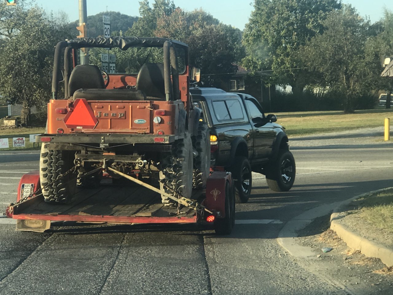

    Tried out my air bag set up today. It’s AMAZING how much difference it made towing. Airbags will always be my first purchase for every truck I buy from now on. Pulled my lifted cj5 with 38 15.50’s and a 360v8 about 50 miles today on curvy, mountain two lane roads. It done surprisely well for a 4 banger. I see a super charger in my near future though. 08CB8D54-F29A-4BE4-8E6B-819DB2B6084D.jpgB46A5AC6-4069-4F9D-B527-66F1061FBF70.jpg F6CC9B6D-0976-41C2-BA9D-DA73293CAF80.jpg

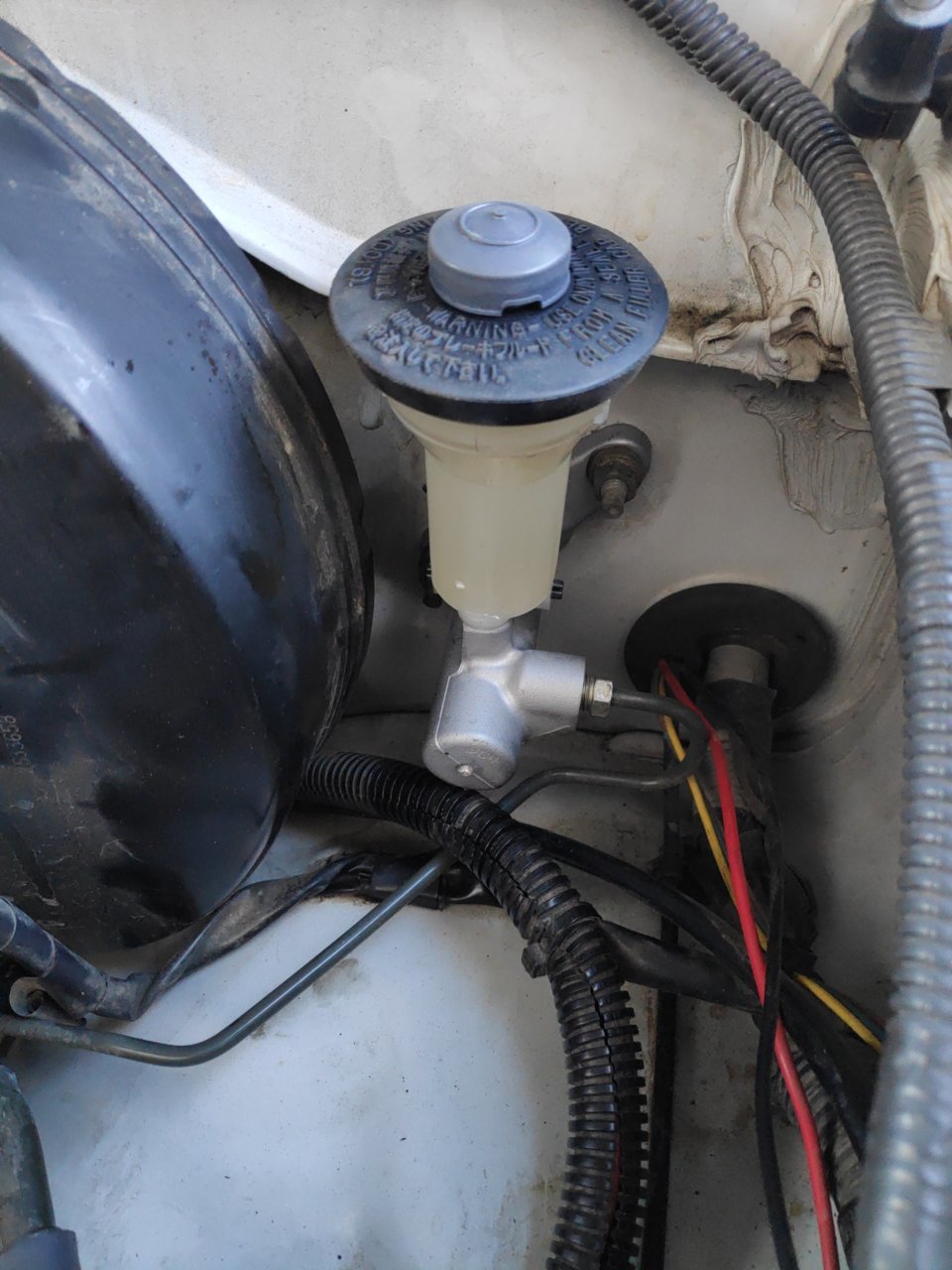

    The red and yellow wires are for an LED light bar and for the switch for the painless solenoid. The wire loom thing I cannot remember off the top of my head.

    I'll take a look tomorrow and neaten things up. Thanks for pointing that out.

    Was thinking it was a power run to the bed of the truck.

    You too! I’ve gotta get a spare made up and attached somehow before it bites me lol
