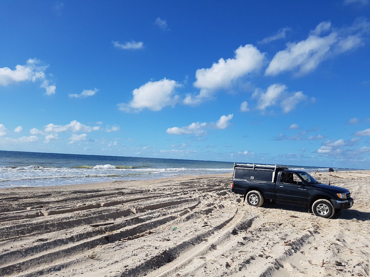

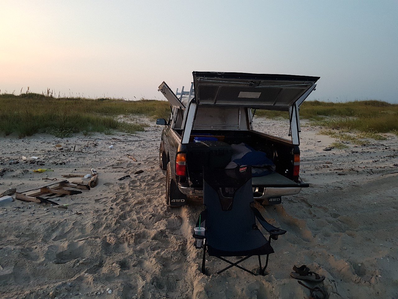

    Wasn't really just today. That would have been silly.
    But-
    - procured a used ARE DCU from Ranger.
    - stripped its paint ( Citristrip)
    - painted it (Rust-Oleum aluminum primer, then satin Black)
    - installed it (6 bolts)
    - slept in it (sort of)
    It's not the prettiest thing on the planet, but the functionality is unbeatable for me. The fact that it's aluminum means it's super light and modifiable, the side opening panels give great acess to the bed, and its tall enough to sit up in comfortably. I can use the roof rack for project materials, sports equipment, Christmas lights, you name it.
    Future plans:. Get less bad with an hvlp gun, paint the other white parts.
    Decorate it with a kayak
    Paint or maybe plastidip the roof rack
    Add windows?
    Add ventilation?
    Disco ball
    Speakers?
    Interior lights

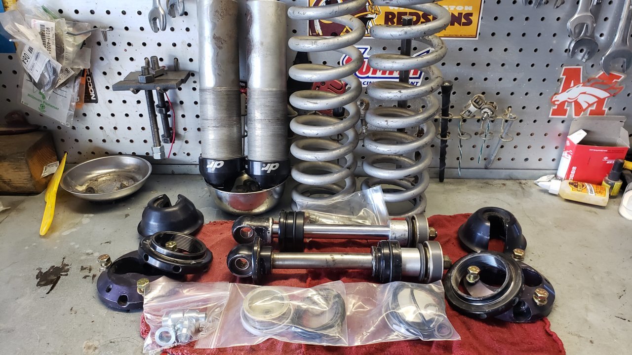

    If have thought of it but never looked into it. I honestly think the needle port is better at holding pressure over time vs schrader valve. Where as i see the schrader valve leak pressure more often. Might be very difficult to find too.

    Yep order from schmidty racing. Just be gentle the needles do bend or break . But you can do about a good amount of fills on one same port.

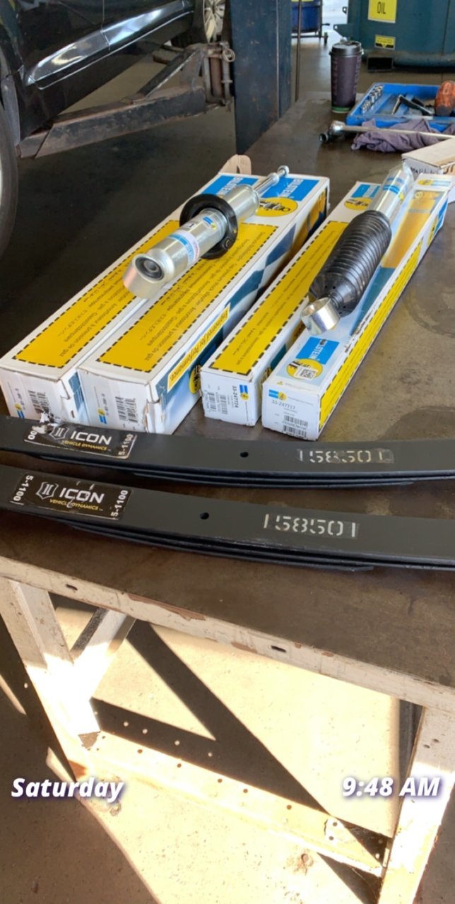

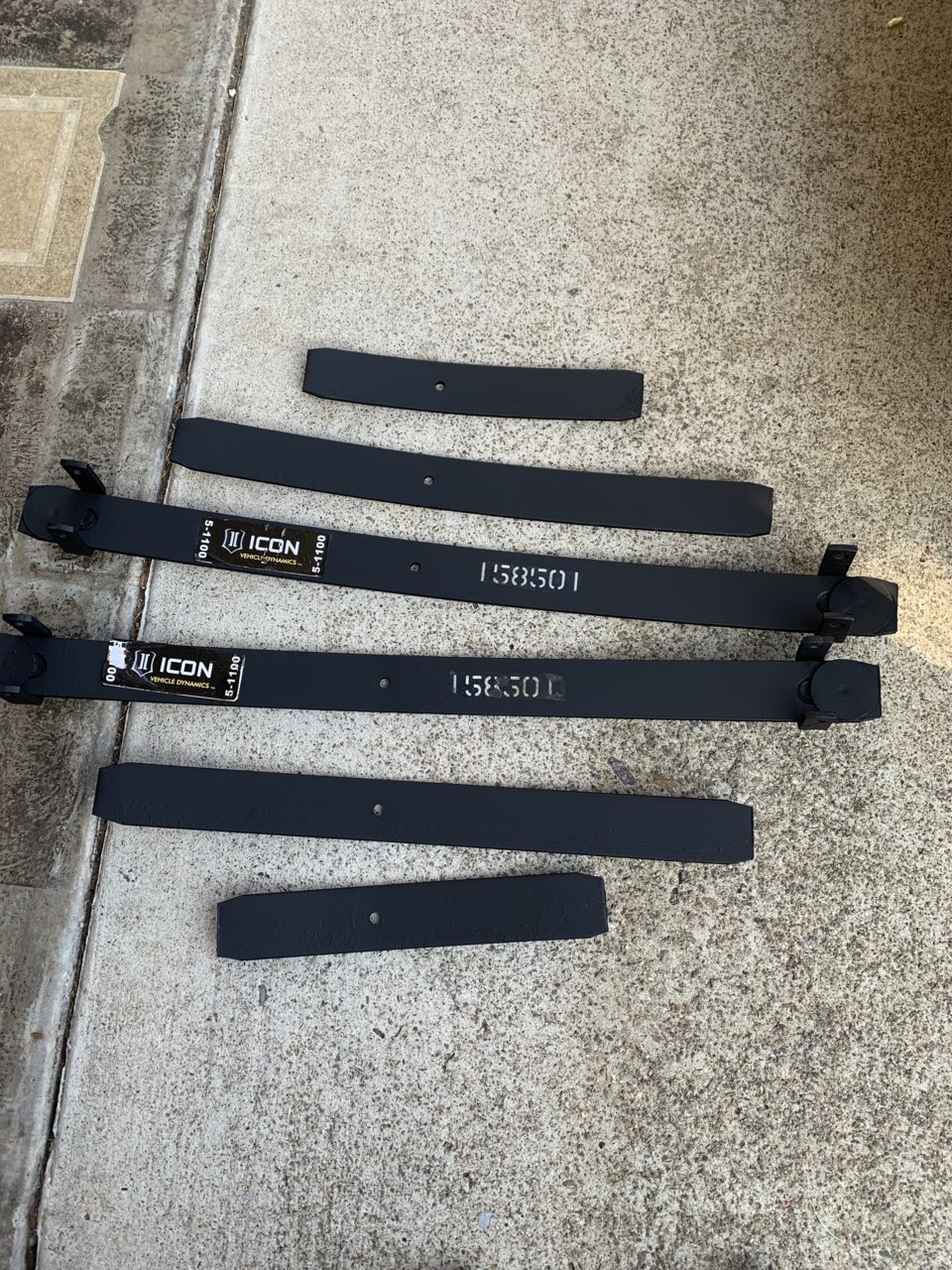

    Finally lifted the taco
    Put bilstein 5100s on all for corners with an icon 3 leaf pack. I set the front billies to 2.5 with the stock coils and it rides so much better:burnrubber:
    Bought the icon leaf pack for 80 bucks on offer up!!
