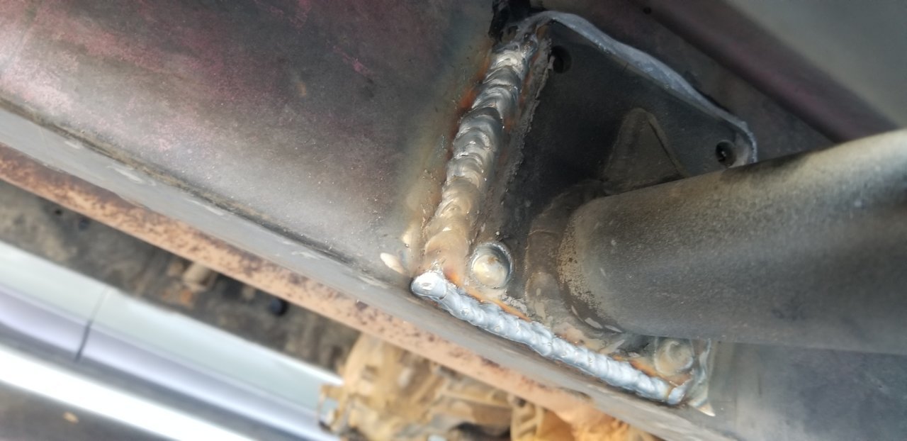

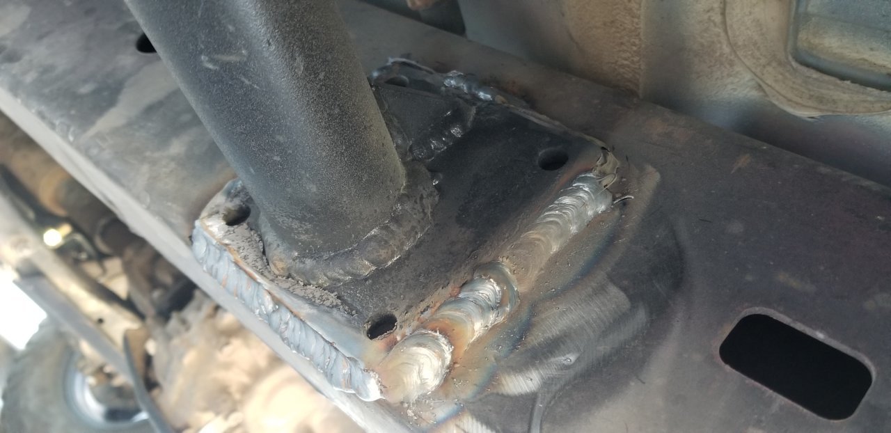

    They get the job done though! Solid welds in my book.

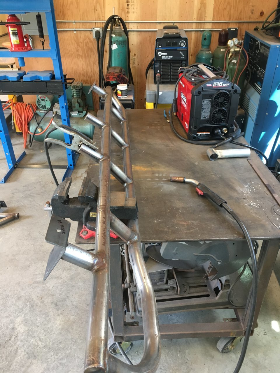

    btw, what did you spray your sliders with and what do you use to touch them up?

    You're sellin yourself short man... Those welds look fine. Especially for being crunched up under the truck with sparks falling on you and burning through your clothes lol.
    My mounts are basically the same as what you did, except we plug welded all the bolt holes on the bases.
    Edit... looks like you plug welded yours too (was looking at the bottom pic, must have been before you plugged them)

    I sprayed the main part of my sliders with Duplicolor Acrylic Enamel over self etching primer... Did my bumpers with it too. Seems to be holding up well.
    I sprayed the bases and plates of my sliders (and the frame) with Duplicolor rocker panel coating... also seems to be doing well so far.

    I sprayed on the duplicolor bedliner after two coats of auto primer and it chipped off in a few areas from just my jackstant supporting them when welding them on. Not impressed.
    Just another maintenance item to add to the list I guess. I knew it was gonna come off from sliding on rocks, but not that easily :notsure:. maybe I should have put more final coats on.
    Thanks for the compliment. Always room for improvement though. Might have had better results with 0.35 wire instead of 0.30, but i'm content with how they came out.
    I only plug welded a few of them because I wasn't really sure if I was able to get it hot enough to melt to the frame side before filling it with material. Might go back through and plug weld them or just fill them with silicone to seal it up before I paint it.

    Right on!!! I was just wanting to see how the plates look, if they were flat or L shaped. I am about to install mine, i just finished welding on the mounting brackets which are L shaped from Trail Gear. I'm having issues lining them up so I am just gonna cut off the bottom L part and weld it up like yours. Thanks!

    Here’s the sliders I’m working on now. Hope to have them burned on real soon

    Gotcha. Those sliders look identical to the 4x ones! Are you gonna add gussets to the top part of the tube and plate?
    Also, is that a watercooled TIG I spy in the corner?
