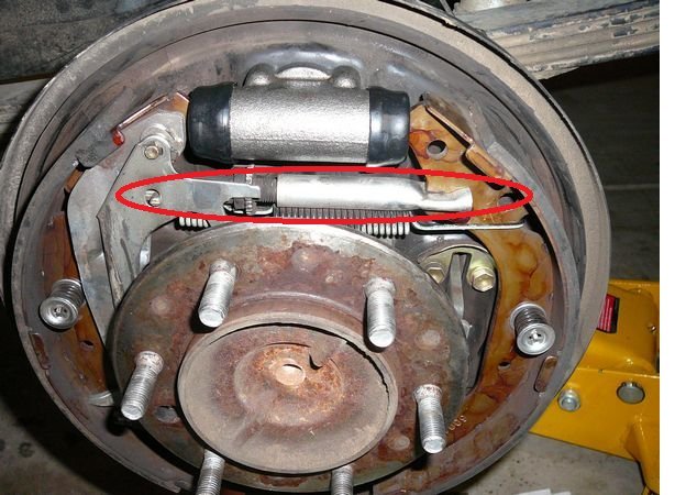

    Drums should drag a bit. Should only do one rotation after spinning it by hand.
    The fact your brake isn't working as much means the one that's not dragging much isn't being engaged. Adjust it tighter.

    that sentence hurt my head... sounds like maybe one drum is adjusted a little to tight and the other is loose if i read that right

    The little spinny gear in the top left half

    There’s a star wheel you can get to from the back. The long rubber plug at the top of the backing plate. To loosen the other side you’ll have to take the drum off to turn the star wheel the other way. It has a mechanism to prevent it from being loosened without holding the piece out of the way
    Goal is equal amount of very slight drag on both sides

    On the inside of the axle. On the back plate you'll see a small rubber rectangle. Pop it out. You'll see a toothed wheel and if you turn it as it wants to go that tighter. You'll need a screw driver to lift the lock tab to turn it the other way to loose it.

    I wouldn't do it with the drum off. Can't get the drum on if the pads are set right.

    I’ve never been able to get my hands to cooperate enough to get that damn tab.

    Just need a real long a skinny screw driver. Not too bad to do. Just needs lifted up.

    Depends on the ridge. I usually take em off. Run it in if it’s tight. Then throw it back on to adjust from the back

    The other option is they self adjusting. Pull the ebrake while rolling backwards slowly and it’s suppose to ratchet the mechanism to “self adjust”. Never tried it though

    Never worked for shit for me haha
