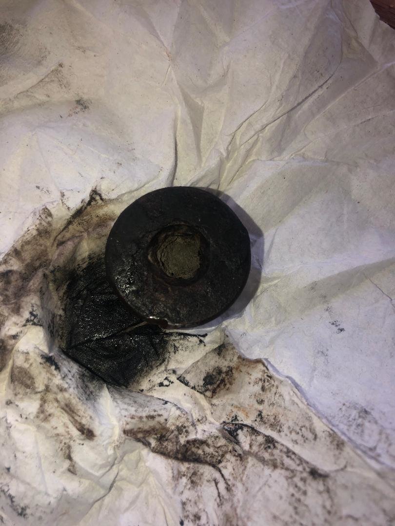

    I had a feeling there was supposed to be a washer there. I didn't see it in the schematic part of the FSM I was looking at but I was probably in the wrong section. I will find the part and order it, quick fix for me.

    I bought the 12 pack Diffs,Tranny and transfer washers on Amazon. Took a chance but they were correct. Some are alum. crush type some flat alum. 2 larger copper flat type. Easy to figure out which goes where because of size and 24mm vs 10mm allen plugs. When not used it leaks and may rust seat surface which need wire brush n emery cloth first.

    OH yeah Forgot to tell ya the transfer case drain and fill plugs are not interchangeable. Although they appear identical dont force the drain plug into the fill hole. Both plugs should thread in easily by hand when in the correct hole.

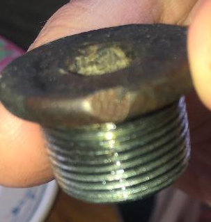

    dealer service fkd my plug over the years and only found this a number of years later
    not sure why the 3rd front diff service did not include a new one :notsure:
    had to get it chiseled last time to break free

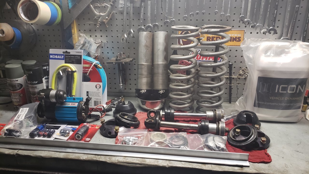

    Projects piling up. Taking over my work bench.

    Ouch. That would suck. It's bad enough when you mess it up yourself, but you would expect more from the dealer!

    Looks like that's where they chiseled it to get it to spin free, that's how I had to get my stripped plug off last time that happened. But yeah it should have been replaced if thats the case.

    oh i had a better pic of that plug too
    i cannot inspect this without taking the skid plate off can i?
